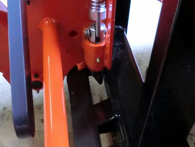

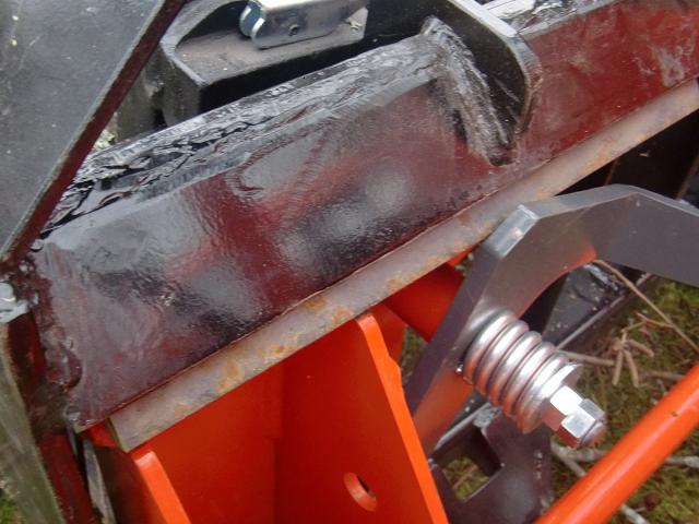

I bought a set of those forks and they fit very sloppy. I thought it was just an annoyance, but they actually fell off during use.
On the plus side, they were very eager to make it right, and gave me an allowance to make the fitment repair.
I have attached images of the gap I had.
I didn't like the suggestion to weld onto the bottom, so installed a 1/2" spacer at the top of the quick attach. (2nd picture taken during trial fit)
Fits just right now, the bevel of the locking pin makes contact halfway down the face.

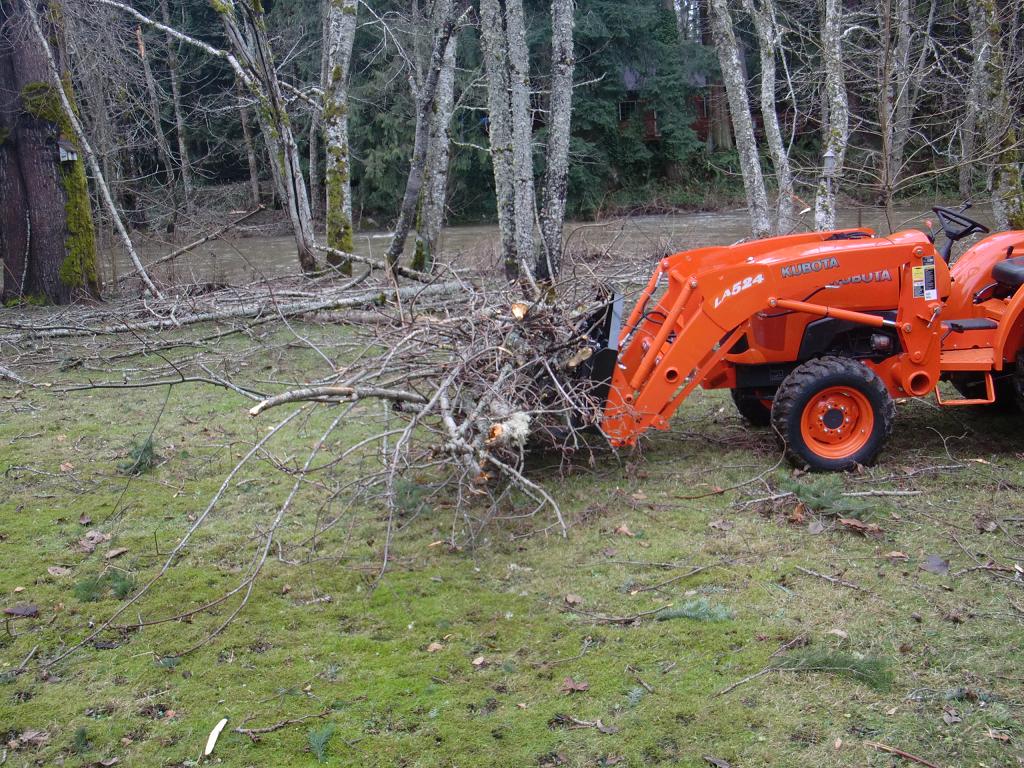

Oh yeah, now that I got them to fit, I'm really liking the quick attach feature. It is so easy to change from forks to bucket.
And the forks are incredibly useful. Don't know how I would have cleaned up after the ice storm without them.
