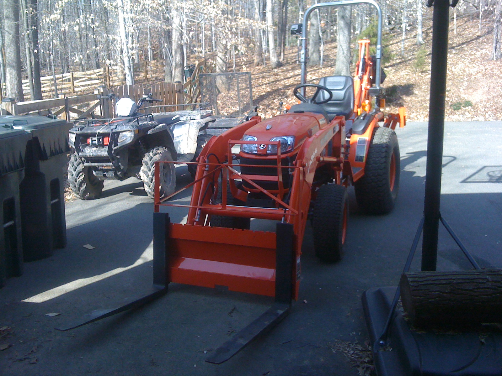

He is not getting ones that clip on the bucket. he is getting these
/ Kubota Q/A pallet fork weight #14
Considering the back-order I may get those exact ones in the picture.....what is the street address where your tractor is stored? :D
