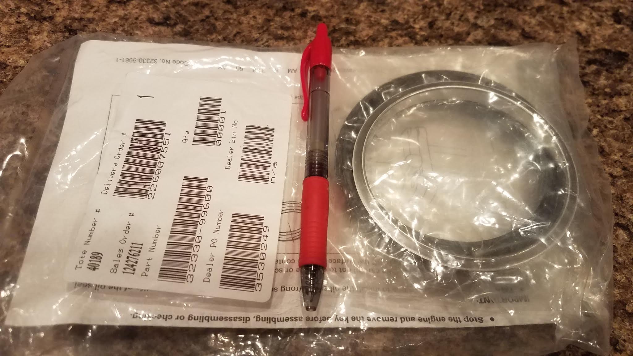

I知 replacing the big oil seal on top of the front axle case of my 1995 L2500DT. The instruction sheet with the seal says fits serial numbers ~ 61008. My serial number is - 54870.
So what the heck does ~ mean? I get > greater than | < less than. But what exactly does ~ mean?

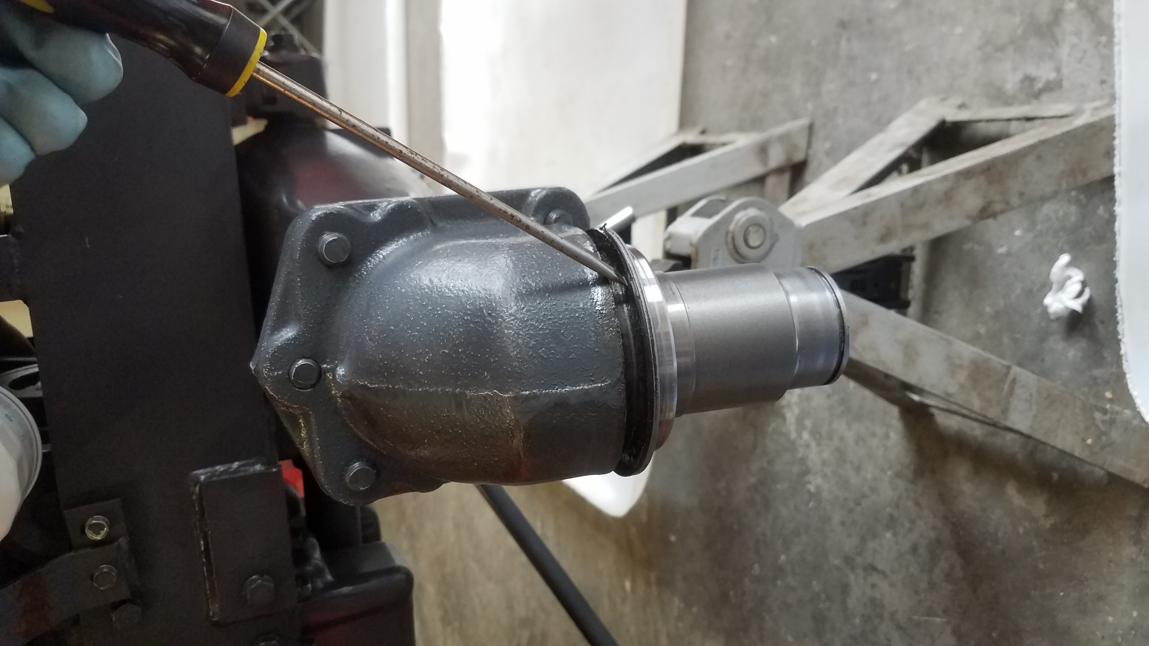

Yeah, hmmm..... It’s a pretty good job to get at the seal and I hate to make a go at it only to find ~ means not happening this weekend. But there are no other valid part numbers for this thing. All older numbers have superseded to this apparently.
   / Kubota part # symbol meaning??
I'm going to go ahead and yank everything apart this weekend and hope ~ doesn't bite me in the rear! :eek:

It means they don't have precise build records for the part and to double check comparing old to new before installation

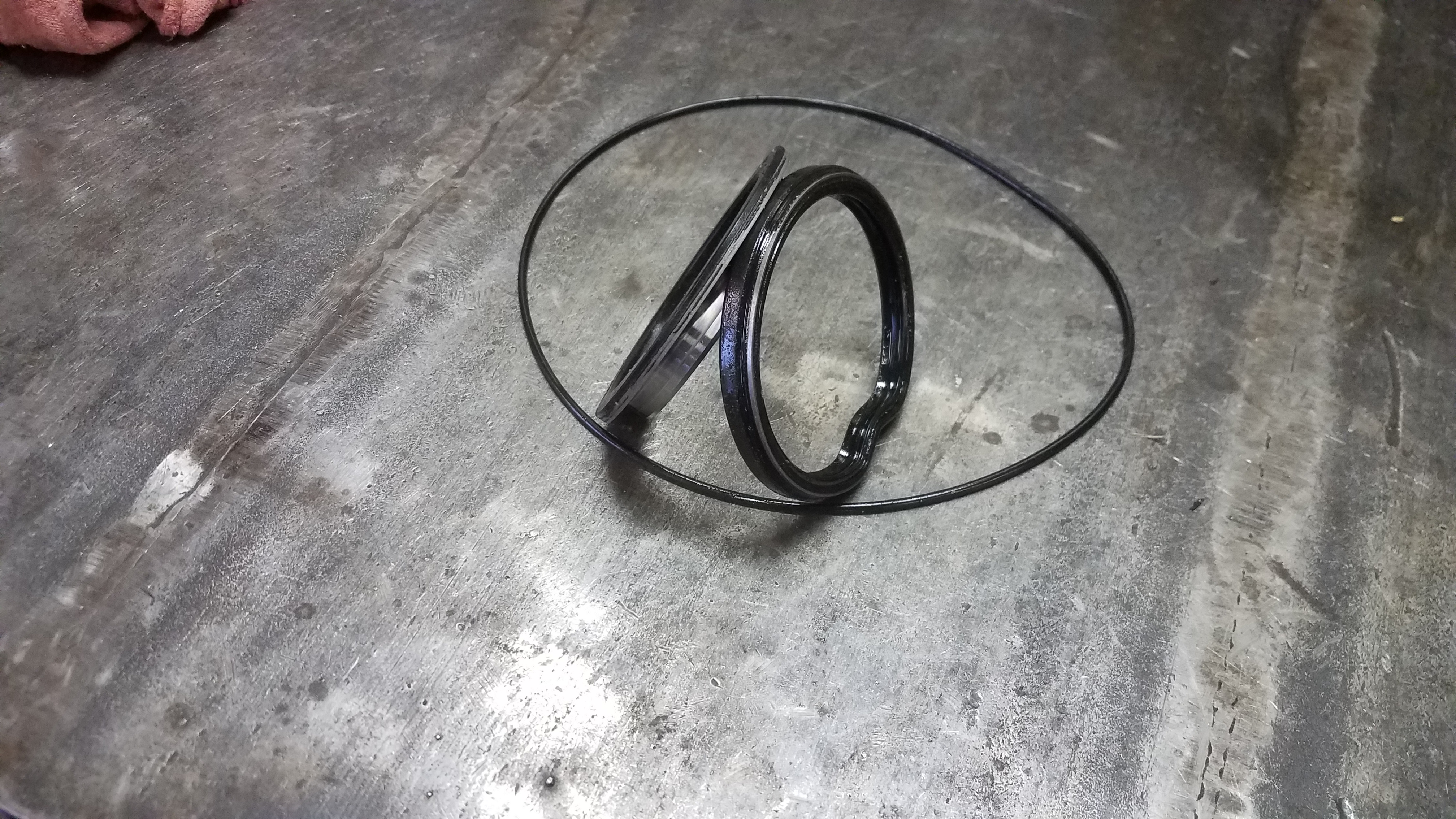

Well, it fit. New design so hopefully it'll last. Kind of a pain, but not that bad in the grand scheme of things.
