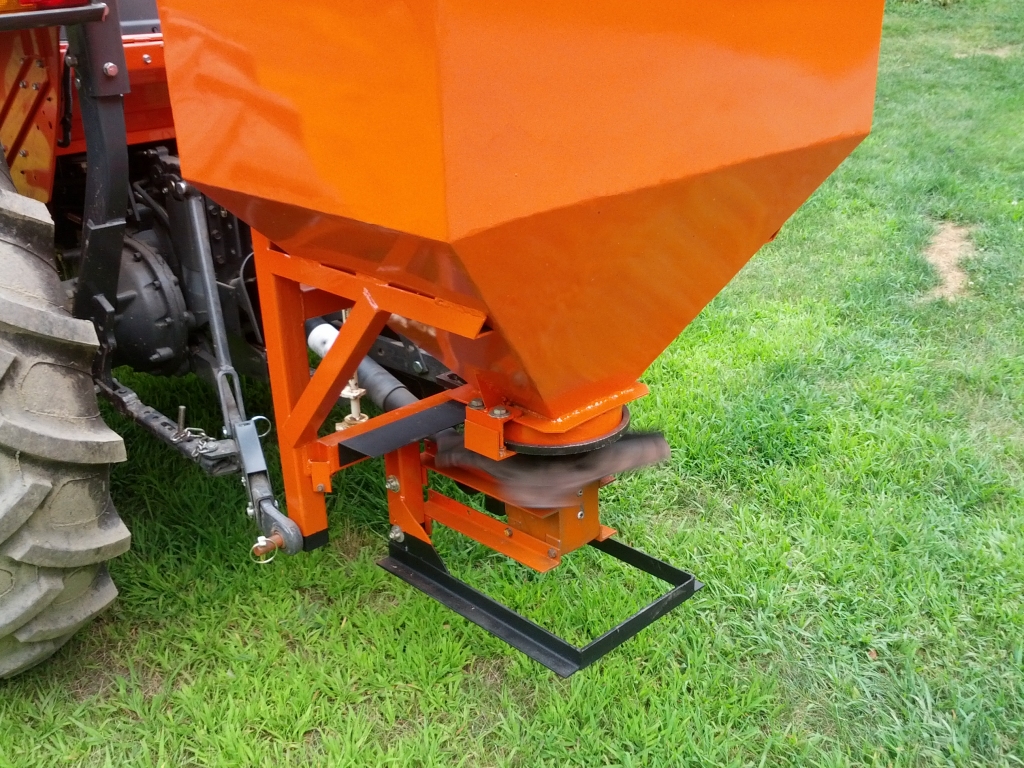

/ Kubota orange paint #35
So here's an update. I bought a quart of Kubota orange paint. The can has very little information about how to spray the paint. The dealer just said paint thinner. The local Sherwin Williams was even worse, they said just use water since it's acrylic enamel. I tried generic enamel thinner and that was a mistake. It didn't mix well and turned the orange a milky color. I found a part number chart on Kubota's web site and it gave a part number (I think) for thinner that the dealer never heard of. It also said Xylene would work in colder weather. I ended up wasting part of the can trying to find what to cut it with and then when I used Xylene I had to figure out how much. It looks like 3 to 4 parts paint to 1 part Xylene worked well for me.
Since I wasted some paint I ended up using a gravity fed gun that I haven't used in years. I used Rustoleum self etching auto primer and gave it a light scuff with 220 sand paper. It was about 80 out when I painted the seeder. The finish is much better than anything other than automotive paint, even a base/ clear wouldn't have done better. If you are looking for something more than a good enough paint job then I would recommend the Kubota paint. If you have experience painting automotive paints then you get a paint job that will rival your Kubota tractor, if not better since they are painted in mass production while doing one off work your attention to detail is finer. One quart would be enough to spray 3 coats to the top of a brush hog. It would have been enough to paint my Herd seeder had I not lost some learning.
Unfortunately I had to go thick with the second coat and it's still slightly thin in spots. Since it's going to be filled with sand for the driveway this winter I'm not going to paint it further. Also you have to get real close, a foot or so away, to see that it could use one more coat.

You wouldn't want the paint to dry any quicker. As it was the Xylene was dry to the touch moments after being applied, almost too fast. If I didn't have a paint gun I would get a HF special but the gun I have is actually a very good gun (Binks M1-G) and in the hands of a pro it's about the best you can get. Plus if I wanted to I can get different tips for it so I could shoot the Kubota paint without thinning it. I figure I'll start a thread in the snow section and add several pics there.
