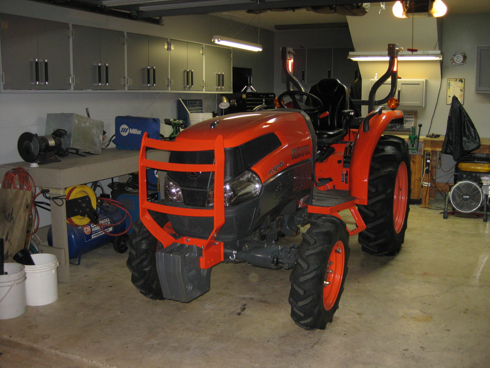

ok I am getting down to just a few more models/choices.
I am looking at the JD 3038e and the Kubota L3700su
both with loaders and both industrial tires.(both are hydro trans)
but I am also kinda twisted, thinking about the trans set up.
gear or hydro?
I could do a similar model from each w/ gear.
I see some advantages of the hydro set up, however I know the cost of repairs are much higher, not counting the 1200-1600 up front cost also.
any help would be awesome!
thanks
JT

jd is a turbo motor kubota is not. do you like the twin pedals or the rocker pedal for the hydro jd 2 speed hydro kubota 3 speed kubota quick detach loader jd quick detach bucket in nc I got a l3700su with rear remote cruise control r4 tires skid steer quick detach bucket for $21682 including 1103 insurance 214 filing fees and 1465 taxes with 0% for 72 which would be 18900. skid steer was $500 cruise $200 rear remote $600 r4 tires added $400 so if you take those away I got the tractor and loader for around 17200 Randy

Where did you get that notion? :confused: Go to the service departments and price out replacement gear and HST units from each company. They are nearly identical. Labor costs are also essentially identical to R&R transmissions. Neither trans types are prone to failures. Now factor in that the gear trans will require several more clutches over it's life and your statement makes little sense to me. Don't forget that having a dealer replace a clutch & PP, is 1500-2000, one clutch and there goes your savings from getting a gear trans.
As to Deere vs Kubota-- what's your favorite color? Do like your tractors vine ripe or picked early? ;) They are both about the same in quality, reliability and features. My opinion is that Kubota is currently slightly better, but others have differing opinions. Some say dealer support is important, but these 2 brands need little from the dealer.

You're going to get an excellent tractor either way. Compared to what you're going to pay for them, any fuel savings from one or the other will be pennies... not enough to worry about. The HST pedal and brake arrangement is purely personal preference. I much prefer the Kubota setup... it's almost impossible to move in the wrong direction by mistake and the action becomes completely second nature with a little use... kind of like using an automatic after learning to drive on a stick shift. The 3 range transmission is definitely an advantage vs. 2 range. But don't over-analyze this too much... go with the one you like best, and please enjoy it safely!

I'm a Deere guy. But, a 3 range tranny would probably sway me to the Kubota. Worth way more than the pedal configuration differences. I don't know if it's true on this Deere, but on other models with only 2 ranges, there are plenty of complaints that low is too slow and high is too weak. Kinda like Goldylocks: the one in the middle is just right.
