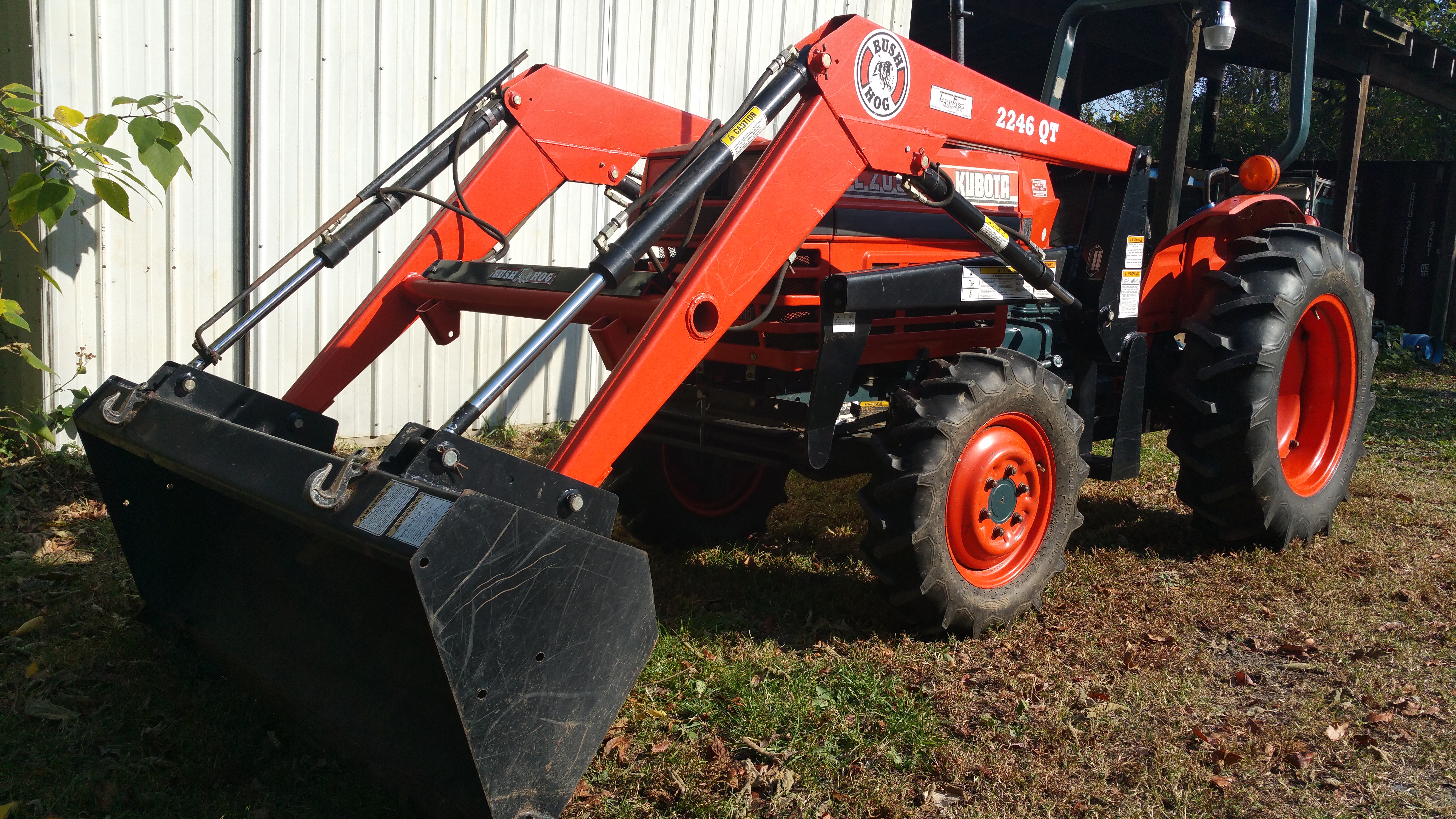

I had a Bush Hog brand 2246 quick attach loader that I added to my Kubota. It was a great loader that was trouble-free the 10 years I owned the tractor. I bought it from a local dealer and installed it myself which was fairly easy. They make several sizes to fit different HP tractors.
