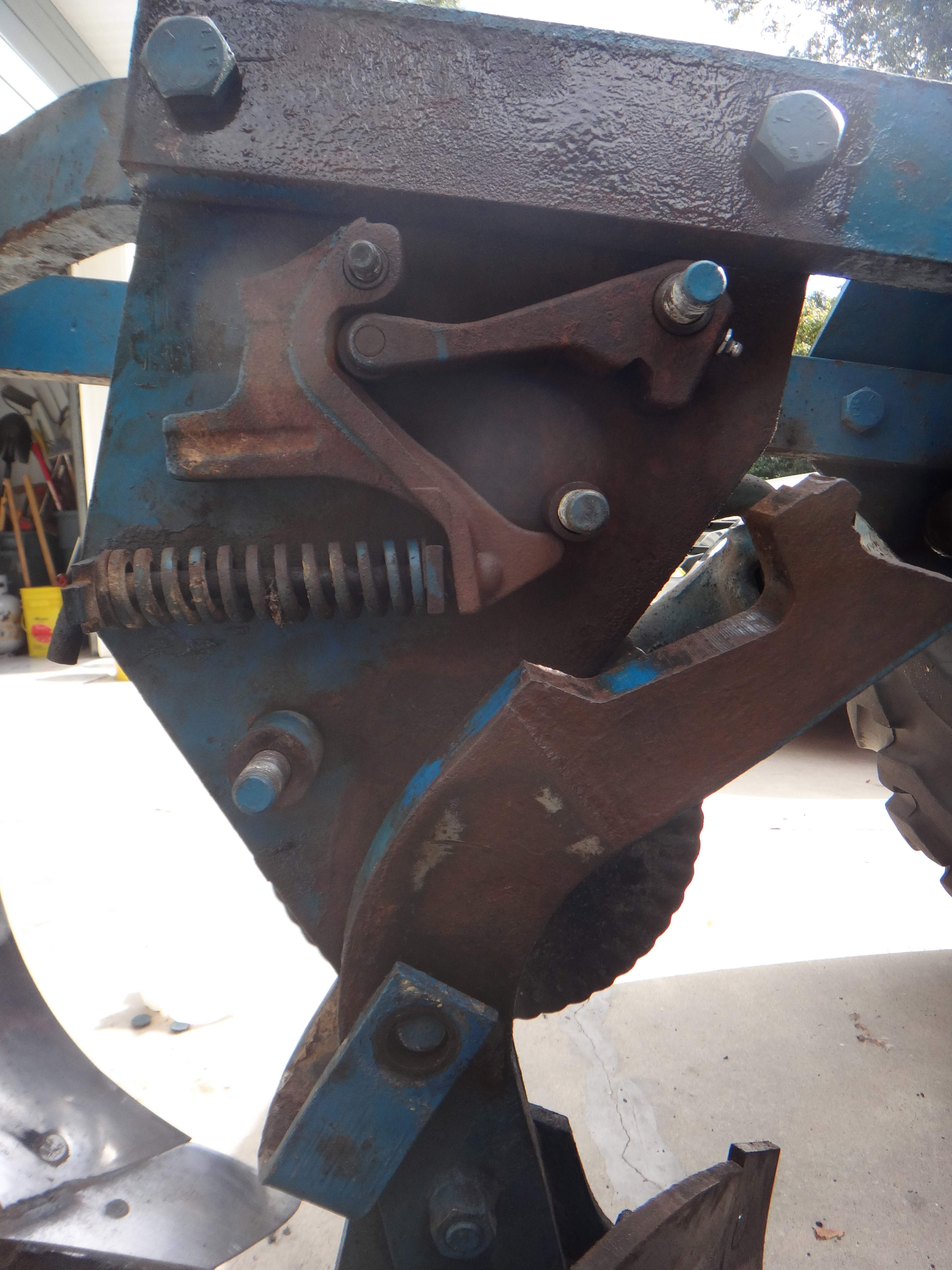

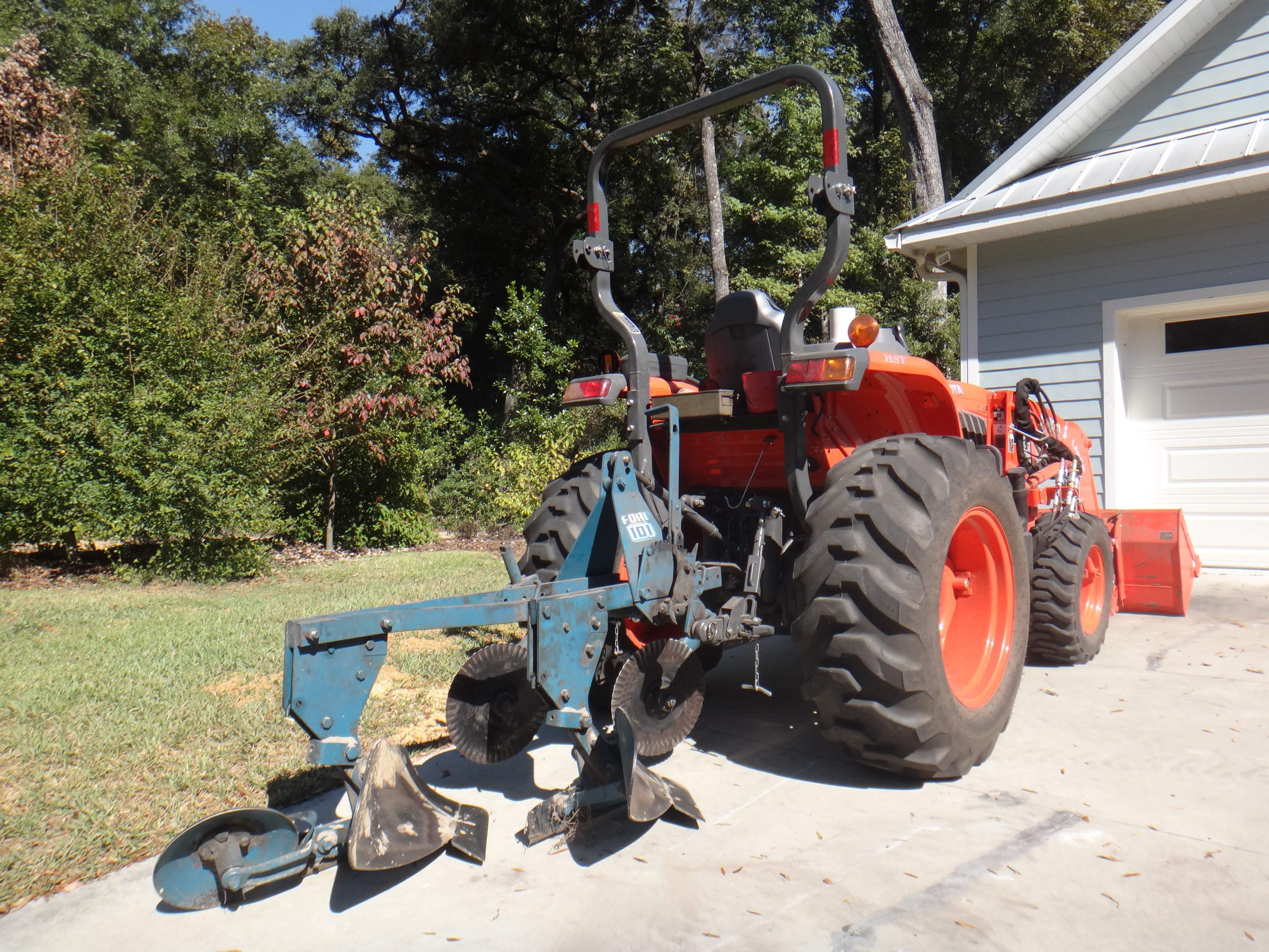

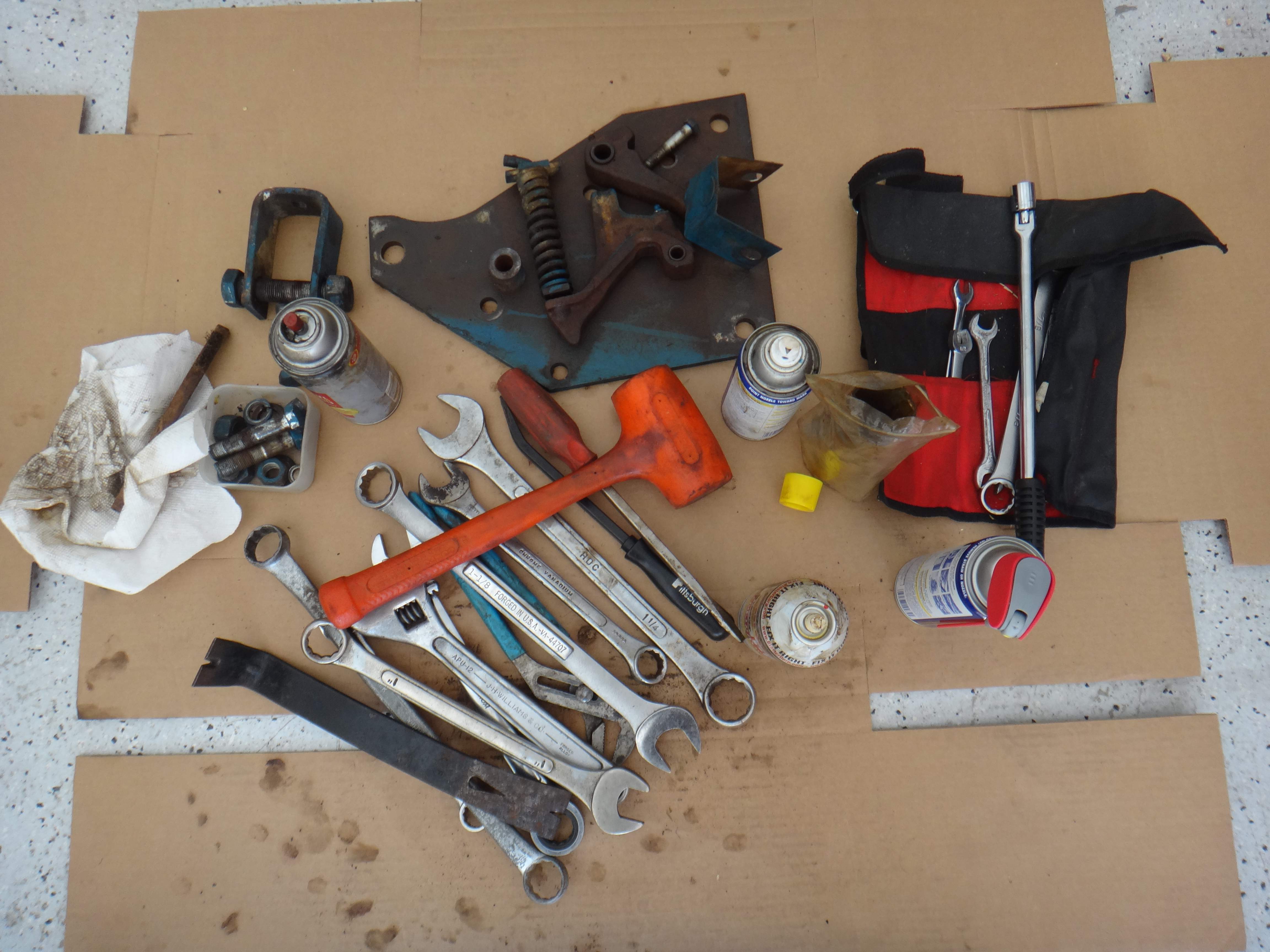

My plow is 3-Pt. mount. There are two types of plow protection against underground obstacles; shear bolt protection and (resettable) trip protection, which involves a trigger held by springs within the plow housing. Trip protection does require a little cleaning/lubrication every few years.
He may have been thinking of a pull type plow with trip hitch when you said trip plow. Back in the 50's we had a 2 bottom and 3 bottom plow we pulled behind our Farmall H and M. They had a spring loaded trip hitch that cut the entire plow loose if you hit a rock. Amazing time waster compared to an auto-reset bottomed plow. Our 7720 Deere and M135GX have electronic draft control but our ground is so uneven - mixture of soil types with differing resistance - so we end up using position control on both.

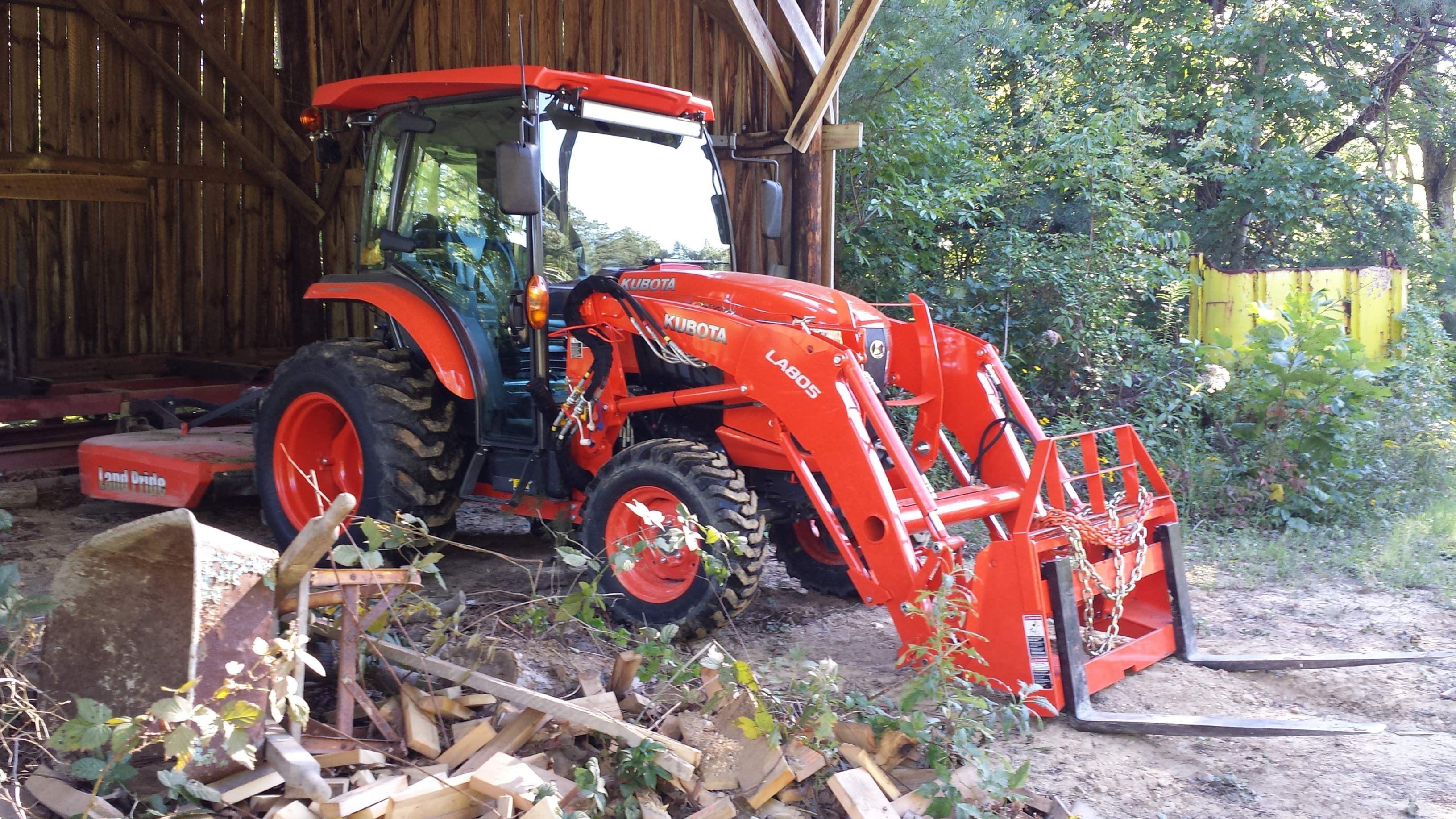

I started looking in Aug of 2019, and I finally purchased in March 2020 with a delivery in mid July of 2020. YES, in the middle of Covid.
After 7 months of use, half a summer, and most of a winter, 50, 100 and 200 hours services, I can share that my experience with this purchase has been a mixed bag.
Delivery July 17 2020 NEW
Kubota L3650HSTC Cab $52,500 (0% Interest - 84 months/$603 per month)
($1000 Buy down for 0% - $ 1,000 Cash
No KTAC Insurance ($5200) Purchased my own Inland Marine Insurance at $225/year ($1575 for 7 years)
Kubota 3rd Function Valve (Kubota Branded - not After market Land Pride)
805 Loader (Did not make sense to order with smaller loader 645?)
B92 Backhoe 9'2" (Did not make sense to order with smaller Backhoe 7')
LandPride SGC1072 Grapple (Dealer)
Spill Guard (hydraulic control - does interfere somewhat with Grapple/Fork use)
Defrost (all windows options)
Rear wiper
R4 Tires

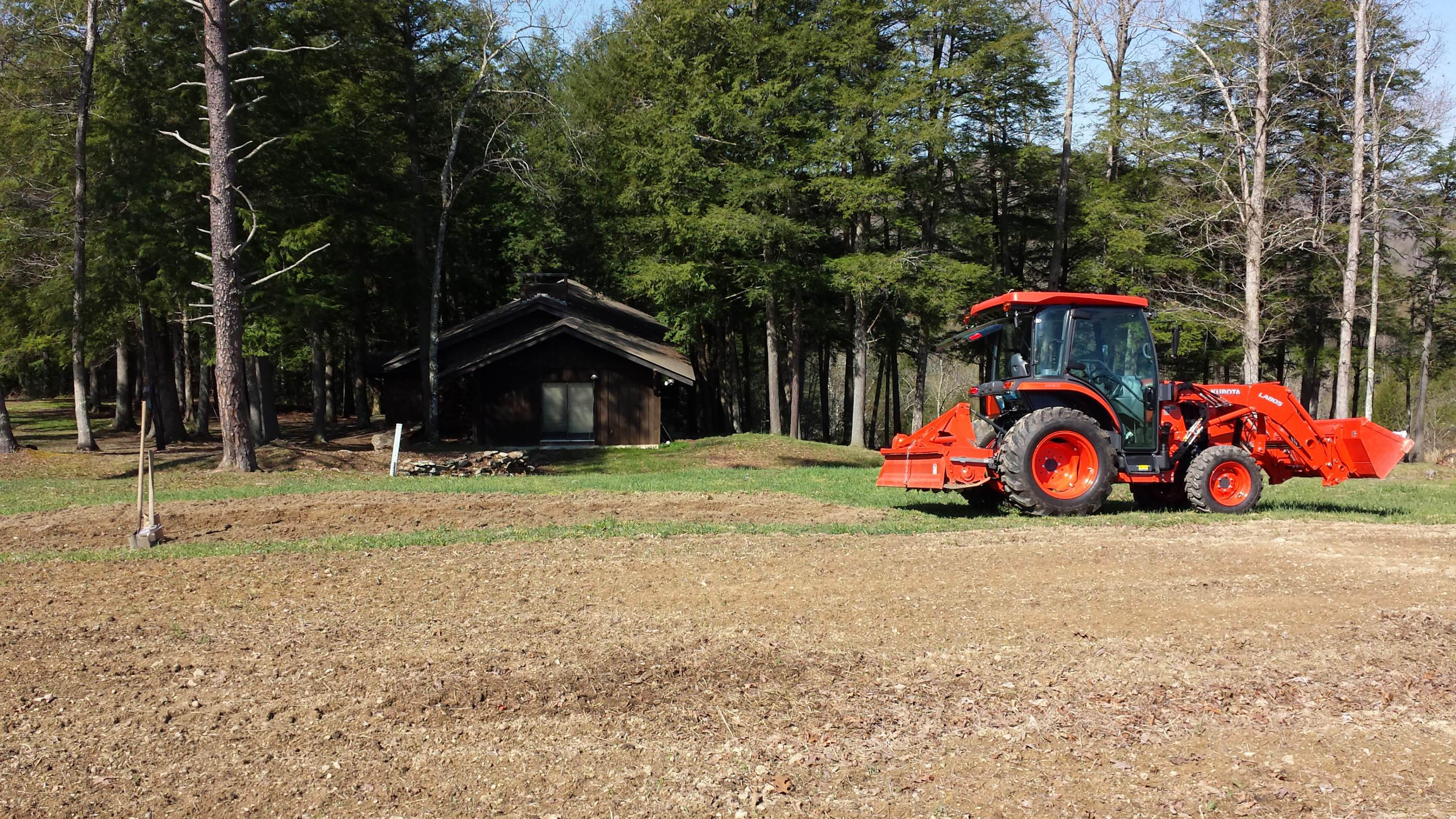

110 Hours - Grading and sloping, removal of old water tank (800 Gallon steel), Gravel install for driveway
100 yards Gravel

Operation
This has been a phenomenal product. I have few words to explain how the Grand L series has delivered one after another consistently positive results, and with the comfort and convenience that I am sure I would so sorely miss if I hadn't gotten the Grand L Cab version.
Total awe and amazement when I found and I pulled an 800 steel storage tank out of the ground with the bottom at 7 feet, without missing a beat. It dragged that tank up and out of the ground no problem! That tank had to be 9 to 10 feet long and 5 feet in diameter. This Kubota pulled it like it was nothing. Amazing that I could have been surprised by such a find, and actually just take care of it right then, no issue. Amazing.

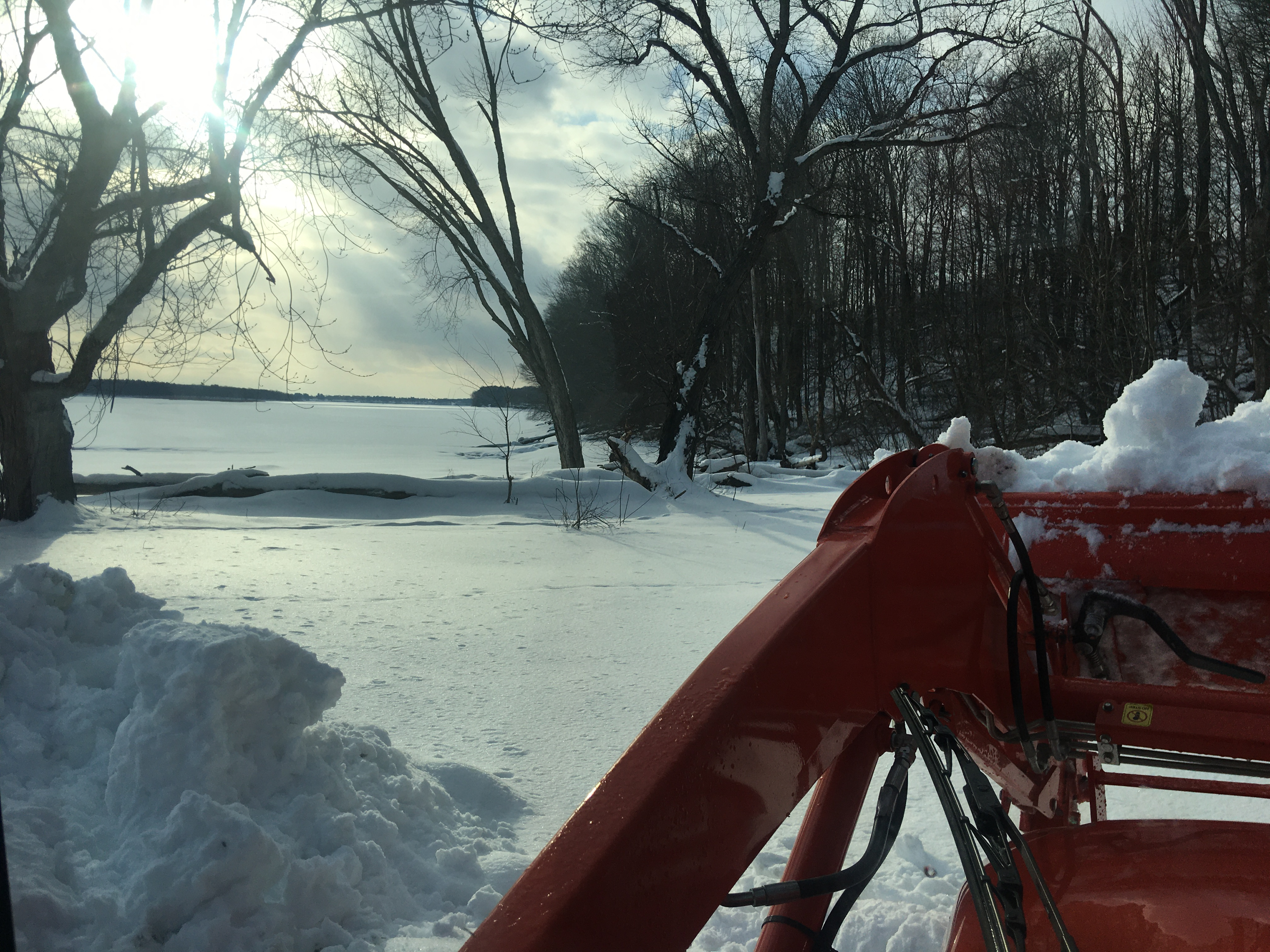

Or plowing and moving snow at 10 degrees. The comfort of this machine is crazy. I cant believe that I was thinking about and actually made a down payment on, an MX5400 open station - until I said... "Wait a minute, yes these are premium machines, but I do owe it to myself to just look and see what a cab model is all about even if it is $6,000 more..."
I sat in an open L3560 Limited Edition at the dealership while reviewing some paperwork, and within 10 minutes of sitting in that Grand L, I was at the sales desk letting the salesman know that we needed to go to the Grand L Model instead of the MX5400 Open Station.
My wife uses the Grand L because she can drive it like a car. Step on the gas and it goes. No Need to worry about clutch, RPM's or anything else... and it has a horn so she is happy!!!
Truly, this Grand L is every bit as functional and useful as buying a new Pickup for the same price... now, I just have to find a ride to work every day!!! He He He

Additionally I had the wheels mounted to give me a larger rear wheel base and can still move them out farther if I need to do so. I have relatively level ground.
