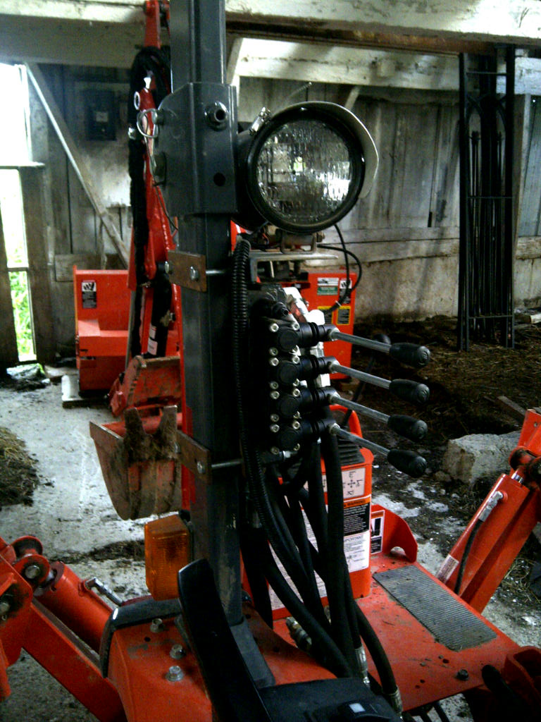

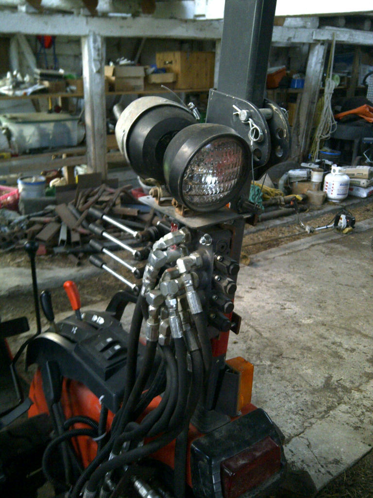

This is what I did for lights on my B3300SU
Tons of stuff in the Customizing section that would work for you. Doesn't matter the brand of tractor for these mods, any colour will still give you some more ideas

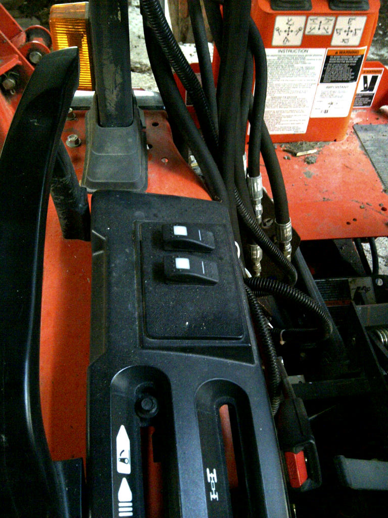

Nice work Farm Boy, the switches look factory. Nice placement.

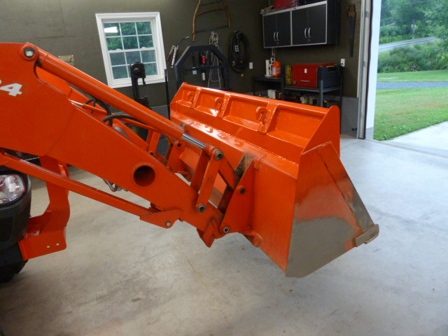

A spill guard is nice for the bucket,allows for a place to add hooks.This is what I did on my previous L3240.P1000234.JPGP1000247.JPG

A tooth bar provides a thick edge to strength the bucket, something you don't have with bolt on teeth. Of course, it depends on how you will be using it. I hit a lot of rock with my digging (skid steer) and ended up with a dedicated tooth bucket. Of course, everyone's needs are different.
View attachment 336099 View attachment 336100 View attachment 336101
I thought of mounting my lights low like yours, my concerns
I wear glasses, any glare/reflections with lights at eye level behind your head?
When turning to look rearward don't they shine in your eyes?
I see you have a little bit of shielding ,was that enough?
Thanks, that was the intention. Took some work to find the right ones.
I also wear glasses. The shielding was needed for two reasons.
When I first mounted the lights, I didn't have the shielding and couldn't even use the front light. It would reflect off my glasses while driving forward and obviously blind me when I turned to look backwards as I was looking straight into it. I knew I'd need the shield before I mounted them but needed them mounted to figure out the size of the shield. It's about 4" wide and covers from about the 10 o'clock position to the 4 o'clock position, held on with a stainless hose clamp. Another 1/2" of coverage would have been good but works well enough as is. I made it thru all last winter's snow removal with it like this. I'll probably play with it a bit when I get around to mounting the other pair of lights on the other ROPS post.
With the hyd valve also now mounted, I can raise the valve another 1.5 - 2" which I plan to do

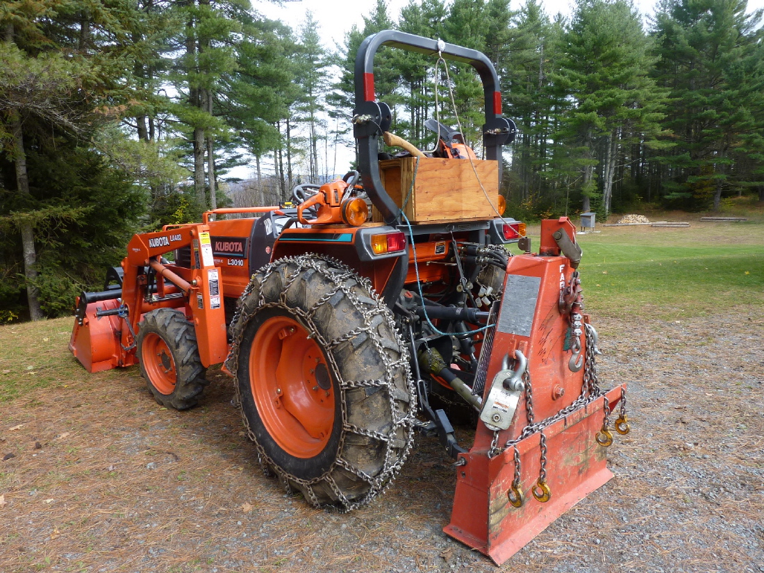

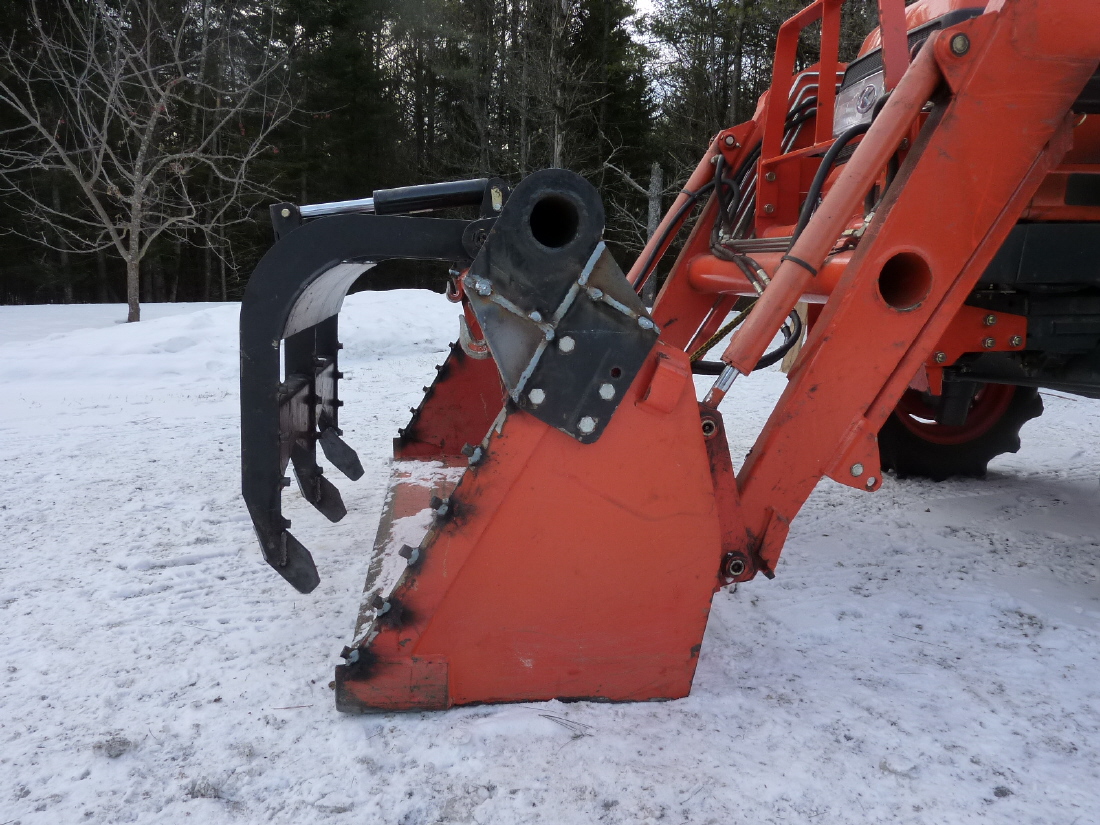

Your L2800 is similar to my L3010. The flat rear fenders make it easy to add a big (or small) tool box. I also added a grapple with the grapple control lever beside the loader lever.
Very nice, I like the extra teeth on the sides of the bucket. and the second lever looks factory. That tractor is ready for WW III
