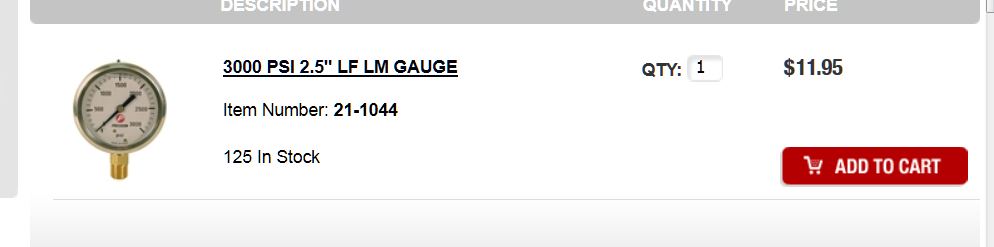

How long since hyd filters were changed? I suggest to get a 3000 psi gauge and plug in breakaway coupler on rear of tractor to check pressure. Surplus Center has a 3000# gauge.

Like Jim said, plug in a gage and check pressure with the lift lever at max height.
