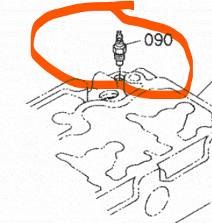

Coolant temp. sensor is located in engine cylinder head next to fuel injector opposite side of head from exhaust ports
So based on that pic is located on the right rear of the block near the firewall..???
   / Kubota M6800 Cab Tractor Temp Sending Unit #6
No offense intended you were close but no cigar due to engine block is below cylinder head. Coolant sensor is located at RH rear of engine cylinder head not engine block.

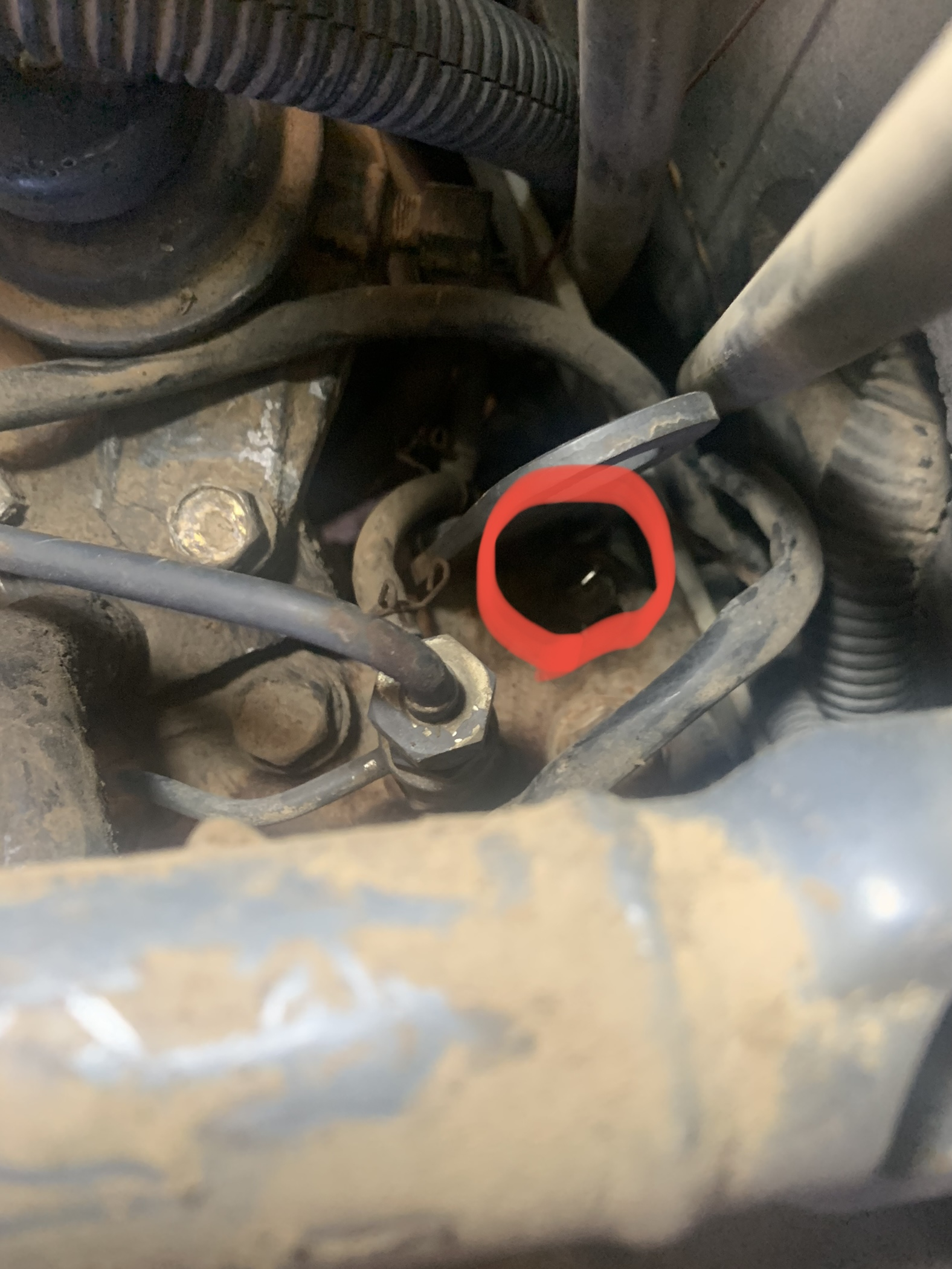

Temp sending unit was on the right rear of the block. I had to remove the hood, air intake and exhaust system to get access. Would have been nice had they put it near the front of the block where access would be much easier. Temp sending unit is circled to make it easier to ID in my pic.

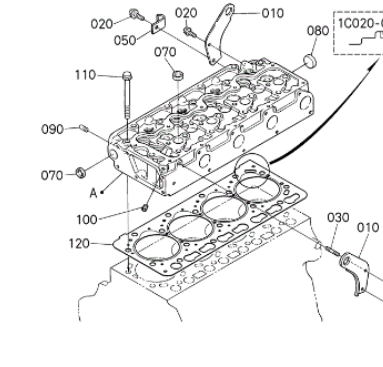

As I mentioned earlier on October 3(post #6) engine coolant sensor is located in rear of ""engine cylinder head"" not engine block!!!
Photo below is of cylinder head where coolant temp sensor is located with engine block below cyl head outlined with shaded lines.
Auto/tractor engineers normally don't repair their masterpieces so don't care if repair parts are easy or difficult to replace.
