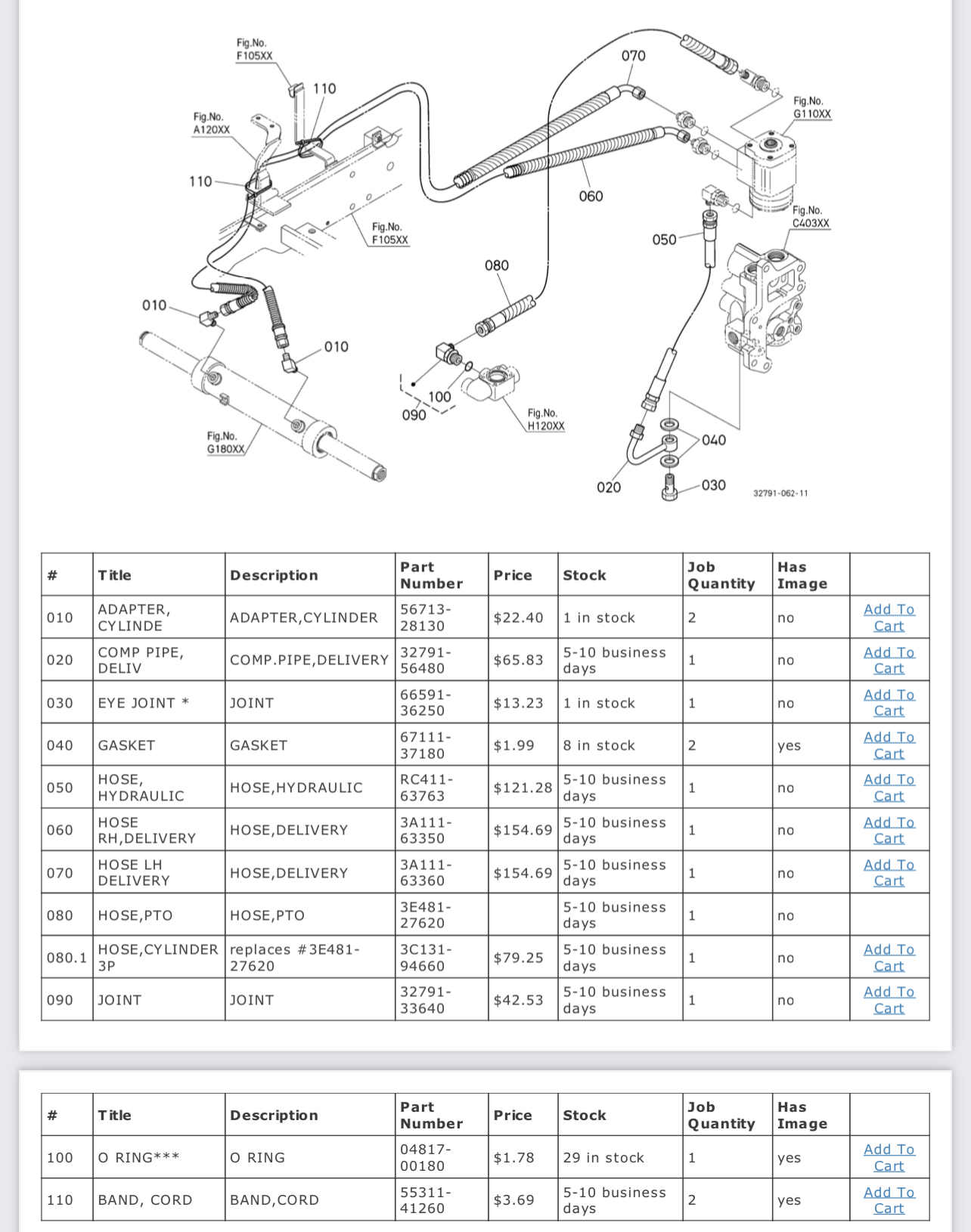

On edit here is the power steering system. You can see the 2 feed lines. I may be wrong about it’s own pump. The reason it sticks with me about having its own hydraulics is because I thought it was mentioned when my m59 lost both hydro pumps at 75hr. When I think back the steering was also effected it seems. The way it started for me me is loader got real weak. If it does not have its own pump then it’s tied to one of the 2 pumps. Check backhoe for strength. The swing is separate from all other functions, so try to move dirt sideways and dig to see if both circuits are strong. If they are and there is no separate pump it’s probably one of the components in diagram. Would help to put guage on lines that feed steering controller then guage on line going to cylinder. Like I said the steering on these are kinda weak to begin with for what they can carry

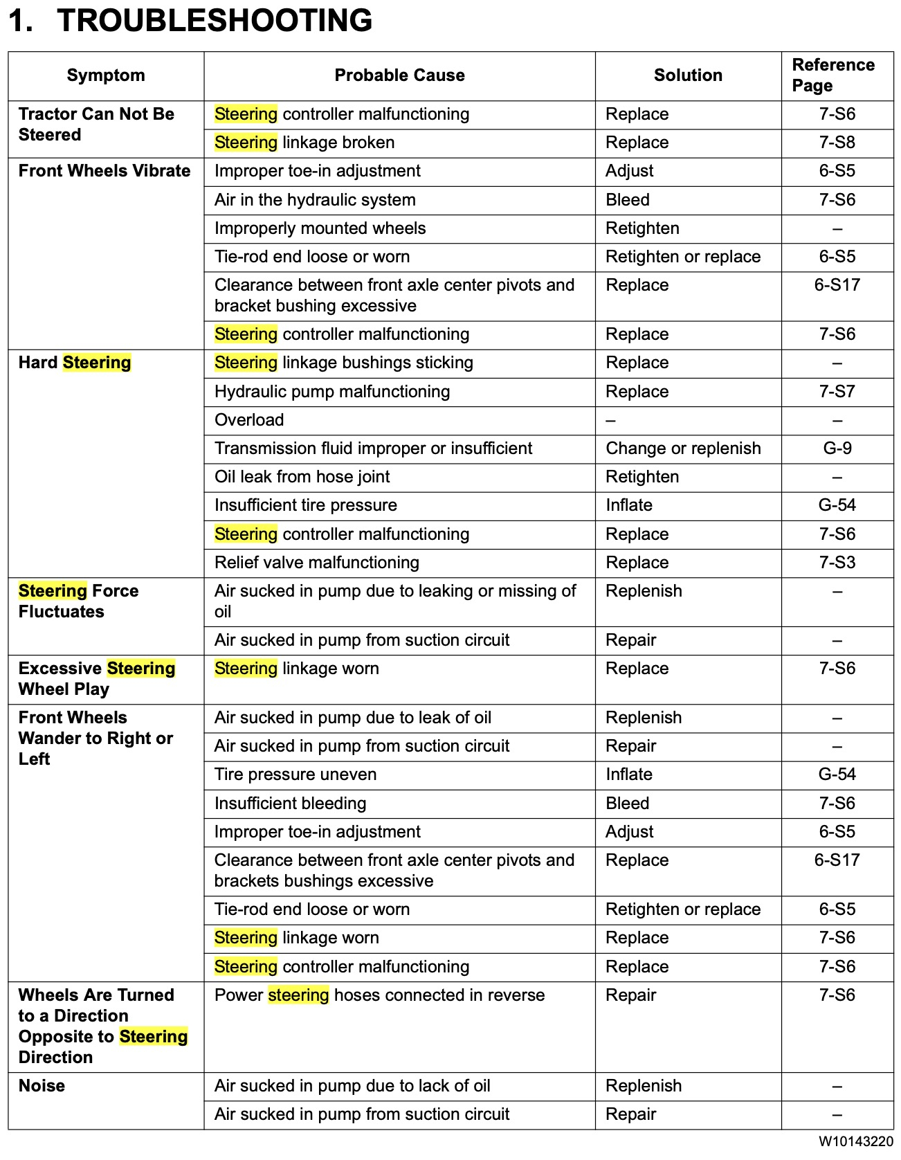

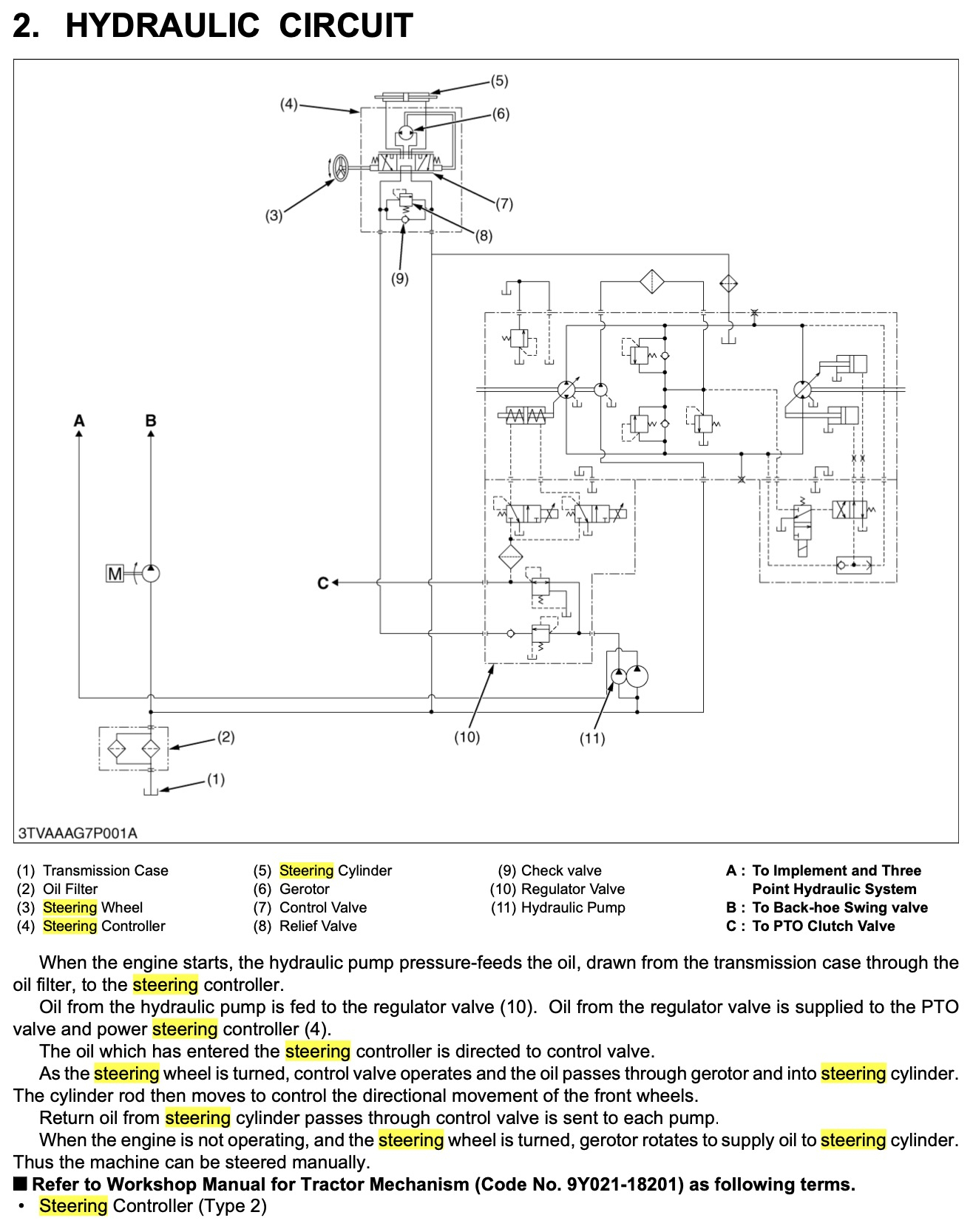

Some more detail for you

Thanks for that diagram and information. I believe you are right about that. I will get a gauge and some fittings and test pressure. I won't be able to flow test but hopefully pressure will tell me where the loss is.
