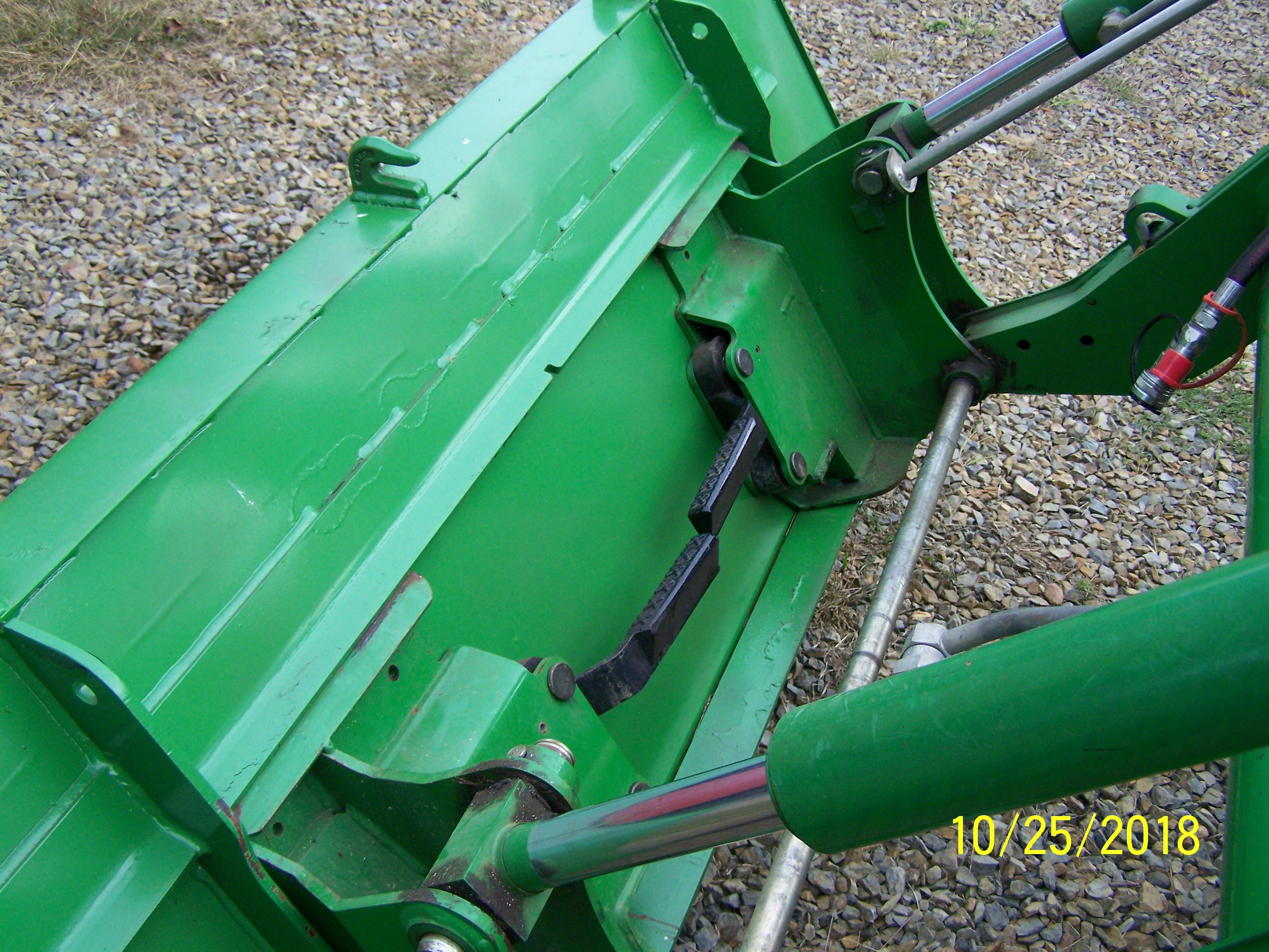

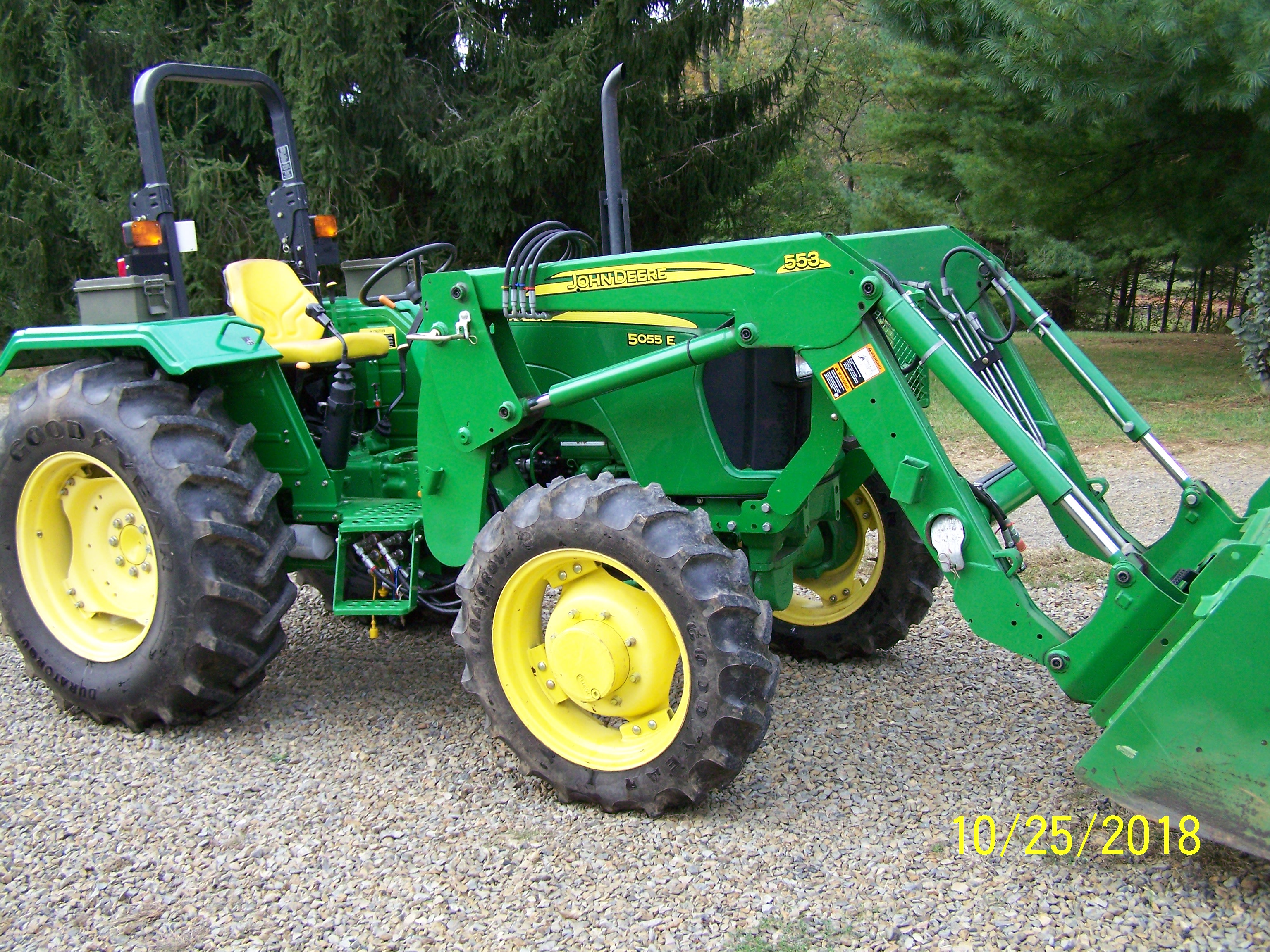

-Easy to find a root rake attachment (not a big deal but I have been looking quite a bit and for the Deere it looks like either I get a simple one and an SSQA adapter, make my own adapter or have to go to a more expensive grapple type which they do make with the Deere quick attach)
When I bought my 5055e, I was able to get it with a Deere quick attach, Global, or SSQA.
I got the SSQA.
