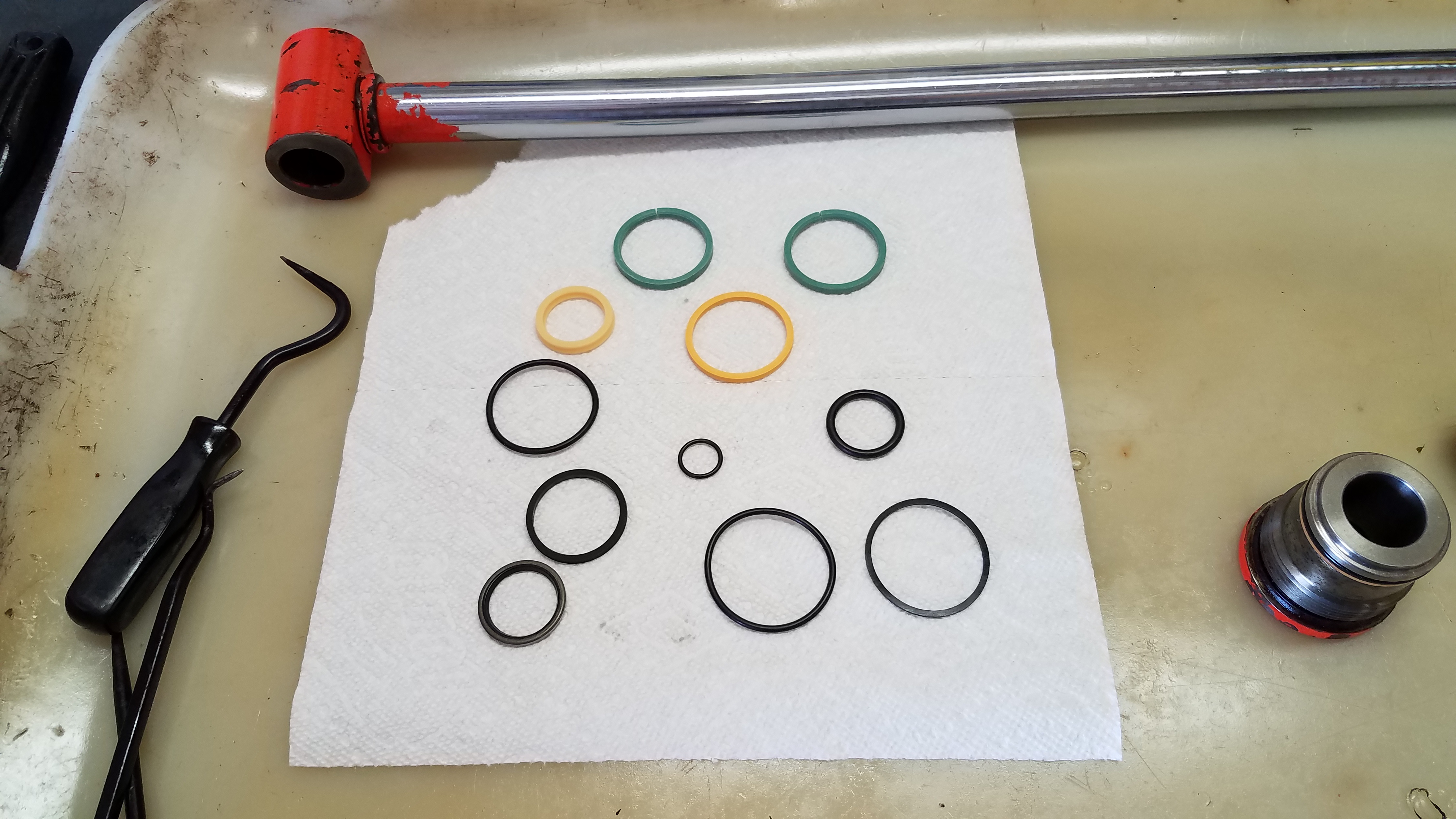

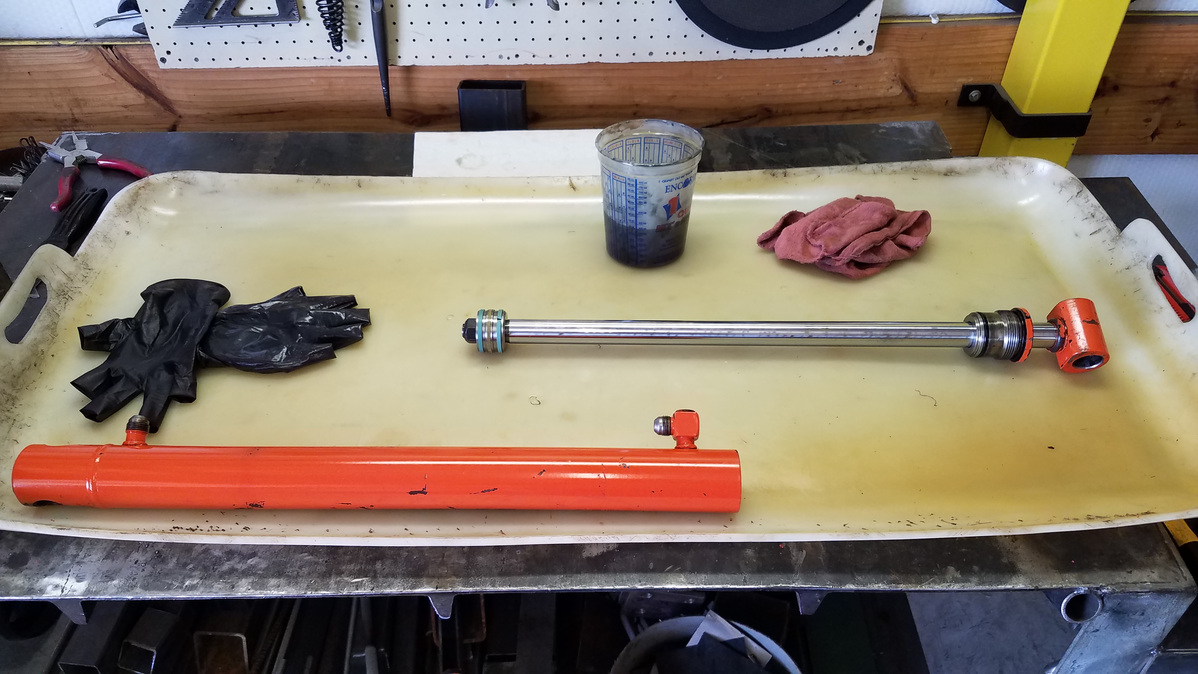

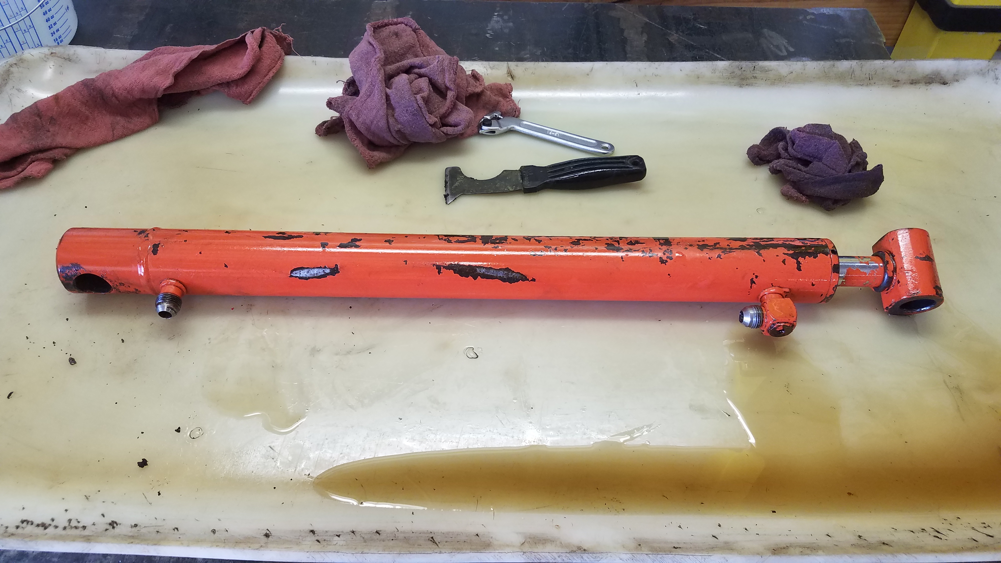

   / Kubota Loader Ram hydraulic cylinder leaking MX 5000 Loader LB 702, nervous,need help #6
   / Kubota Loader Ram hydraulic cylinder leaking MX 5000 Loader LB 702, nervous,need help #7
If you're mechanically inclined and can halfway pay attention to detail, it's not that complicated. Messy? You betcha. There are some tips and tricks - if you decide to make a go at it be sure to ask before you fubar something.
   / Kubota Loader Ram hydraulic cylinder leaking MX 5000 Loader LB 702, nervous,need help #8
   / Kubota Loader Ram hydraulic cylinder leaking MX 5000 Loader LB 702, nervous,need help #9

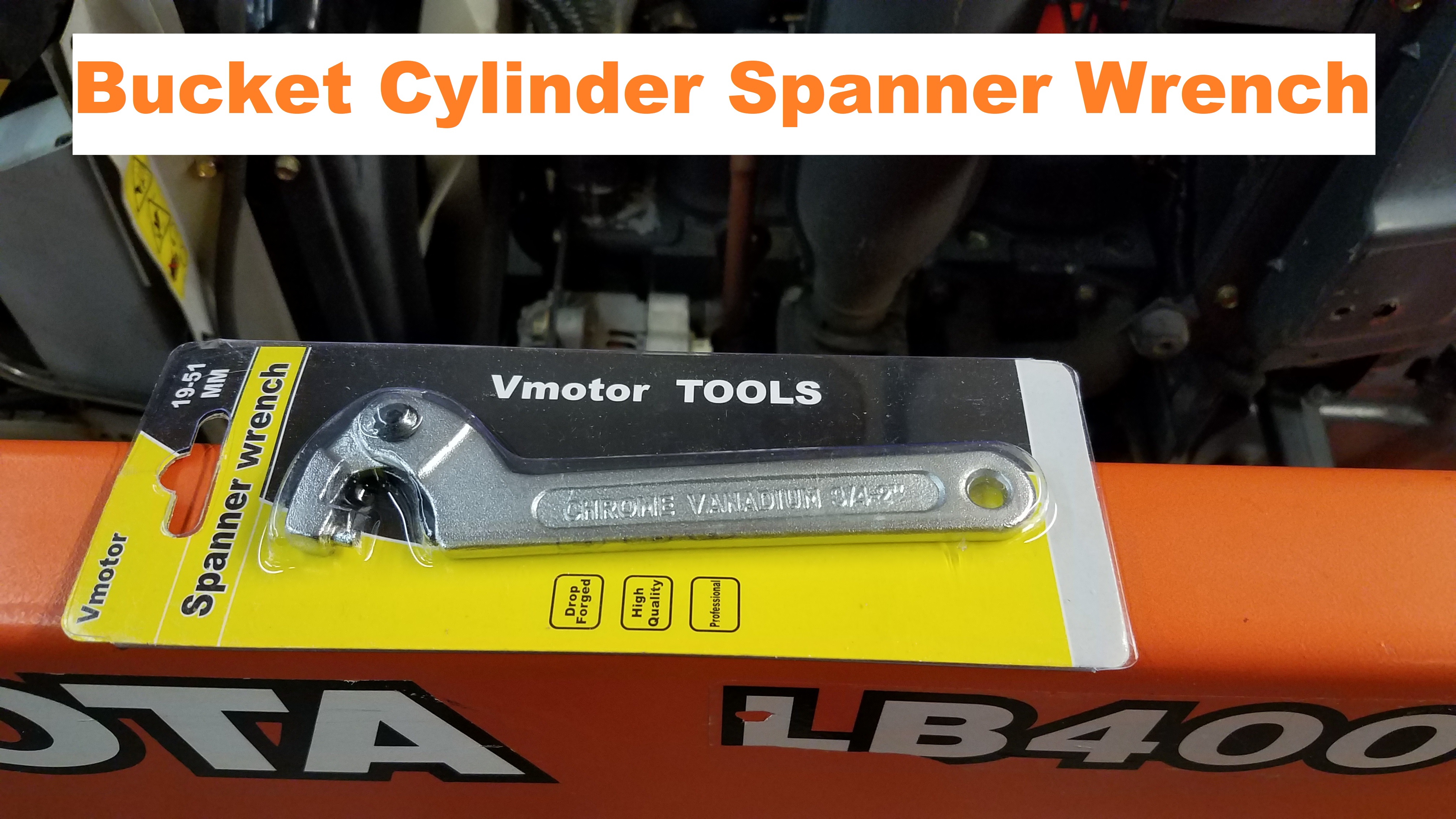

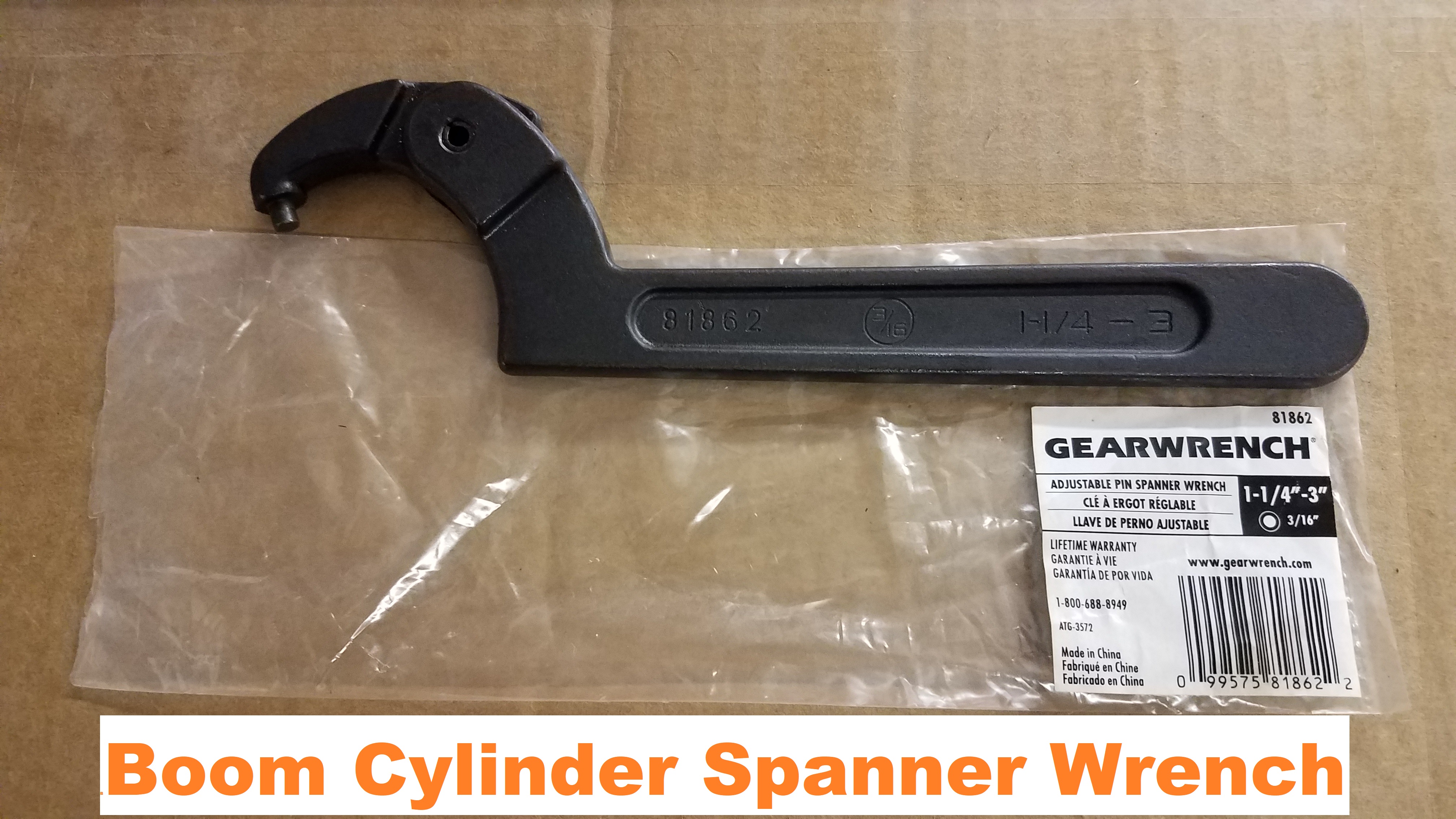

What nice photos. What tool did you use to undo the large end nut?
rScotty
Mine is an LB400, so sizes might be different than an LB702. The boom cylinders have slightly larger nuts than the bucket cylinders. I'm on OTT also, and started a thread but got side tracked. I broke the nuts loose before taking anything loose so I wasn't fighting them on the bench or floor. They popped right loose with some encouragement from a deadblow hammer. Here's the wrenches I used:
Hello, If I undo one of the two hoses to the bucket RAM hydraulic cylinder , with the bucket raised, can I remove only the inside part to the cylinder? How do I bled the lines after I have replaced all the packing kit rings. Raise and lower the bucket and then loosen each of the two connections? I will hear the air going out and then a flow of hydraulic fluid, then tighten quickly? I would like to get the tray you have in the photo. Did you get it from a dealer for this kind of repair? I have a Rubbermaid, black cement pan that is new that I could use, as you say this is a messy repair. I want to have my packing kit laid out like you have in your photo so I replace one ring and match it to the new one. Would it be easier to have the bucket up and remove only the inside rod? It would save bleeding the line to the other part to the cylinder? If I try to do this can I pull out the rod with the other part still connected? What is OTT? Is that another Internet help web site?
Thanks for the photos as I am getting everything in order in my head.
