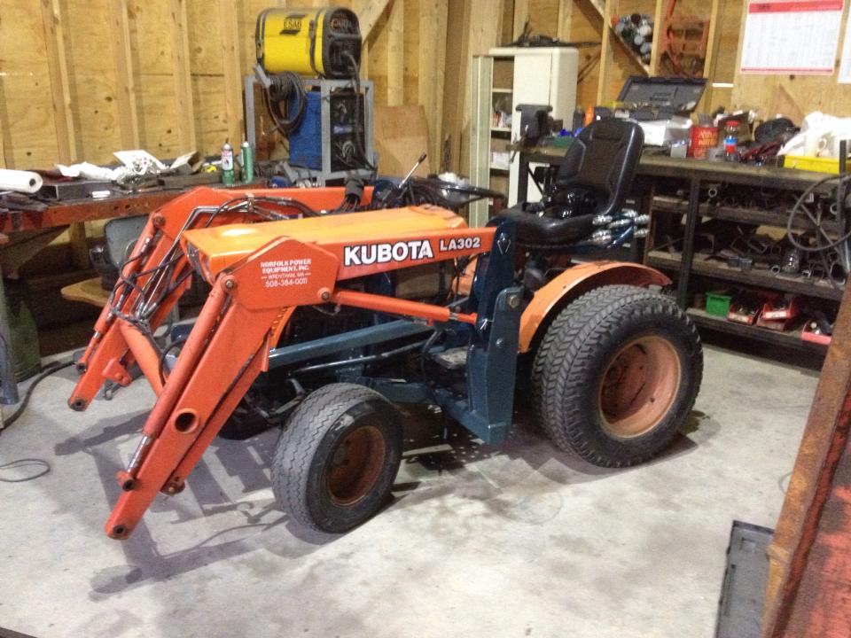

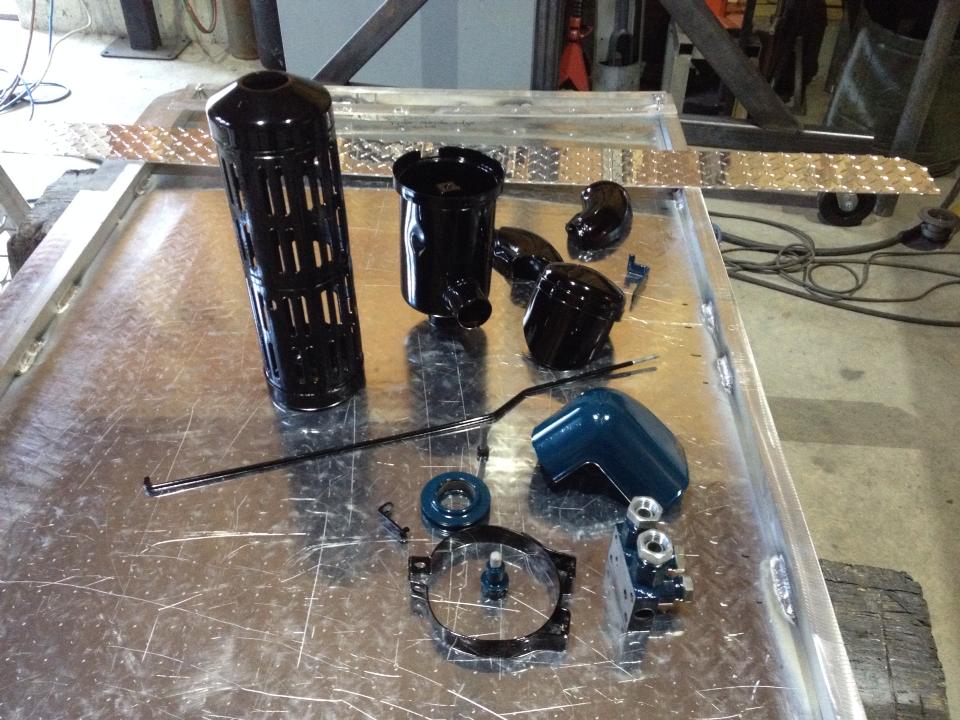

I finally dragged the loader arm assembly into the shop and mounted it up. I also have started working on the wiring. The machine now has a new ground and positive battery connection and I really just need to clean and re-wrap the wiring harness before installing it. There are only a few things left to do at this point. I need to weld a new piece of tubing to the end of the muffler, which will be replaced with a new one after holiday expenses, pick up a few more pieces of hardware, and connect the loader valve to the loader itself (last few fittings arrive on Tuesday). I have a day off on Wednesday, so I'm hoping to have everything complete on that day. After that, I just need to fill the beast with oil, cross my fingers, and turn her over. If that works out, I'll be on track with my goal of finishing before Thanksgiving, but just bareley. There is still some touch-up paint to do after that, and then onto the plow.

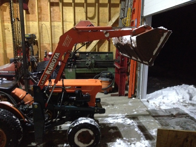

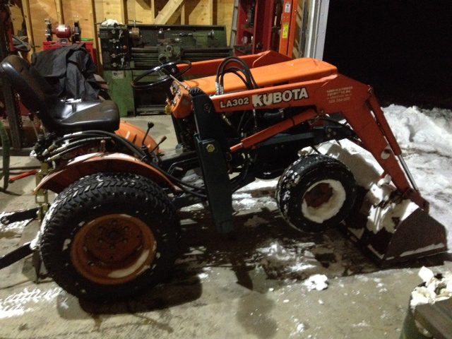

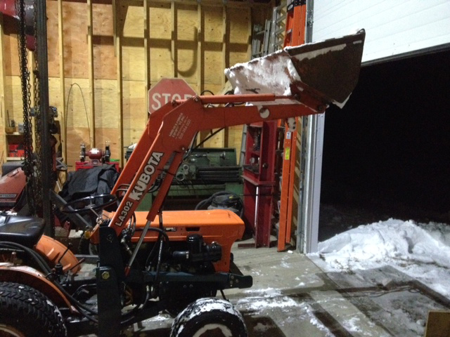

I have sorted the hydraulics for the loader due to the help of a tractorbynet user. I had the loader valve and rear auxiliary hydraulics valve in parallel instead of series, so it was a simple fix to get the that taken care of. Here's a link to that discussion: http://www.tractorbynet.com/forums/hydraulics/298593-kubota-b6100-slow-hydraulics.html
I just used the loader to clear some snow and it works great! It works quickly and picks up a full bucket of snow with no hesitation. I'm very pleased with how this is turning out! Next is to weld up the plow, but I'm still out about a week before having the laser cut plates for the new Silver Lake Fabrication snow plow design. However the bucket mounting bracket is about done. I'll post pictures once I have the plow built, but I'm excited about our new design.
