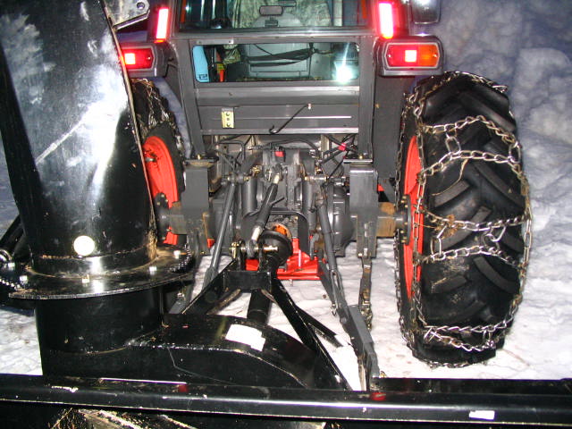

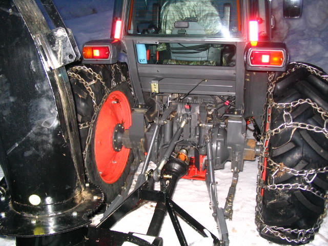

Mesa,
Mt tractor has the same dimensions as yours, and I run an 84 inch blower. It gives me about 5 inches of coverage to the outside of each rear set at the widest position. You do want that overlap otherwise you get a lot of windrows instead of clean passes. Here's a couple of photos showing the spread of the rears.

I've got a 5740 with R1 tires. They are 72" outer-tread-edge to outer-tread-edge. I run a 74" snow blower which works fine. I considered the 84" when I purchased but went for 74" because of unevenness of my terrain. 84" should work just fine.
