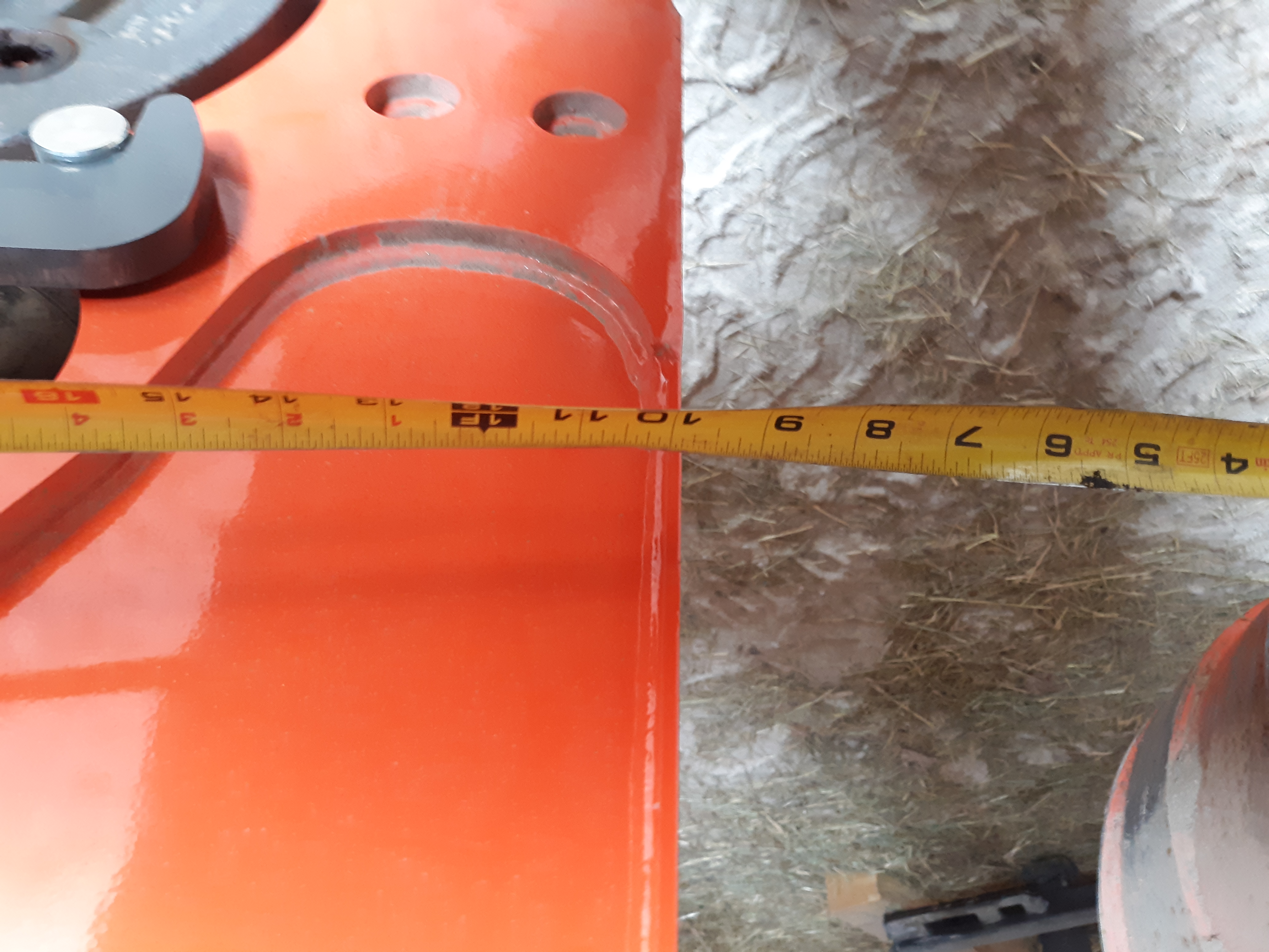

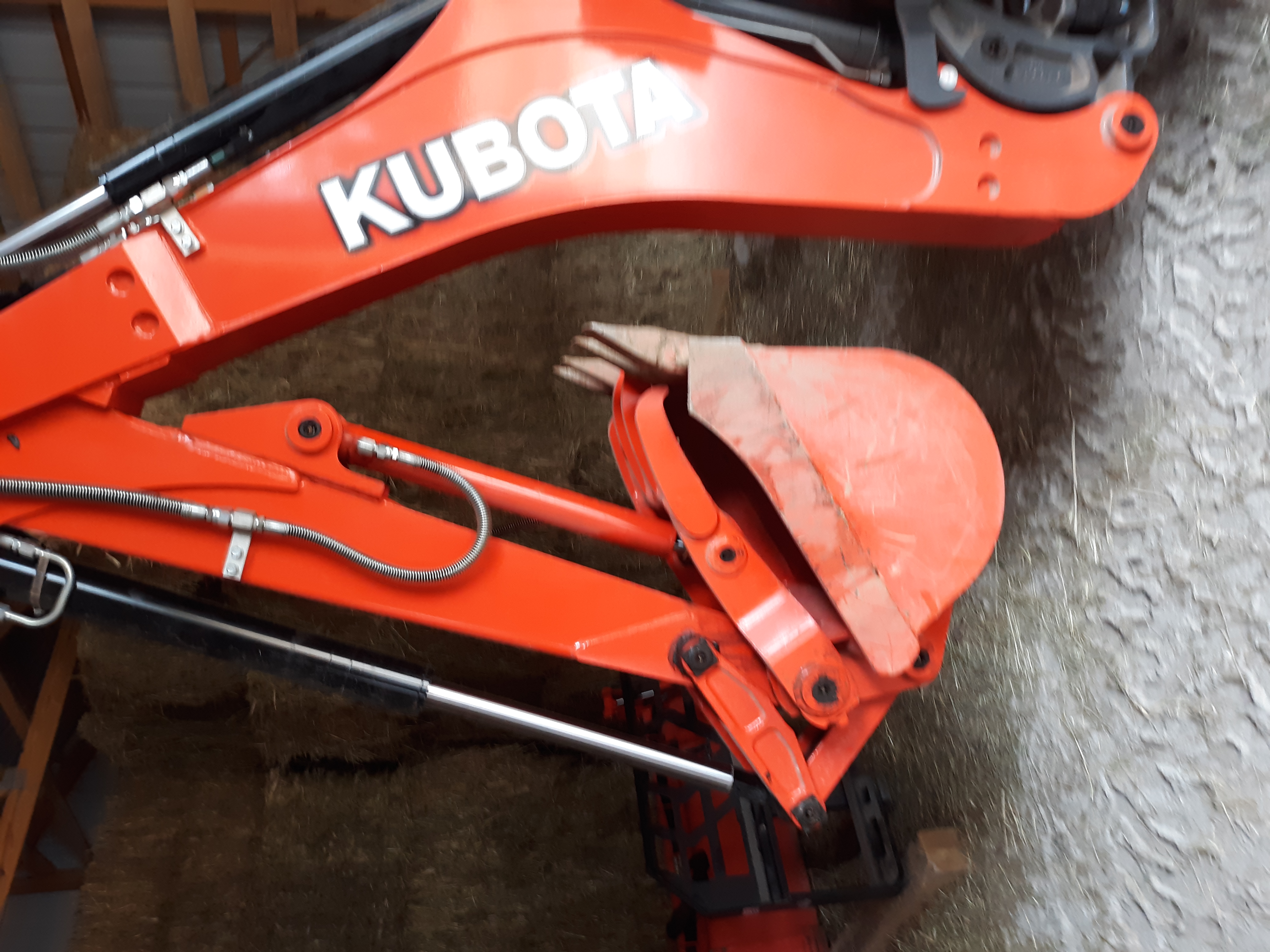

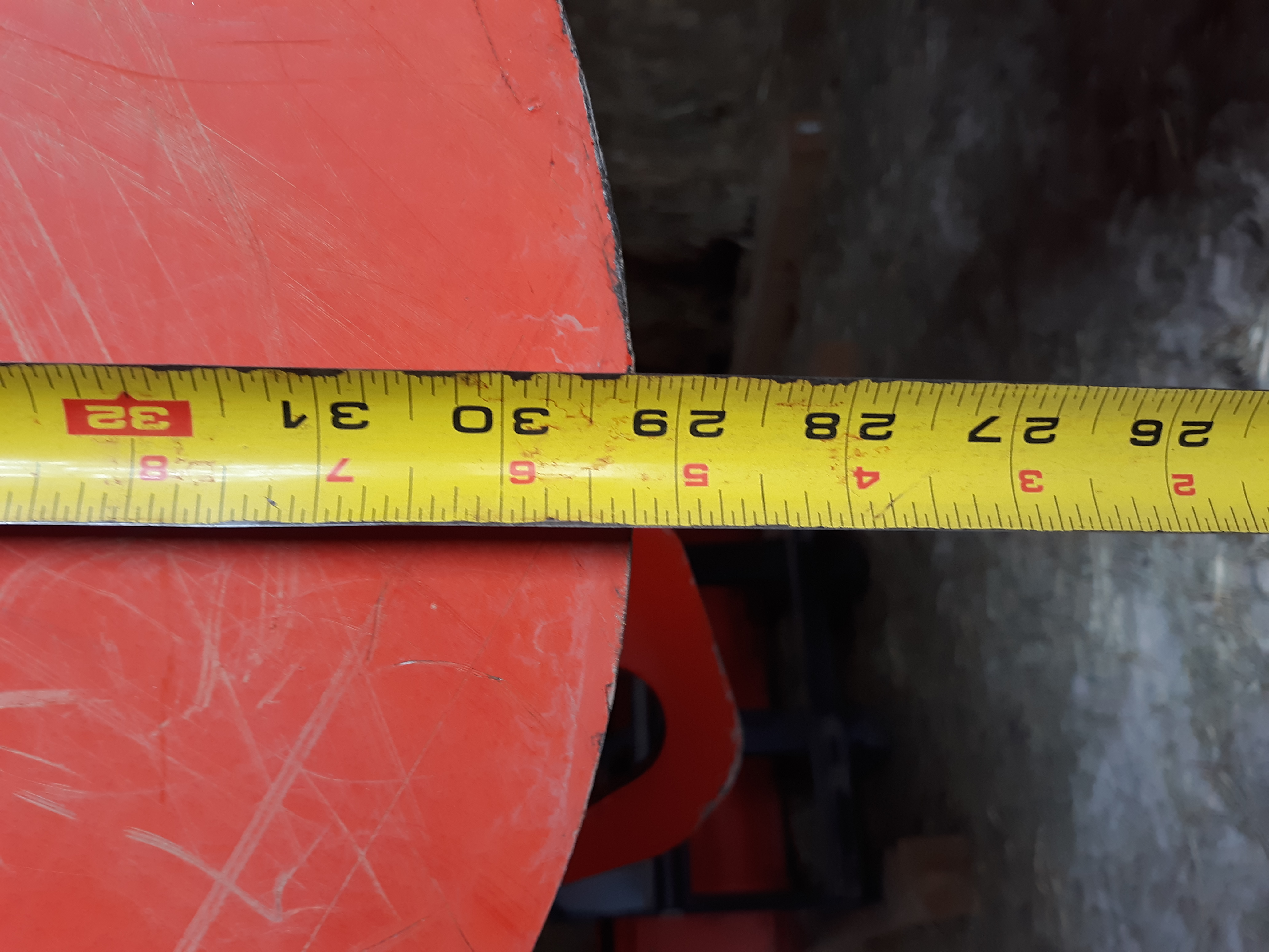

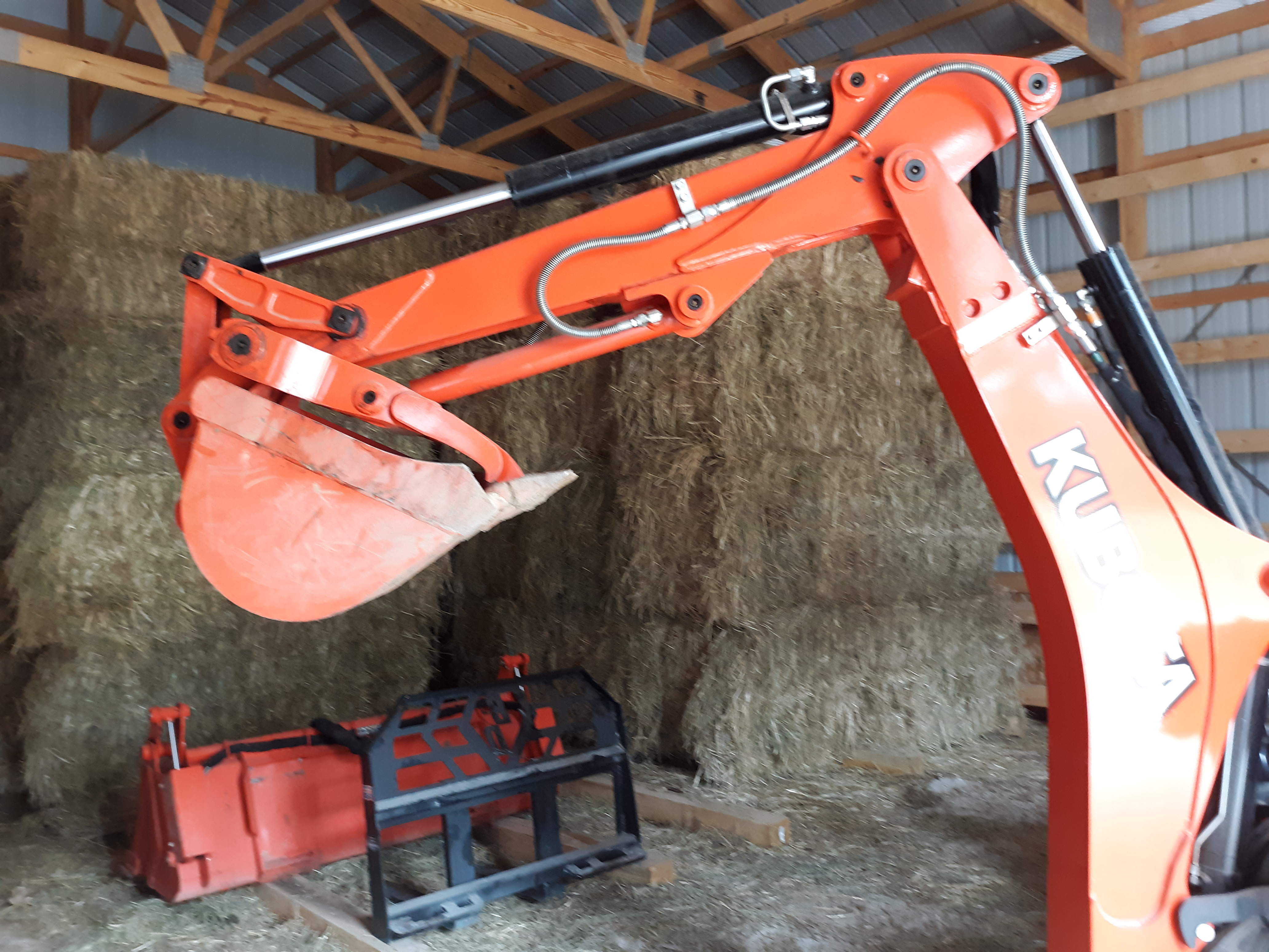

I have a MF 1635 TLB currently and a 7x14 14,000lb dump trailer with diesel truck to pull it. I can put 10500lb in the dump trailer. My MF will load in backwards and once in I swing the hoe 90 degrees to the tractor and it just fits in the 7ft wide trailer. Then the loader just fits in gates closed. I doubt either on of these will do that. So I知 wondering if the how will fit over the front wall backing in and hang over the front to fit in the trailer. My MF is about 6-8 to short to hang over. Like I said I don稚 do this for a business nor every day. But for me I want to be able to move it if I need to so I知 looking for my options. I致e looked at 16 ft dump trailers but if I buy a new TLB I won稚 have funds for a trailer as well. And I don稚 have the use of another flat bed 20ft trailer to sit around.
I will take a picture and measurement and show you....:)
   / Kubota L47and M62 Dimension? #12
Here back it on then dipper up then back all the way up to the front end... bh4.jpgbh3.jpgbh2.jpgbh1.jpg

Thanks Peter 315! Wow the bucket is 29" off the ground in transport position. my dump trailer has 23.5" sides and my current TLB is only 18". So this one will go right over it and looks like it will gain me a couple feet. I assume the M62 will be just as high or higher to go over the side.
   / Kubota L47and M62 Dimension? #14
M62 higher I would guess....

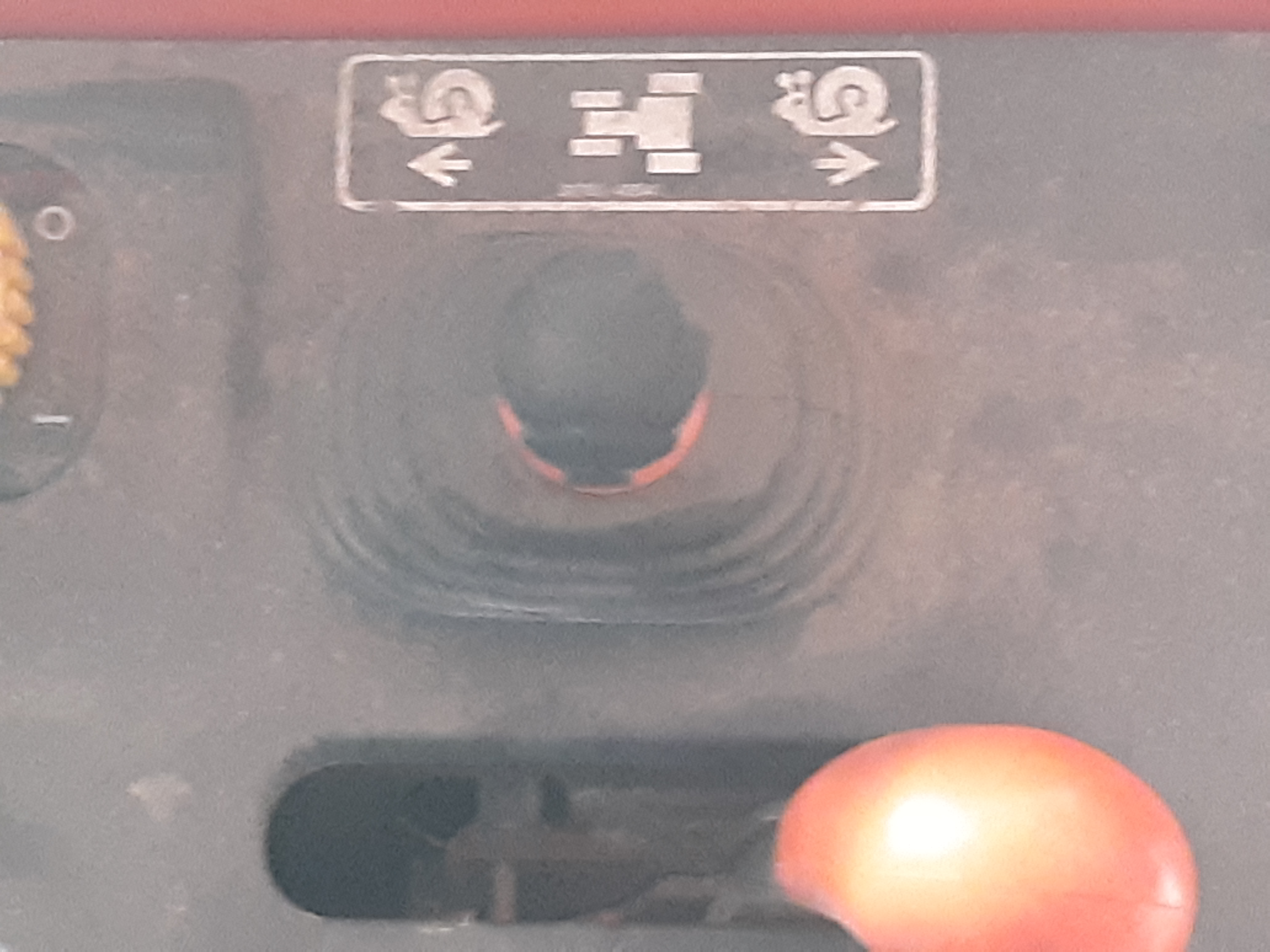

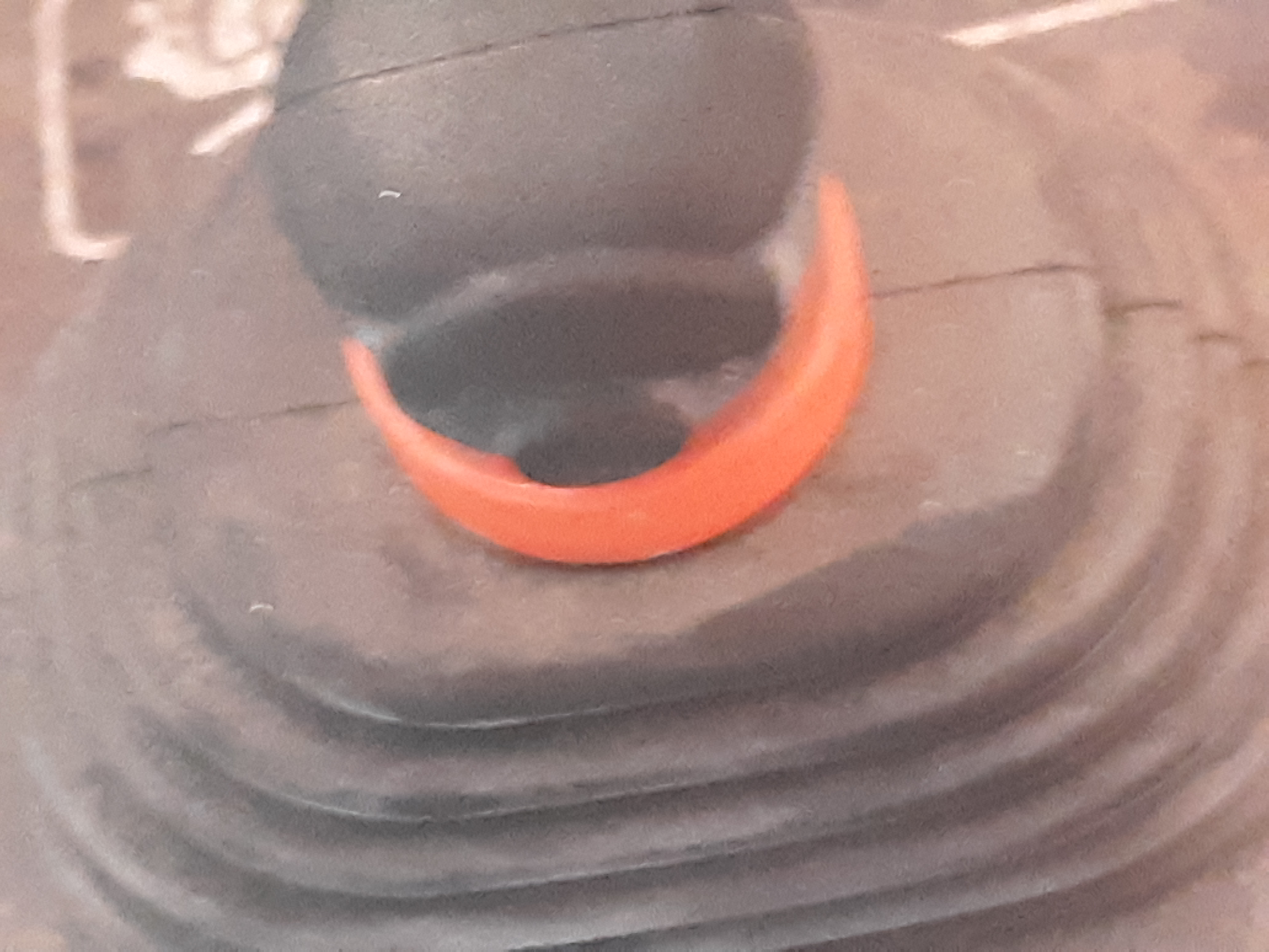

Actually yeah! I went and looked at one today 3 hours from me that痴 going up for auction. Keys were in all the machines to test out. Due to the current world situation no one was there to help or answer questions. I gave it a good look over and ran everything. The only thing I couldn稚 figure out was how the crawl feature worked with the backhoe. Is there some special position or lever needed set in order for the crawl lever to work? That either doesn稚 work on it or else I wasn稚 holding my hand, feet and tounge just right to make it work. 🥴
I googled and found an online manual for it but there was nothing in it about that or the backhoe operation. 🤷🏼*♂️ So is there a trick for that feature to work? Thanks!

The big knob you move to go back and forth has a small button on the side to push in as a safety......

Marshall Machinery. So there痴 a small button that needs pushed in on the small crawler lever then that needs pushed? I totally missed that!
