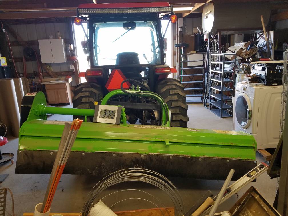

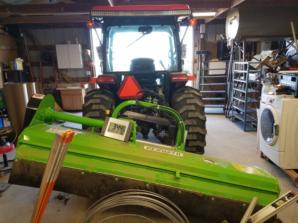

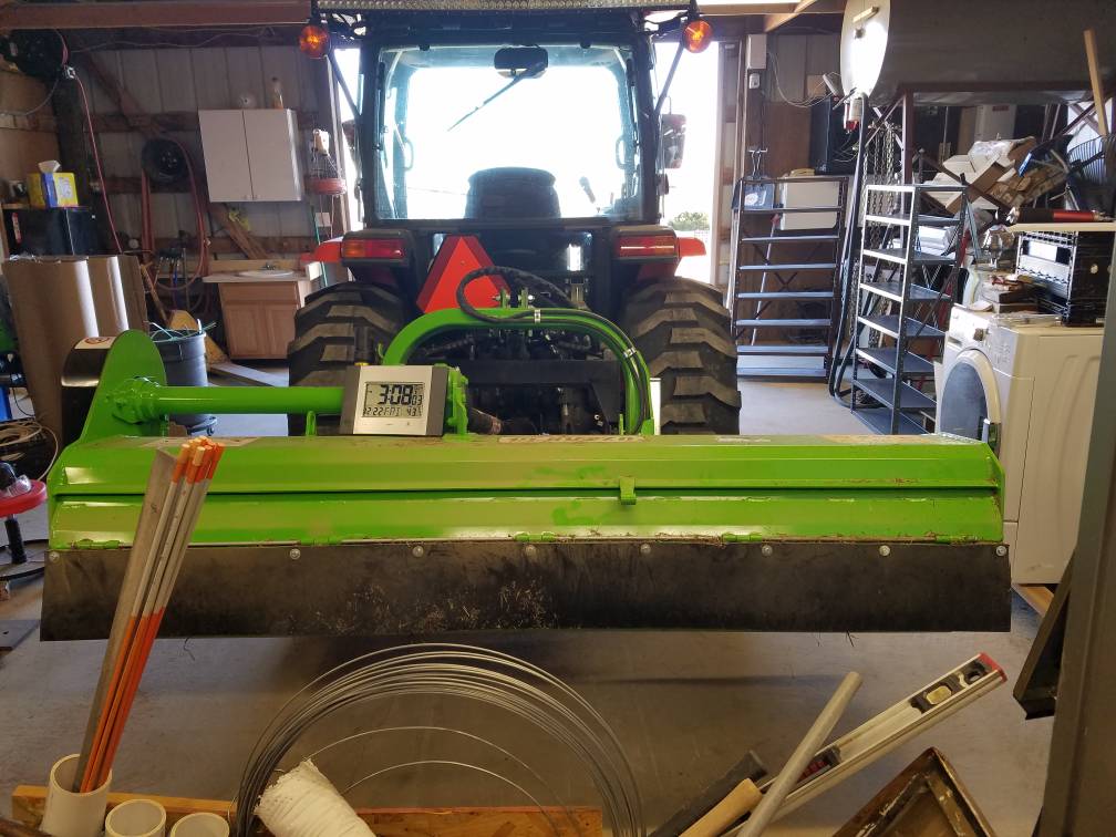

Take a look at the clock next to the gearbox. It was cold (machine & outdoor temp). And that is after taking it to the dealer for them to fix it. I think they replaced 2 valves. 20171222_150735.jpg20171222_152211.jpg20171222_154409.jpg

Take a look at the clock next to the gearbox. It was cold (machine & outdoor temp). And that is after taking it to the dealer for them to fix it. I think they replaced 2 valves.View attachment 533780View attachment 533781View attachment 533782
:eek: So did they ever get you what Kubota's acceptable internal valve leakage rate is? Did they get your linkage smoothed out? :confused3:
I just don't get it, Kubota seems to have very good loader valves and not so good rear remote valves. JD is the exact opposite, their loader valves are questionable and their rear remote valves seem to be pretty good. :confused2:

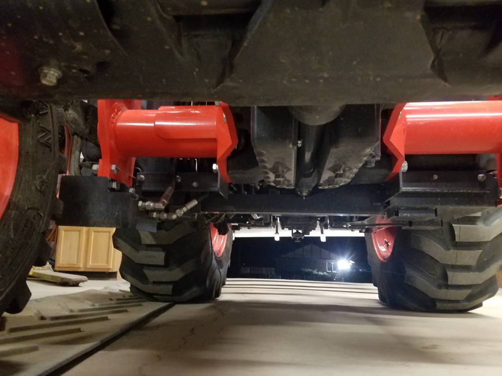

Nope, my dealer couldn't get that info out of Kubota last I heard. My toplink is around an inch an hour. Not great at all, but if that was it I'd just live with it. That sidelink is attrocious though & worse than before I took it in I think. That mower is heavier than my other impliments. I have it centered at the moment rather than the 1.5' offset the old Ford 917 had so it should pull on the tilt cylinder about as much.
Haven't played with the linkages to much, but they seem a fair bit better.
They moved the 3rd function hoses so they aren't hanging as low. But I'm thinking I'll still need to fab up a skid plate as that whole assembly is the lowest part of the undercarriage.
Like the machine & HST+, but any hydraulics other than the loader & 3pt are a stain on Kubota's reputation.20171217_210531.jpg
