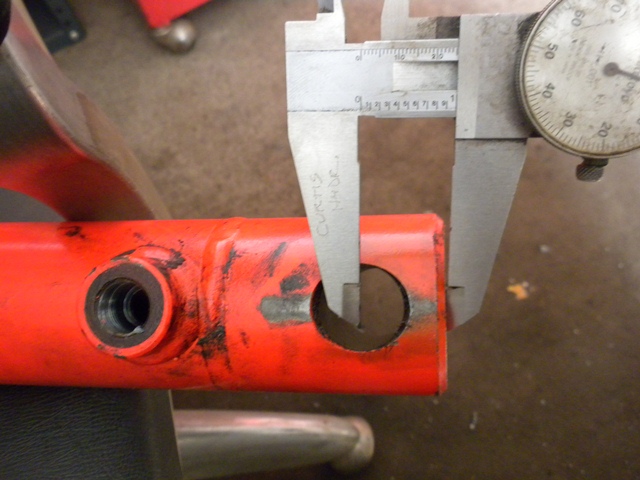

Cross head (rod side): 50mm dia x 2.250 wide w/ 1.014 pin hole (for 1.000" pin)
Cyl barrel side: 60mm dia w/ 1.014" pin hole (center of pin 1" from end, see pic).......do you want the weld machined off or just leave it longer than it has to be..??
Cross head on the rod is 2.75" and on the cylinder barrel it is 2.375" so they do not quite match what I have. Man do they set out to make things this oddball or what? Any other thoughts? If your cylinder ends would have fit I was going to get the surplus cylinder and cut and weld to an exact fit. But hey if it was easy anybody could do it right? Bill appreciate all of you input and suggestions, Thanks. It always helps to have someone to bounce ideas around with.:thumbsup:
