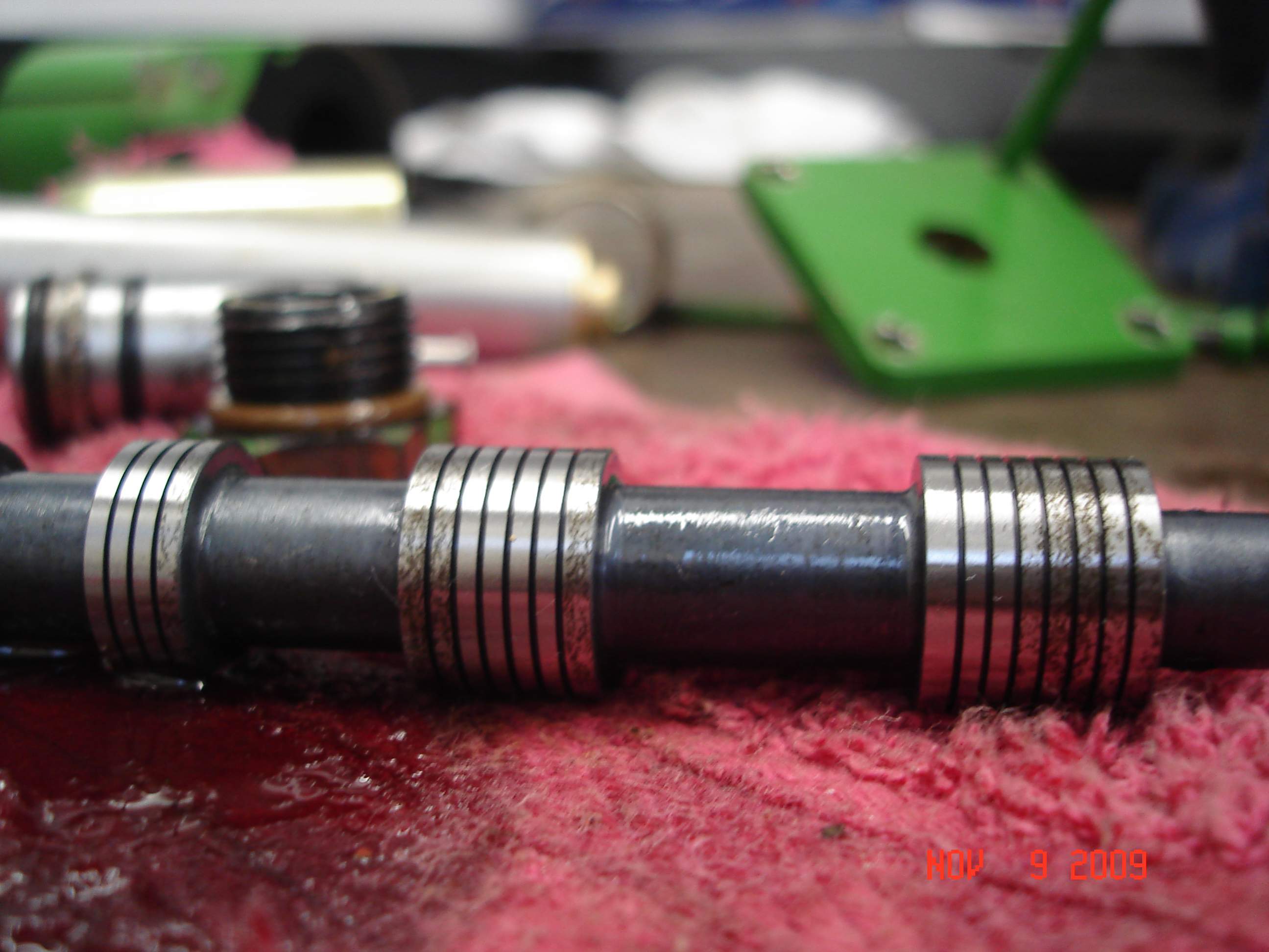

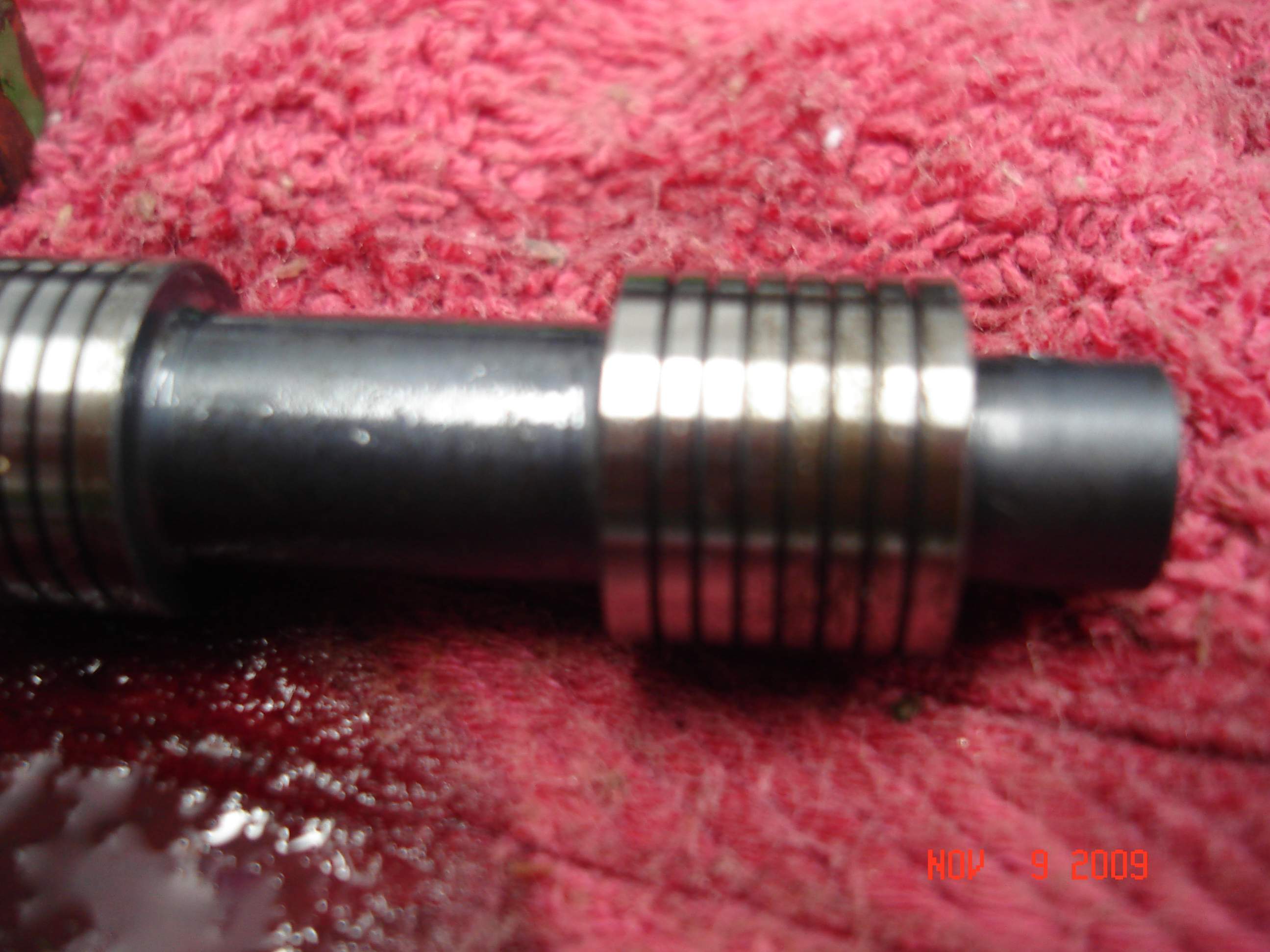

Yes, that sounds like the valve. Sometimes there is a button or a hole that will operate the spools manually so you can exercise the spool, can you post a picture?
Here is a pic of my diverter spool I had to clean up once, the slightest bit of corrosion will bind them up:

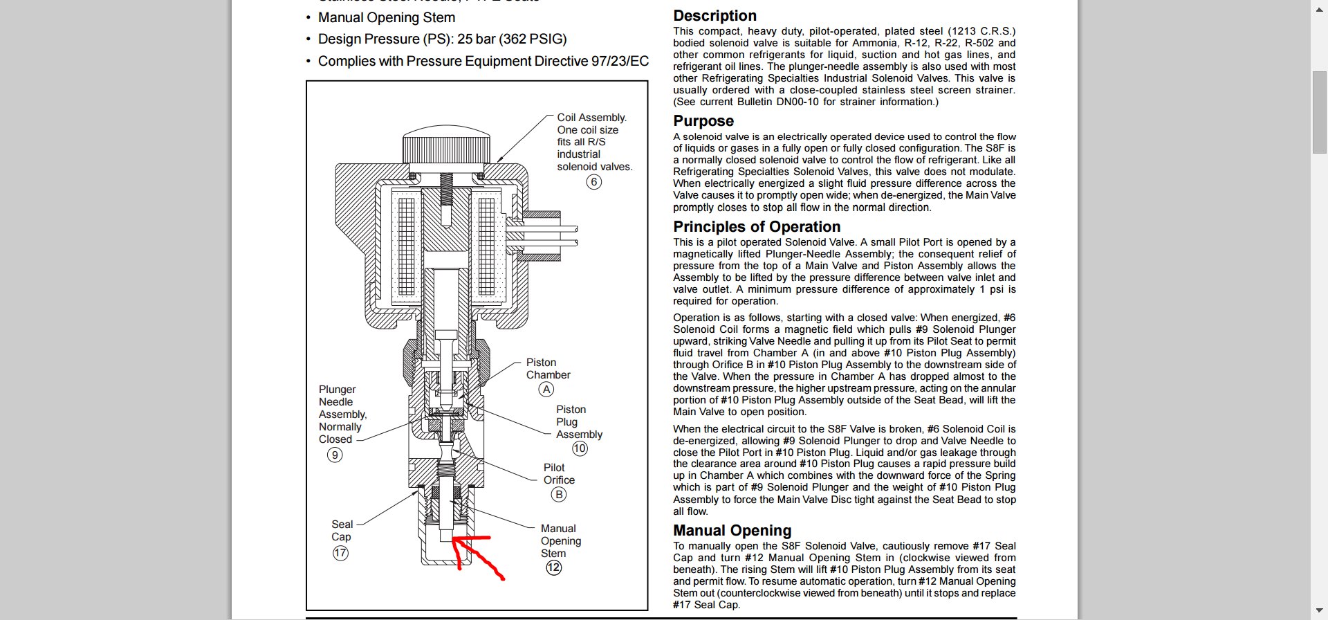

Remove the screw caps on the end of the solenoid and see if there is a rod you can push or turn to manually activate the valve.
You may have to to take the plunger/spool out and clean it.

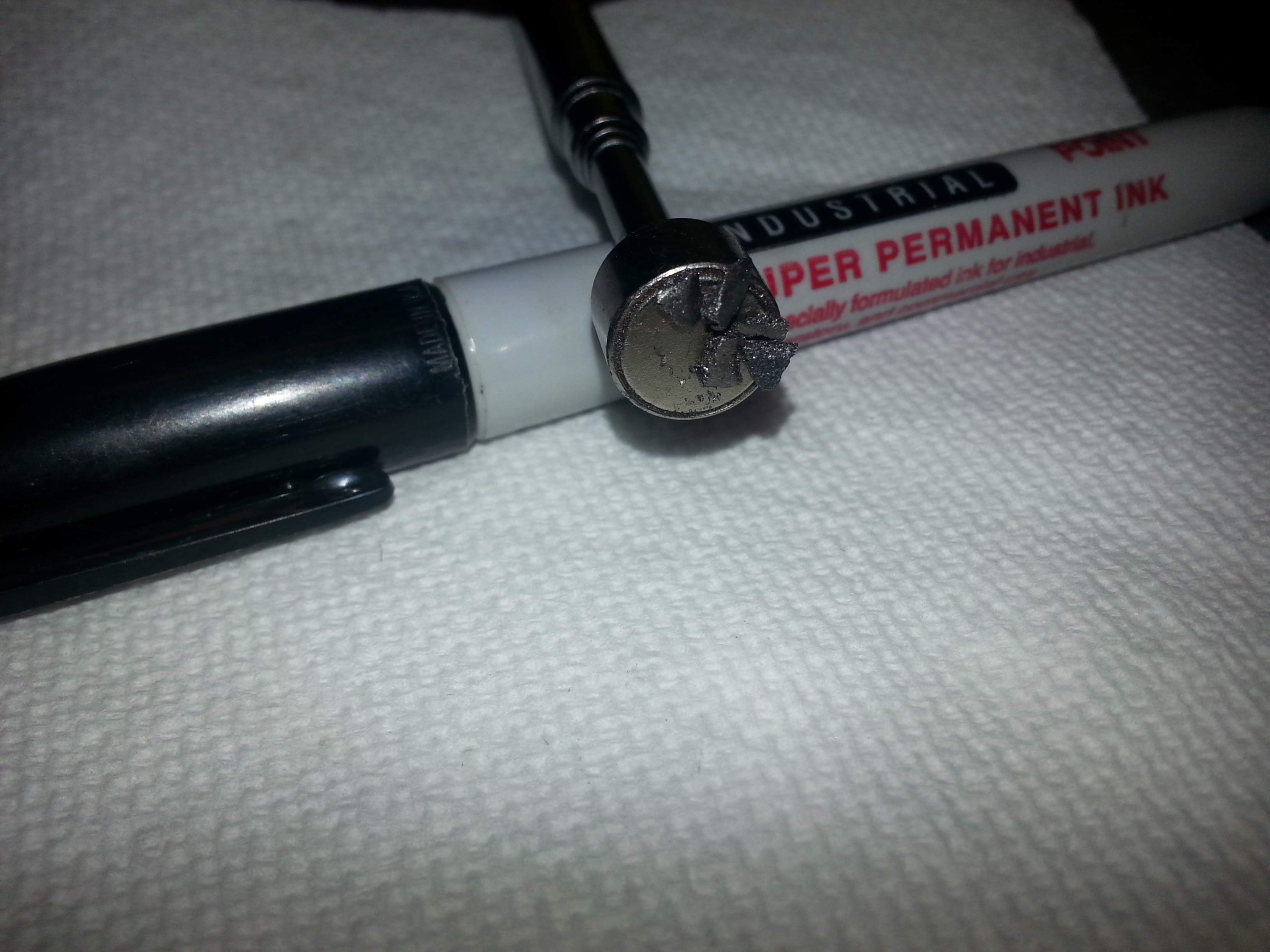

Was able to disassemble and get the spool out with a slight bit of difficulty. Thought that the resistance/grinding felt when coming out would be corrosion. Nope. When it finally came out, I found a couple of very small pieces of metal stuck to the grooves. No corrosion at all; it was shiny, clean and well lubed.
Ran a small pocket magnet down through the valve body and pulled out what you see in this image.
Reassembled valve, mounted grapple and worked for two cycles. On third attempt, found it works to open grapple but will not close.
Next step will be to drain and flush the system. New filters and new oil. Since those are not 'shavings' pulled from the valve body, I can only begin to imagine what I'll find in the filters. Hoping this is a one-off event and not something far worse.

Let up know what happens, that was some ugly bits you pulled out of there!

So we're back. Worked like a champ the first go round. Wish I could flush my memory system and have it work as well.
Same issue today and lo & behold, Google turns up my own thread when I started researching my problem.
Only a single ugly bit this time but cleaning it out did the trick.
