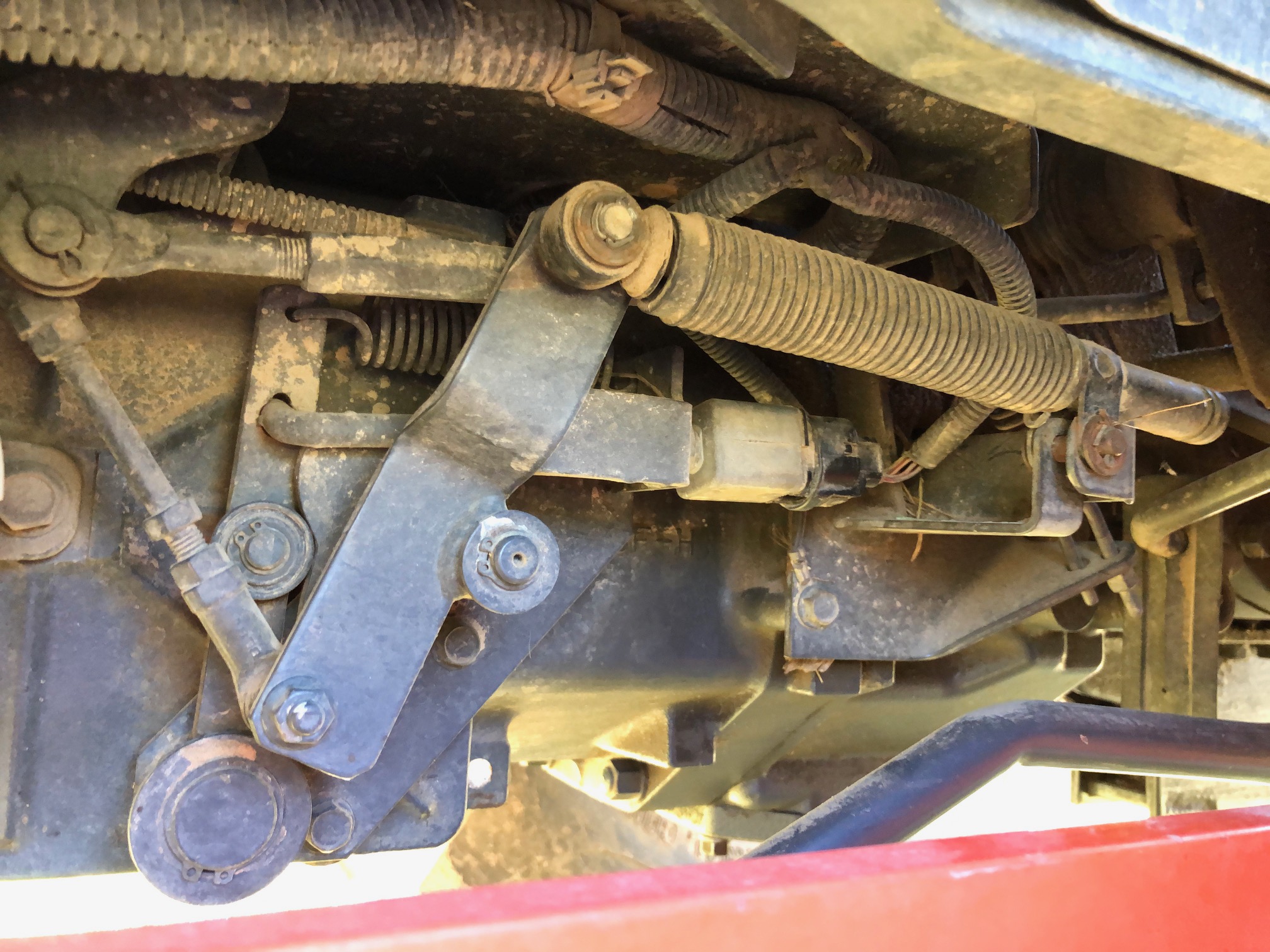

The display was showing HST Neutral. I thought this meant the HST tredal pedal but couldn't find the switch for this. After checking fuses and the battery I found the gear selector switch was disconnected. Plugged it back in and good to go.
Wanted to share the solution in the event someone else has the same issue.
Thanks for all your help. View attachment 621852
