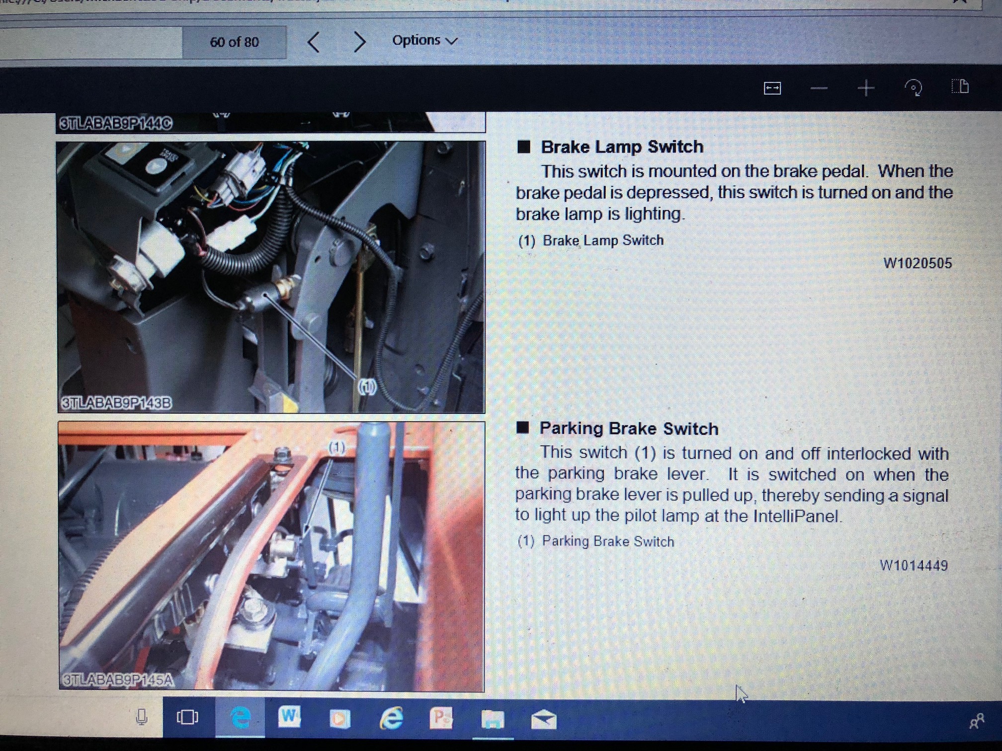

I have left the parking brake on a couple of times while running my tractor. The indicator light does not light up when I depress the brakes. I don't have a WSM for the tractor so I don't know if the bulb is out or there is an adjustment on the pedal itself.
The tractor still operates with the brakes on so it is possible they are worn or are not adjusted correctly as well.
If you have any advice, tips or opinions please post.

from WSM:
Parking Brake Switch Panel and Wiring Harness 1. Disconnect the connector from the parking brake switch after turning the main switch OFF. 2. Turn the main switch ON and connect a jumper lead between the connector terminals of wiring harness. 3. If the parking brake indicator lamp does not light, the panel circuit or wiring harness is faulty.
Here's a picture from a different section covering the Parking Brake.
Hopefully you'll find the info helpful.
Good luck and report back what you find.

Thank you Moship. Very nice of you to post the photos from the WSM.
