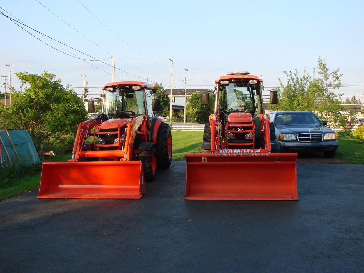

I had a 4240 cabbed Kubota. You won't find a better machine in my opinion. Just a great all around machine.
