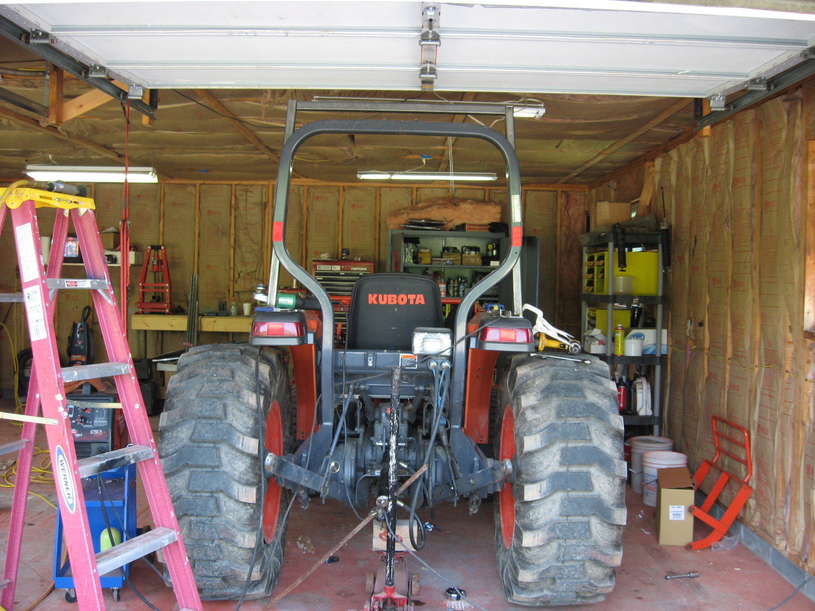

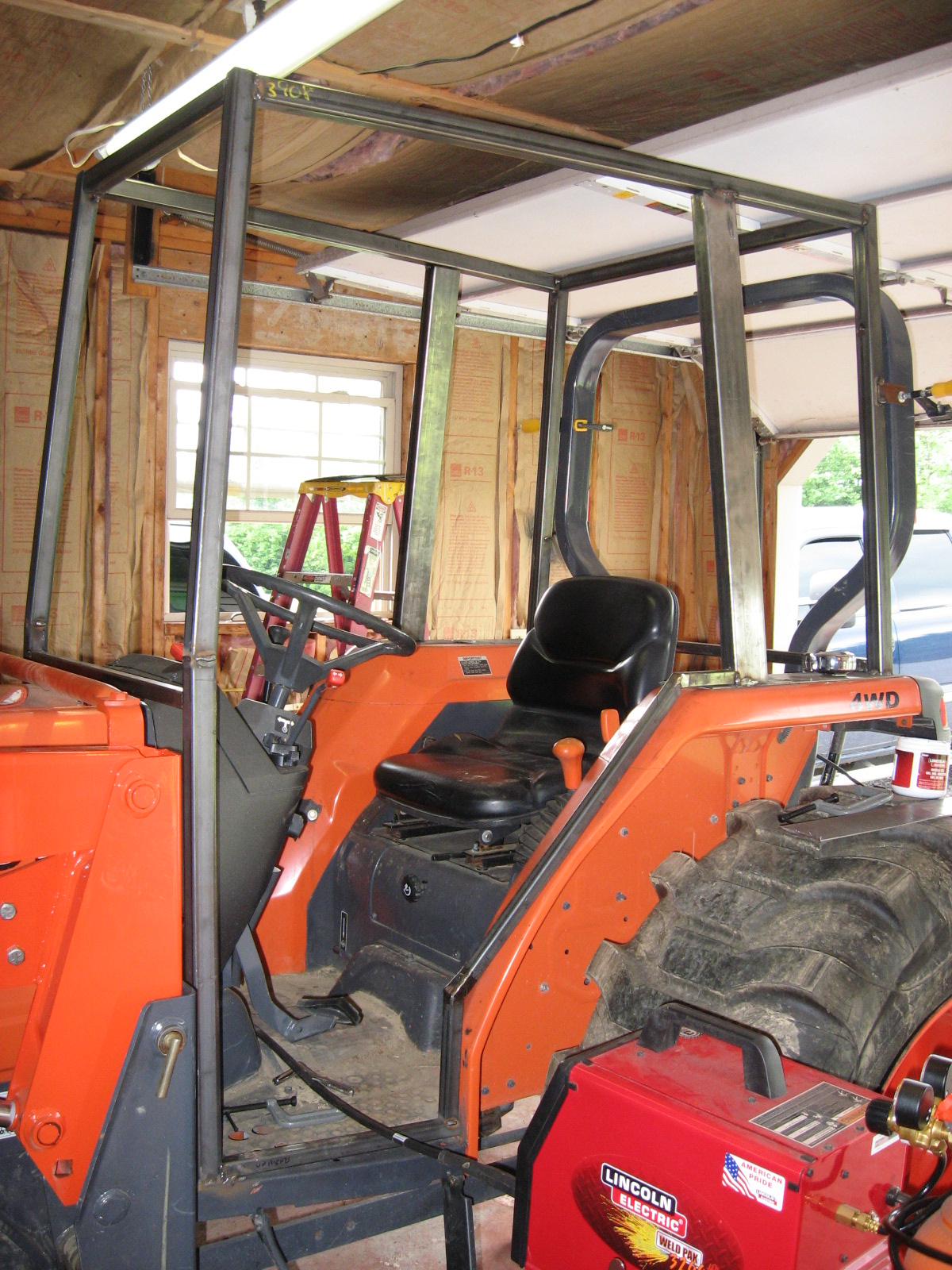

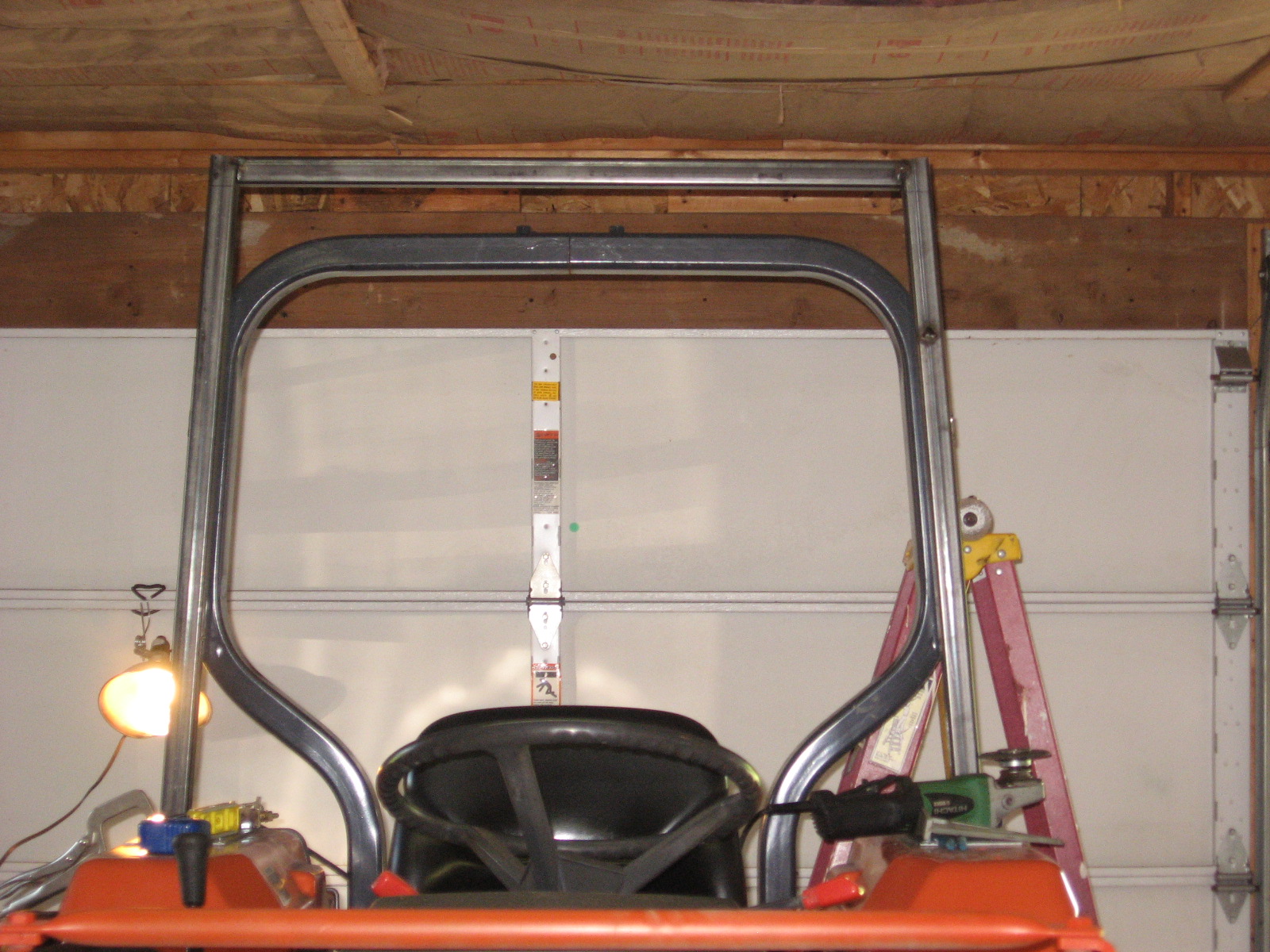

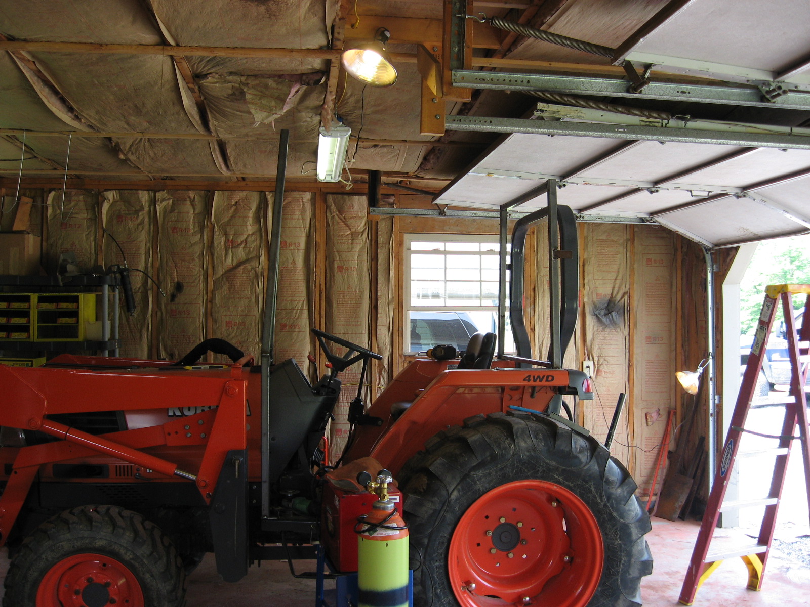

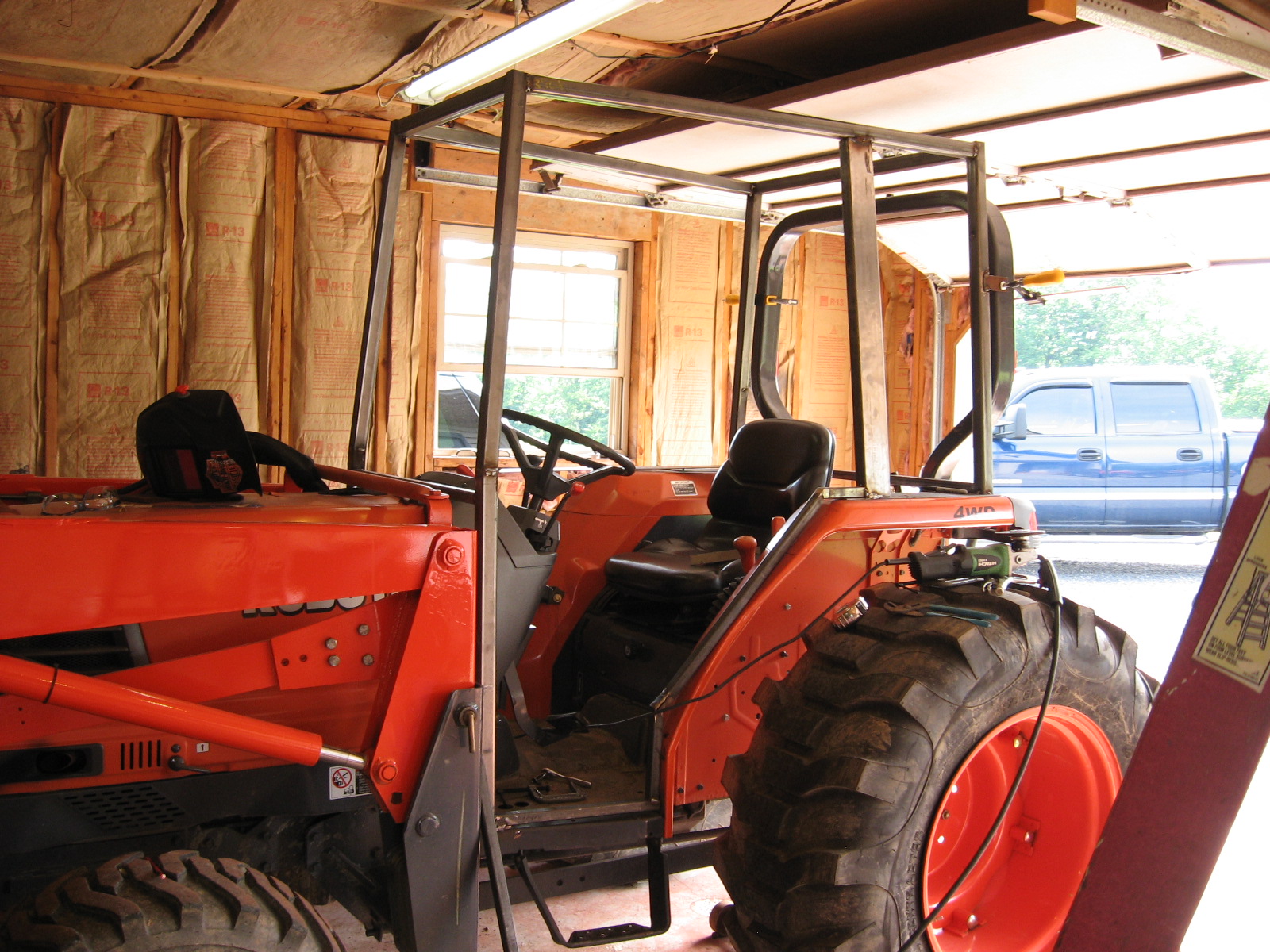

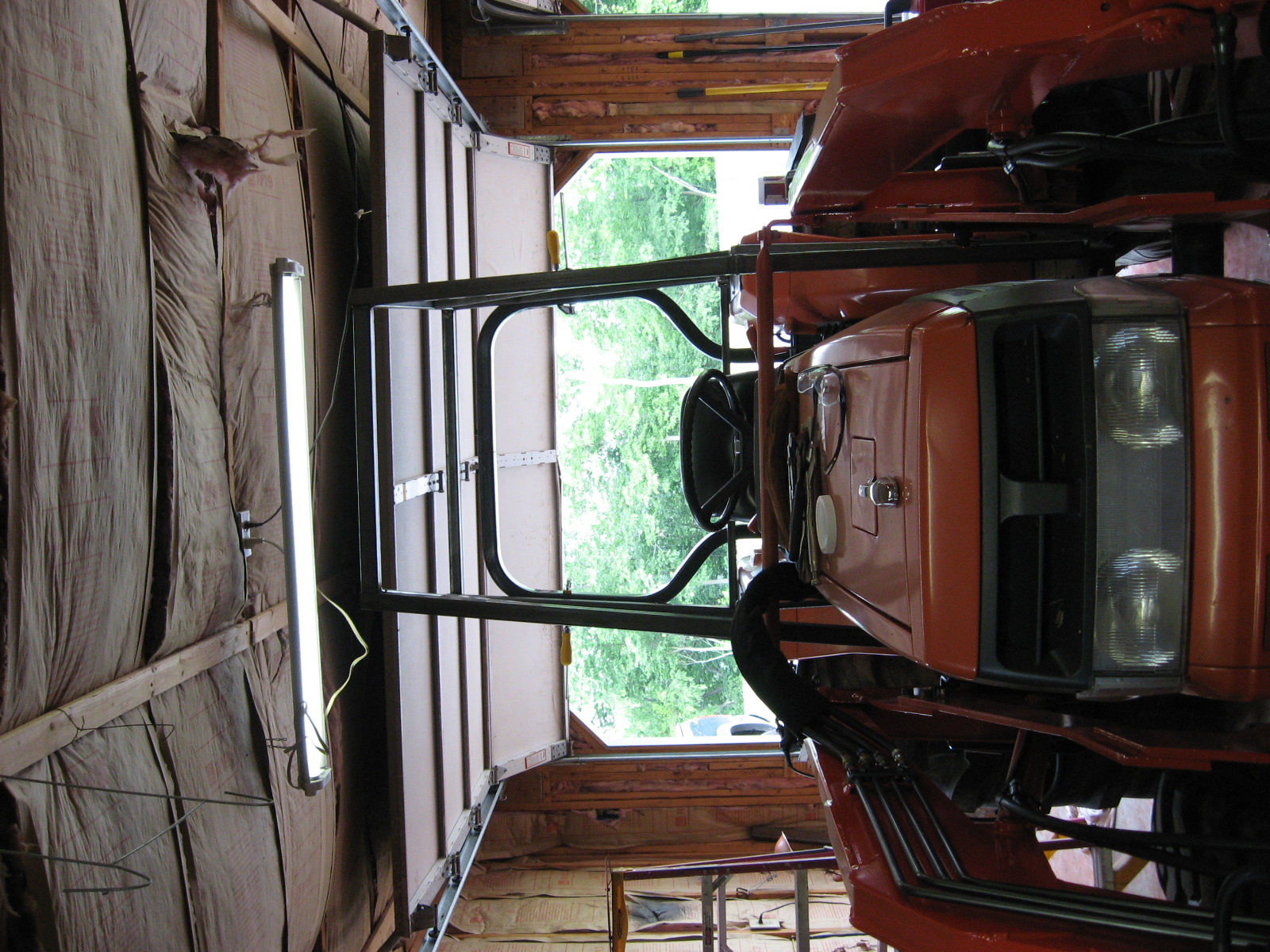

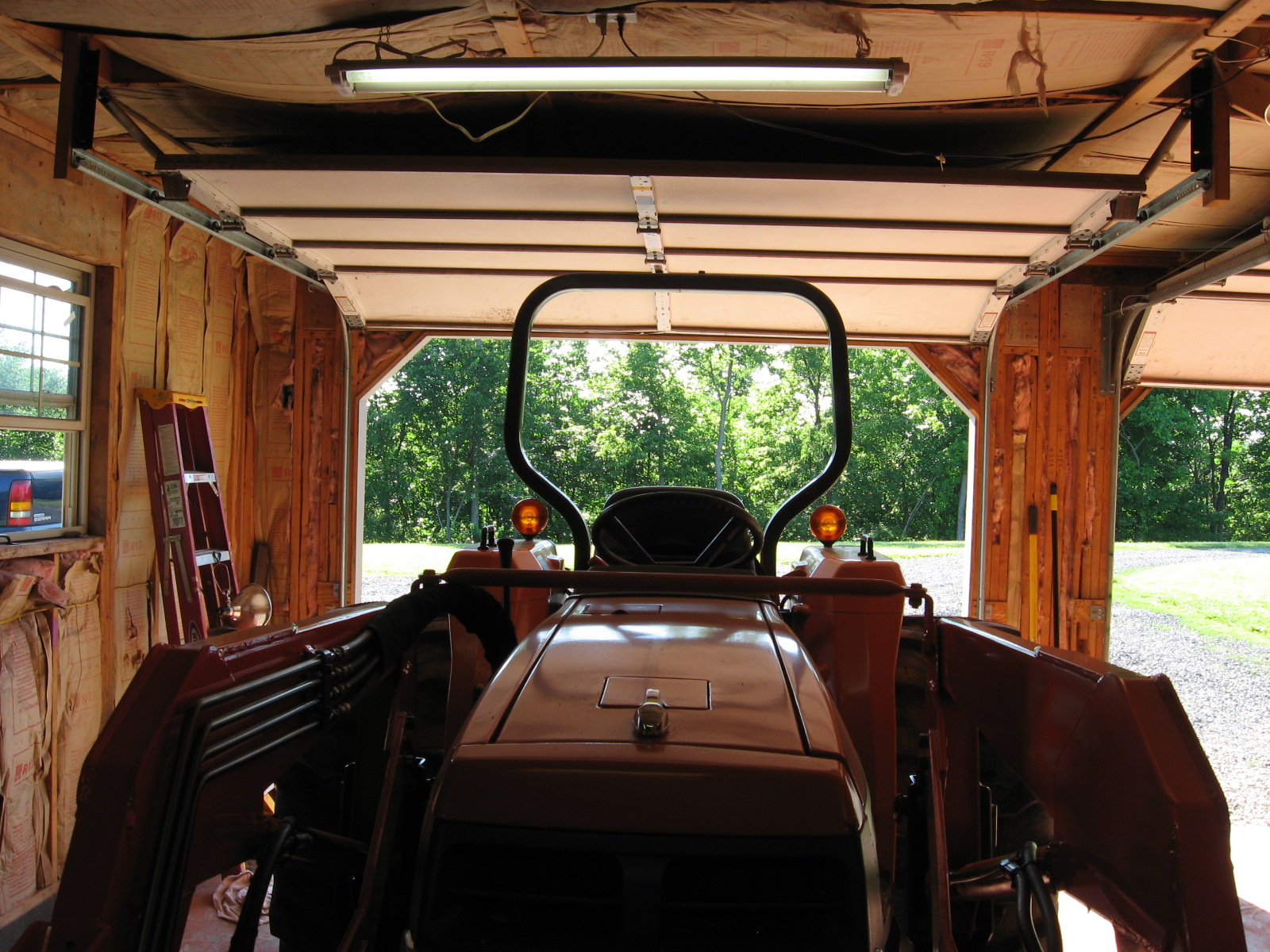

YES I HAVE IT PLANNED OUT, IT WILL SLIDE OFF OF THE MACHINE FROM THE FRONT THEN I CAN BACK THE TRACTOR OUTSIDE AND FINISH THE WELDING IN THE GARAGE ROLL IT OUT ON DOLLYS AND MY BUDDY IS GOING TO HOIST IT WITH HIS EXCAVATOR TO SET IT IN PLACE ON THE TRACTOR. NOT THAT I WANT SNOW BUT WHEN WINTER COMES I WONT BE FREEZING TO PLOW MY ROAD WHICH IS 1 MILE LONG AND MY PARENTS DRIVEWAY.

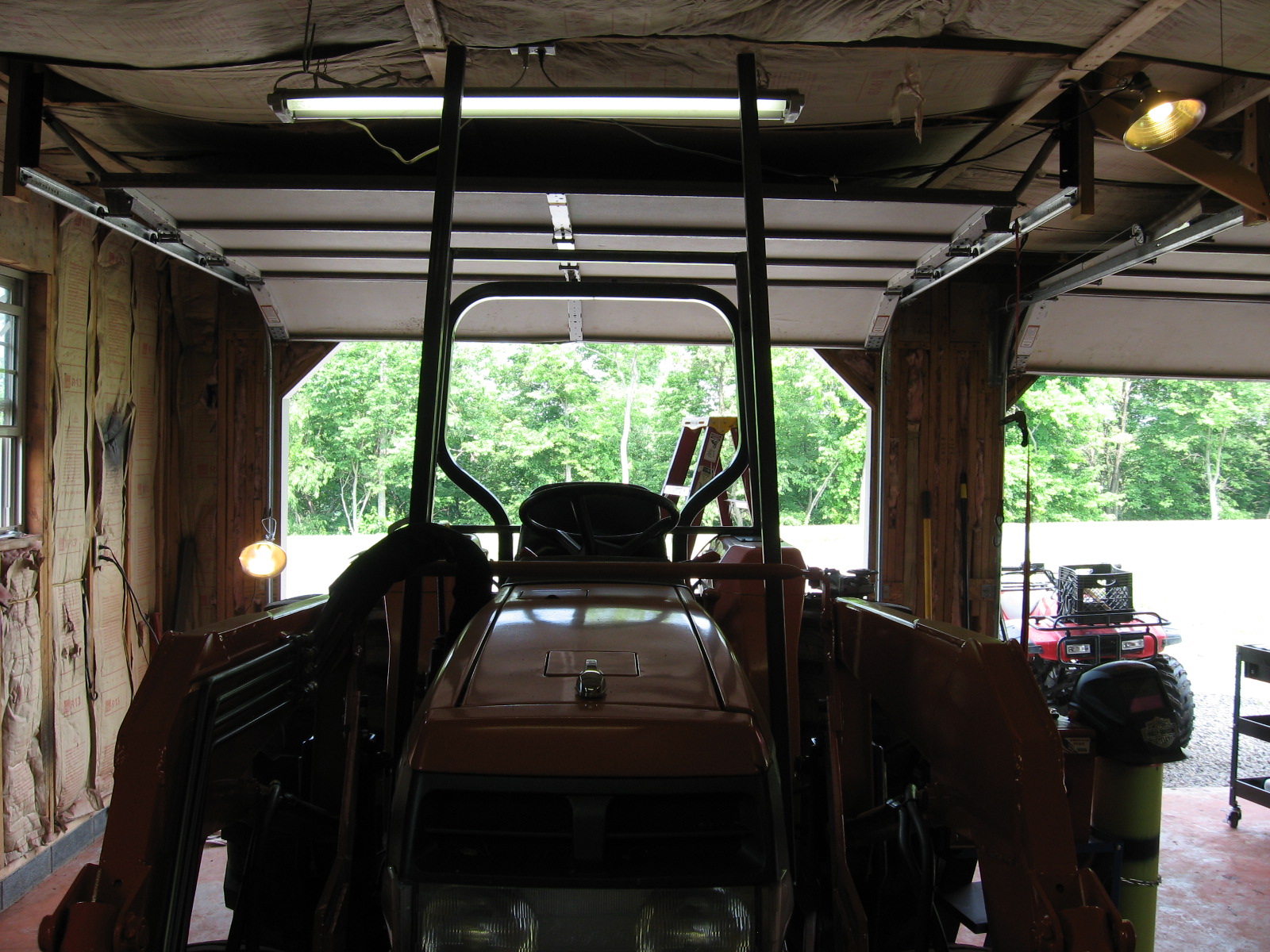

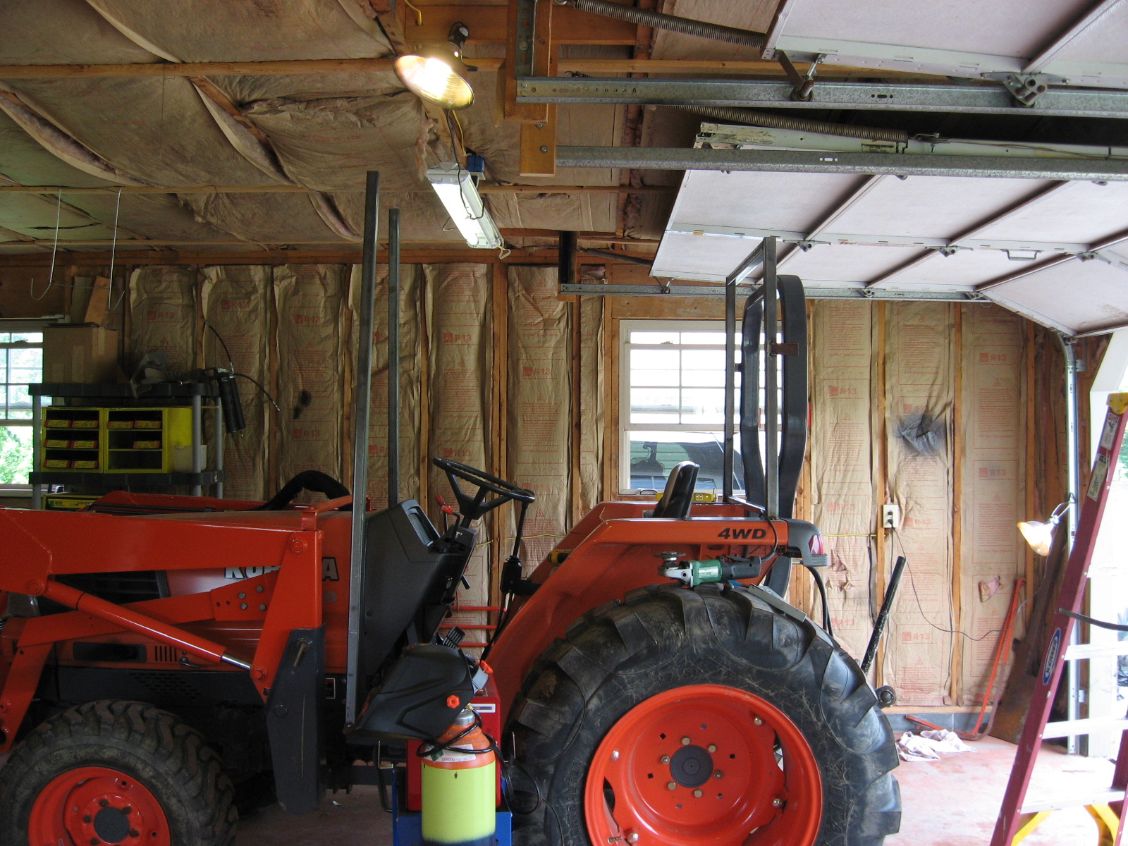

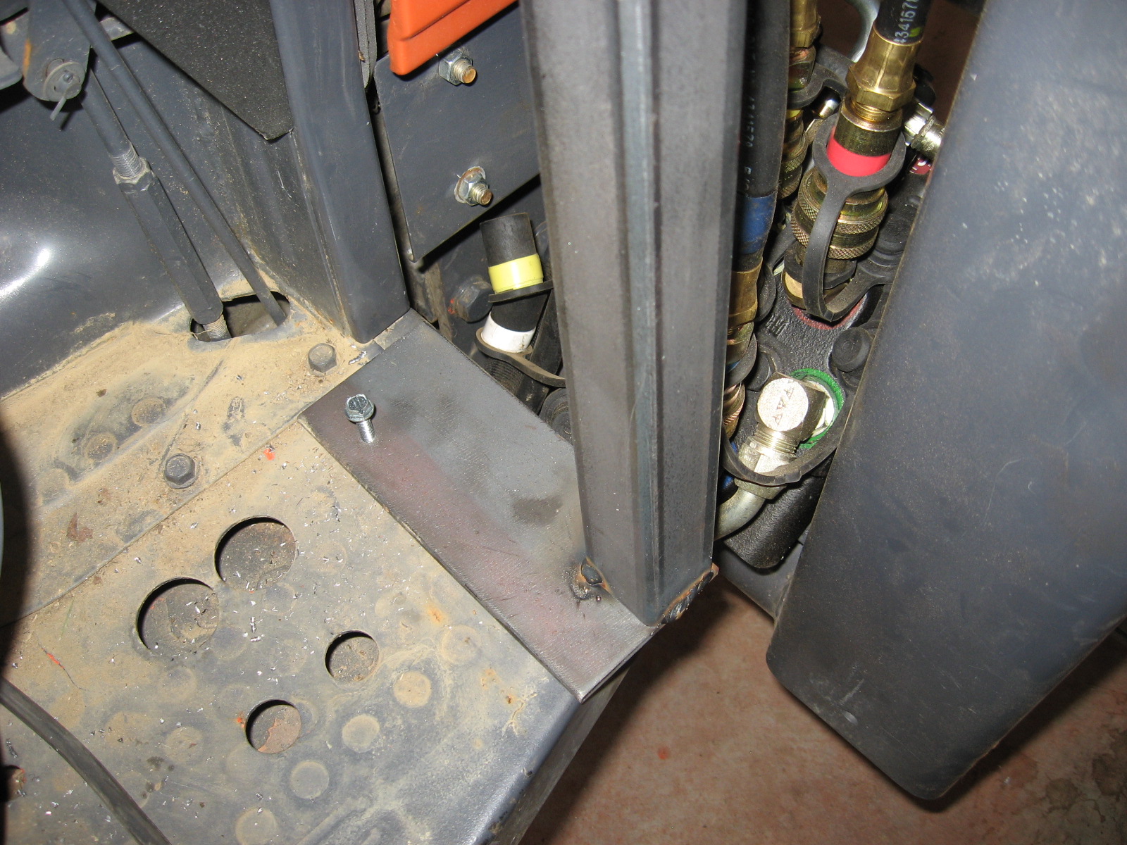

A FEW MORE PICS..........
