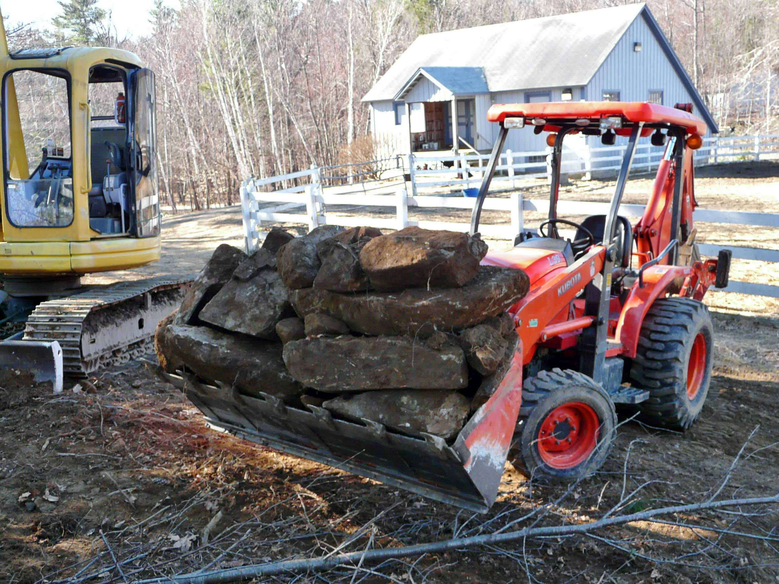

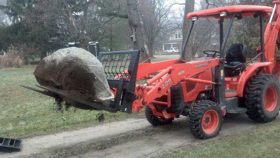

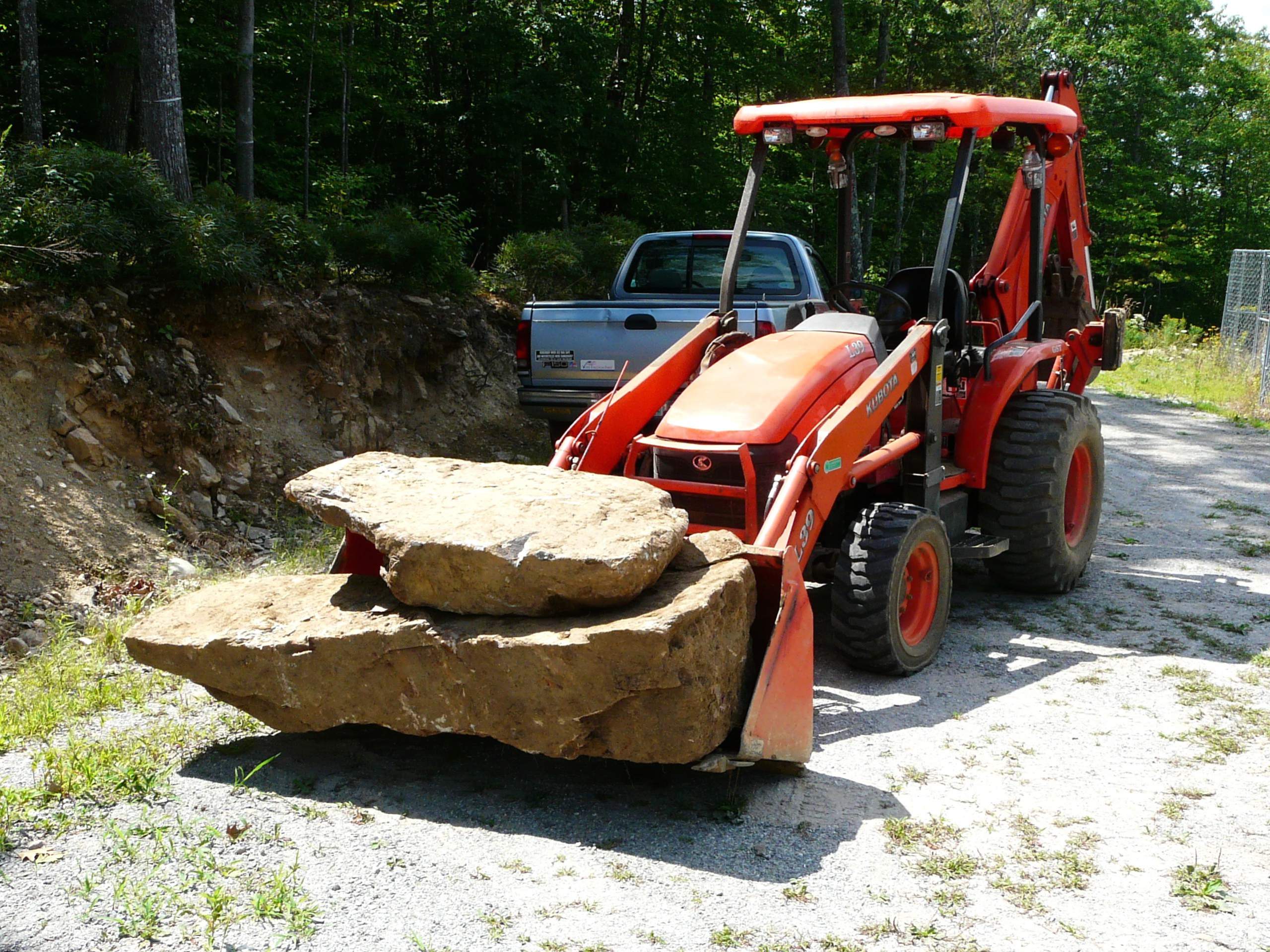

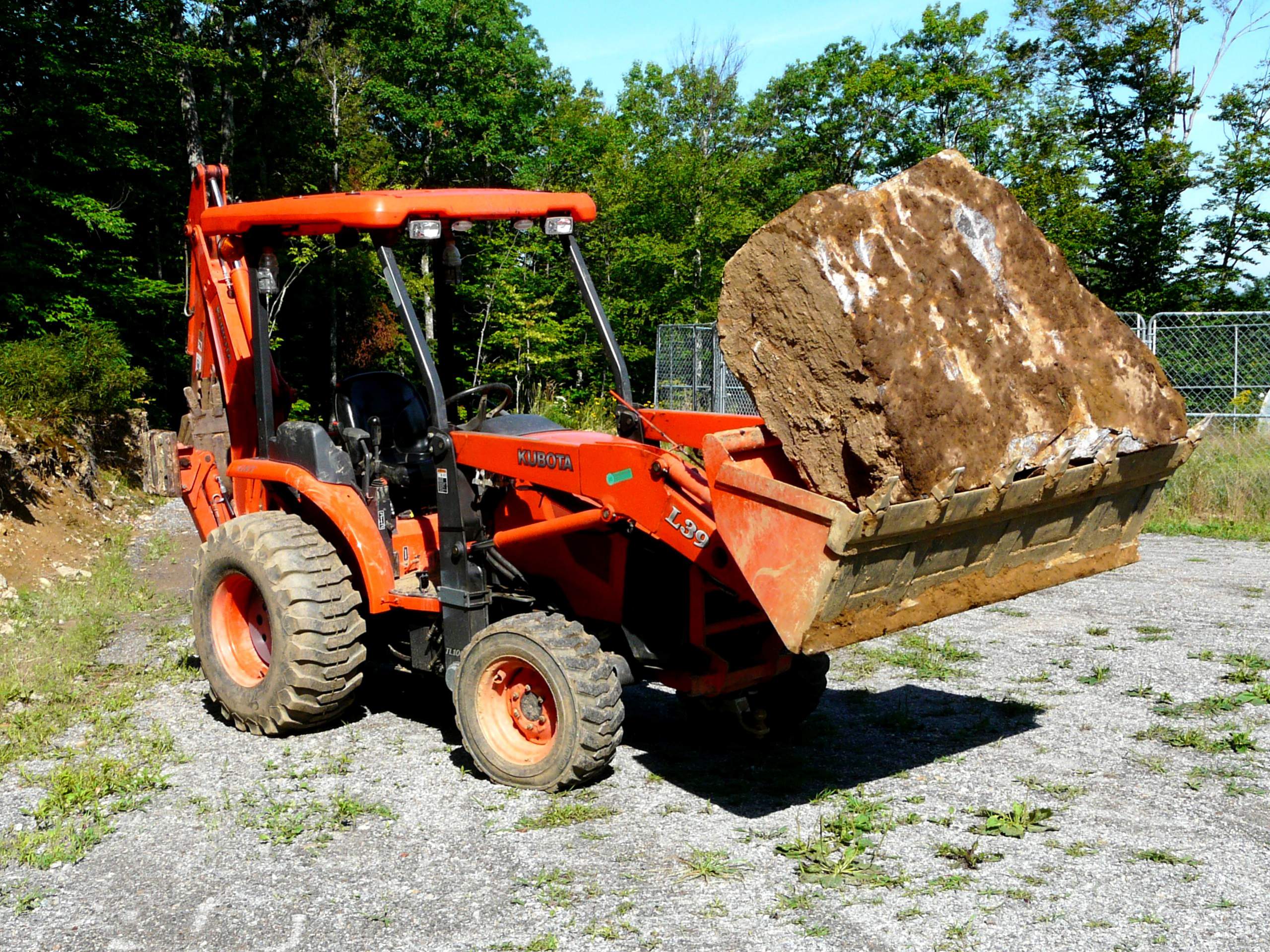

Is that the L39 lifting that rock in your picture?
/ Kubota L39TLB access #4
Depending on my shoes, I can stay seated and drag my feet around . Sneakers -yes, boots - no. I have a B3350 and a l39tlb. Only a front loader on my B3350 , and it's kinda a toy compared to the 39. I think you'll love it. I do. Except in the winter when it's cold.
/ Kubota L39TLB access #5

/ Kubota L39TLB access #8
Great. Standing up, rotating seat, and sitting is no problem. Thanks!
That tiny pebble?
These are good machines.

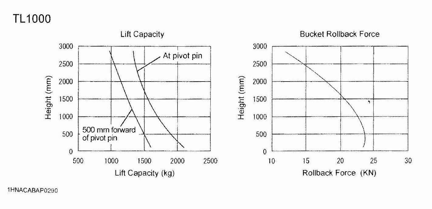

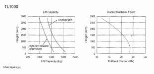

  • Kubota Tractor Model L39TL TL1000 Specs.pdf

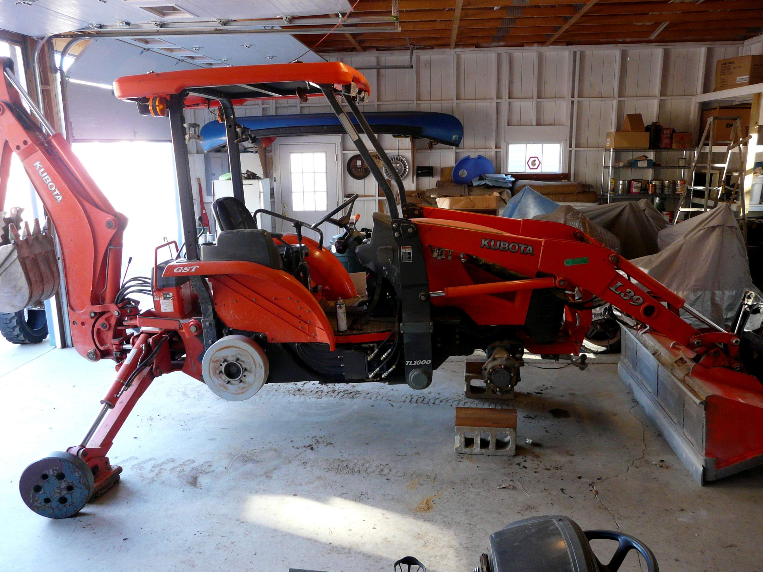

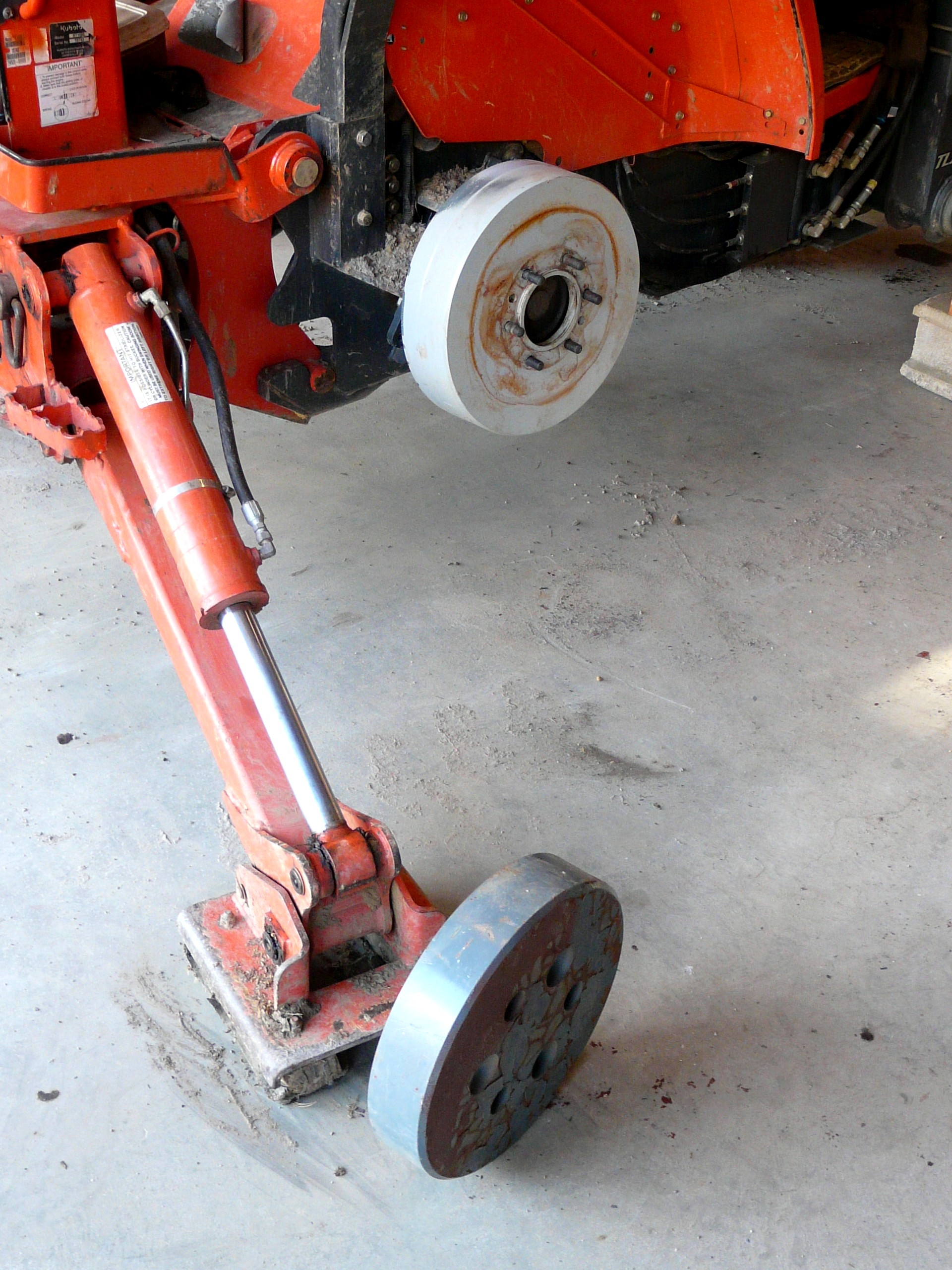

Mike,I am guessing you have wheel spacers on the rear axle.If so,how thick are they and what do you think the minimum thickness would be that would still allow chains?
/ Kubota L39TLB access #13
I have inner & outer wheel Wieghts to add another 750 Lbs to stablize the tractor.
1 inch spacers are enough, 1.25" would be better.

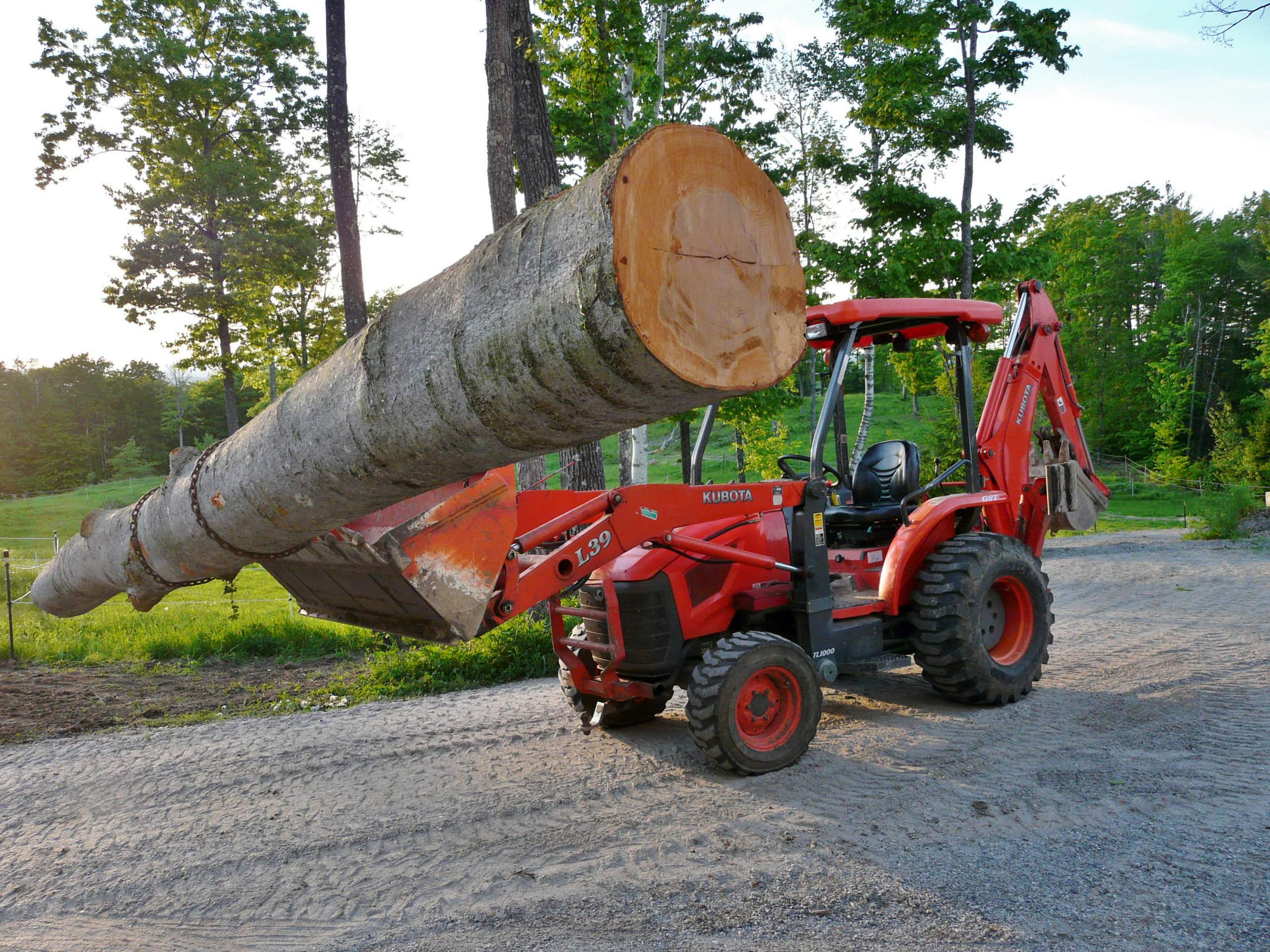

/ Kubota L39TLB access #14
Show off :)
Placing rocks in the L39 bucket with the excavator does not count as lifting them with the L39. But those are impressive pictures.
Granted it would be a we bit difficult to scoop up a pile of rocks that high in the bucket without loading in them in with the excavator, but what did you think I did with those rocks?
I picked them up and moved them 1/3 mile away.
PS
(Never, never drop rocks in a loader bucket with an ecavator with the loader bucket elevated, as the impact wrecks the fornt axle.
Always firmly have the bucket on firm ground so the shock load of dropping the rocks does not tranfer to the front axle)
Don't ask me how I know this.

Where did you find those spacers/weights?
Back when I had access to the shop where I worked, this was a "Special Project"
I think a really good concept for wheel weights would be a sapcer with an offest flange that would accept additional 75-90 Lb weights. The weights would fill the hub side of the rim.
The weights stay in the hub when servicing the tire.
