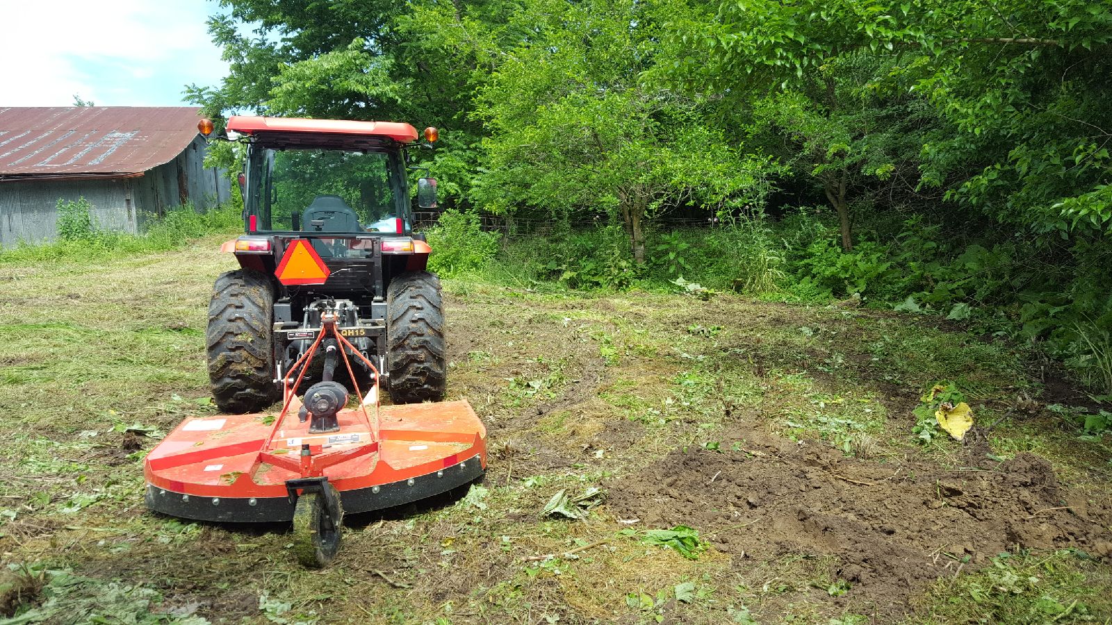

I'm on 20 steep acres. The avg slope is 33% from top to bottom, but it's flatter around the house and barn so it's steeper elsewhere. About half woods and half mixed brush and trees. Most of the woods part is too steep to operate on even if it wasn't wooded but there's a road that cuts across it.
My first tractor was a Kubota B7100. I set the wheels as wide as they go and it was tippy even though it's a small 17hp tractor. For my second tractor I got a Branson 3725 with several modifications for slope duty: slightly smaller diameter wheels and tires from a different Branson model, 2" spacers (these wheels are not adjustable), and rear tires filled with Rimguard. Bransons come with R4s so I did not have to change that. The smaller tires lower the tractor an inch or so which lowers the center of gravity and makes it more stable. With the spacers and 18 psi in the rear tires the outside tire bulge to bulge is 72". The tread track is 70".
I don't operate in the woods but I do on the rest, where it's not too steep or the brush too thick. While the wider wheels and lower chassis are a compromise, I feel that they were right for my situation.

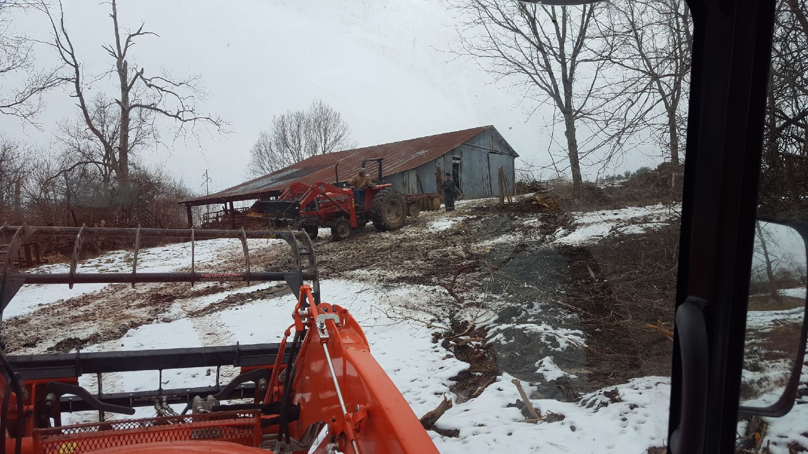

Interesting situation... I have a L3301 and an MX 5100. They are two totally different machines. I live in the foothills of the Blue Ridge mountains on 95 acres, mostly woods, where I have "hollers" that drop 100 ft and "ridges" that I drive along. I have built trails to transverse certain areas, but some are just too steep. My MX is my favorite for most tasks here as it is wider, heavier, and just feels better. I loaded the tires AND put 400lbs of weights on the tires, AND almost always have an implement on the back. I also use it to plow my driveway that is 1/2 mile and path clearing with a box blade or a landscape rake. I LOVE MY MX. The 3301 I use primarily at my farm property of 55 acres of nice, rolling hills and pastures. It also has loaded tires and wheel weights. It seems a bit "tippier" than the MX, but still stable if I'm not stupid. I never mow or bush hog sideways cause I don't like the feel. Both of mine are gear drive, which I prefer to hst. The MX is much heavier, twice the size, and more $. If I had one to choose, the MX for sure. You always need more tractor!
