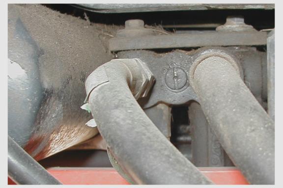

Just replaced the GTS clutch pack and the 3 point does not work, also the PTO stayes in gauged all the time this is a non independent PTO set up. All the hydraulic lines are hard lines and can not b crossed only fit one way. I spec i can figger how the PTO got out of whack and will look into it. I hope I don't have to remove the PTO one way clutch cam cause i would have to remove the trans again. I did not have the PTO clutch out of the mid section. I do have right many spectators and the PTO leave may have been engaged while i had the trans out and the shift leave got out of place. The trans and GST work great, the power steering works great. Both use the hydraulic pump off the engine as the rear hydraulics do.
I spec that I do not have hydraulic pressure to the lift cover. I do see a pix of a book with a hand point'n to the book on the line that goes from the front hydraulic block fit'n to the lift cover. I have looked in the repair manual but have yet figgerd out what it is in reference to. I have removed the banjo bolt their and the other banjo bolt at the other line on the hydraulic block hope'n the bolts were different but a NO GO. I see no reference to a check valve or pressure relief valve at this connection. I take it the pix of a book is a warring but can not find it in the kubota repair manual. Wondering if this system need bleed'n and if so how, thanks

Went and washed my b utt and came back and read the repair manual, never found enny info bout the hydraulics not work'n. Went to the symbols in the owners manual and its said read the owners manual so re read it and found that the hydraulic type block outlet for the loader has a screw, turn when the loader izz on on it one way and thurn another way when off, U mutta &!$%#, turned it and the 3 point werks only took 5 hours to figger it out so on to my goof up on the pto after i lock to door and git a good nights sleep. Dag burn tink has a loader and the loader is off. I musta never checked the 3 point last time i had it split. I have turned a small field with my N with a disk plow so gonna use it to disk it up soon as I fix the pto. I could not see were the PTO and 3 point were related so focus on the 3 point.

I did not see your post until after you found the ‘selector’… it should look like the attached pic with the loader on… and turned horizontal with the loader removed… don’t know what to say about the PTO… my L4200 is independent with a hydraulic clutch.
How bad was the GST clutch pack replacement??
Good luck with the PTO problem. KennyV.
