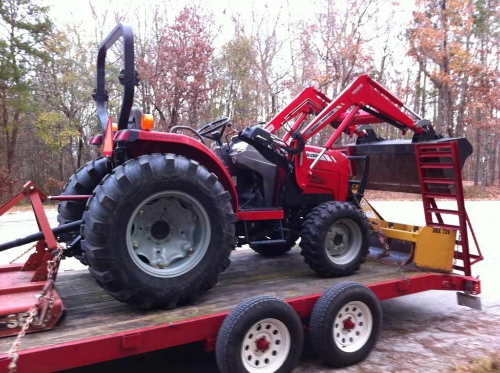

After riding both and operating various equipment with both I went with the 2006 MF 1533 over the 2011 Kubota L3200.
The price was the big factor ($2,500 difference) as well as the fact that I ended up buying the MF from a co-worker that I trust and that will help me along when I'm getting started. Neither of us realized we knew each other until we exchanged a few emails....making the purchase go even smooter.
For anyone price checking, the 2006 MF 1533 4wd with Sychro Shuttle was in very good shape and lightly used over the last five years...mainly for brush cutting and maintaing a gravel road. The machine has 400 hours, a 5 foot Rhino brush cutter, a 5 foot Rhino finishing mover, a 5 foot Bush Hog brand box scrape, a 6" and 10" auger, and a 18 foot trailer. I got it all for $14,500 and I think a got a very good deal!!
I'll start brush cutting my property and developing and maintaining the trail around my 12 acre lake after the Holidays...more photos to follow.
http://i672.photobucket.com/albums/vv86/obobser/1b34fc78.jpg

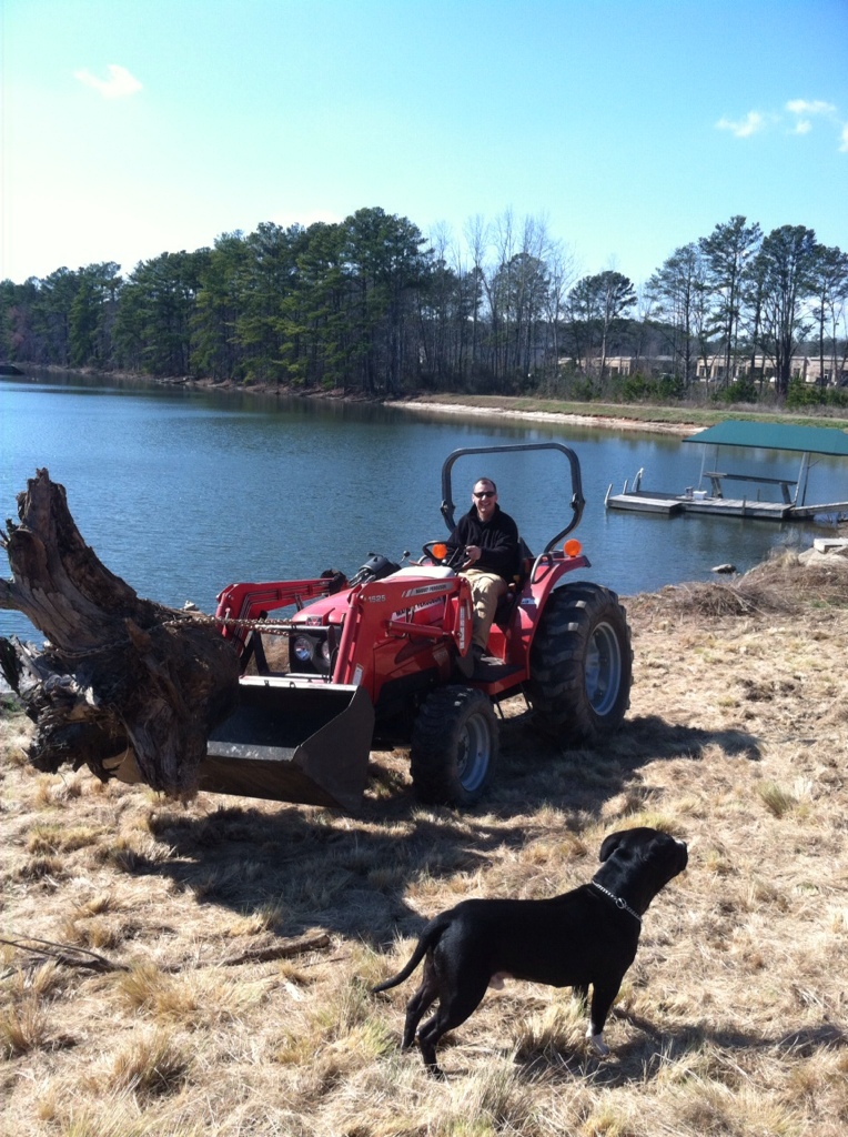

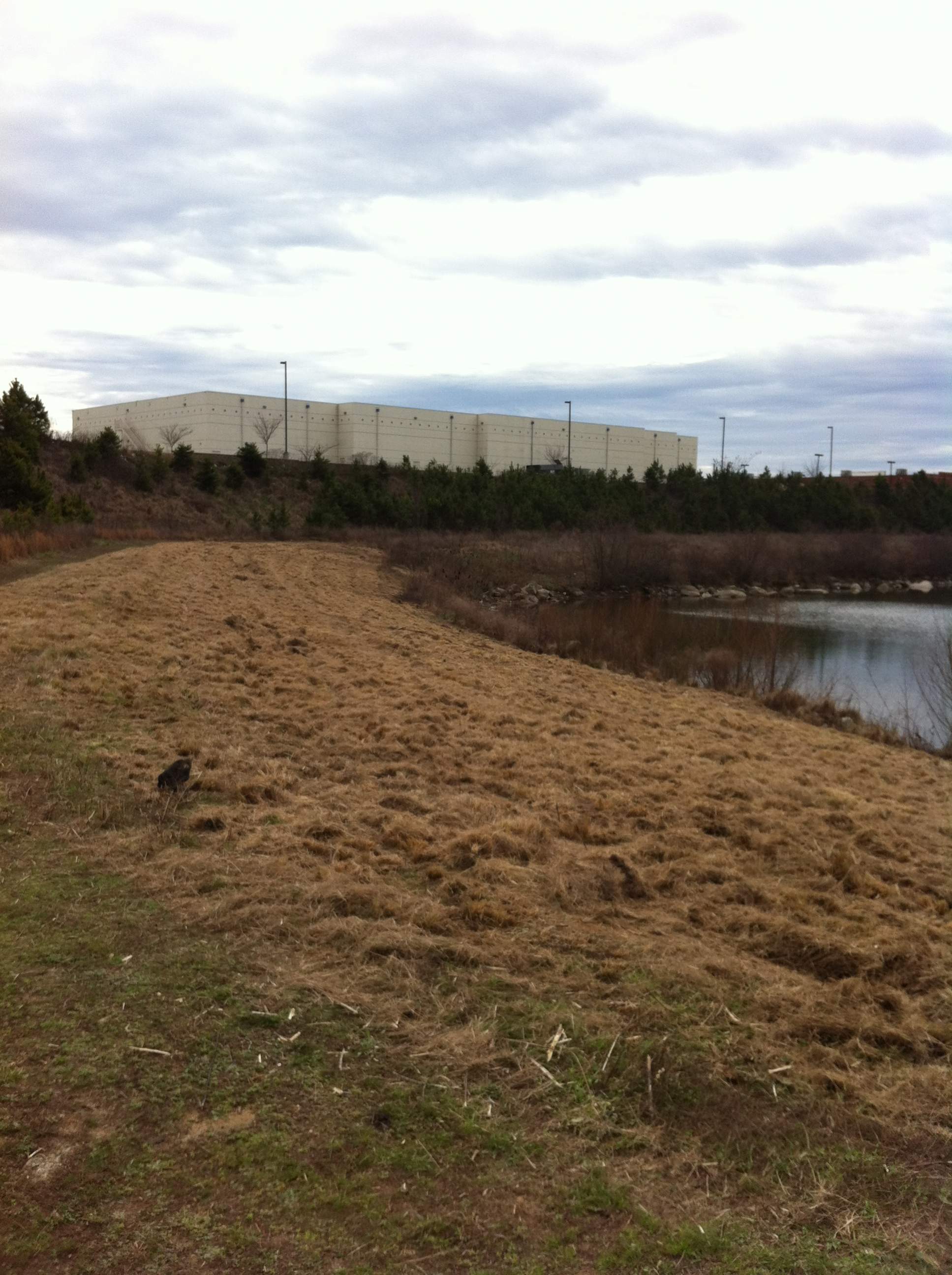

Well it's been a while since I asked what tractor to buy and finally taking the plunge. With the warm weather I've put more than a few hours on my Massey 1533 over the last few weeks.

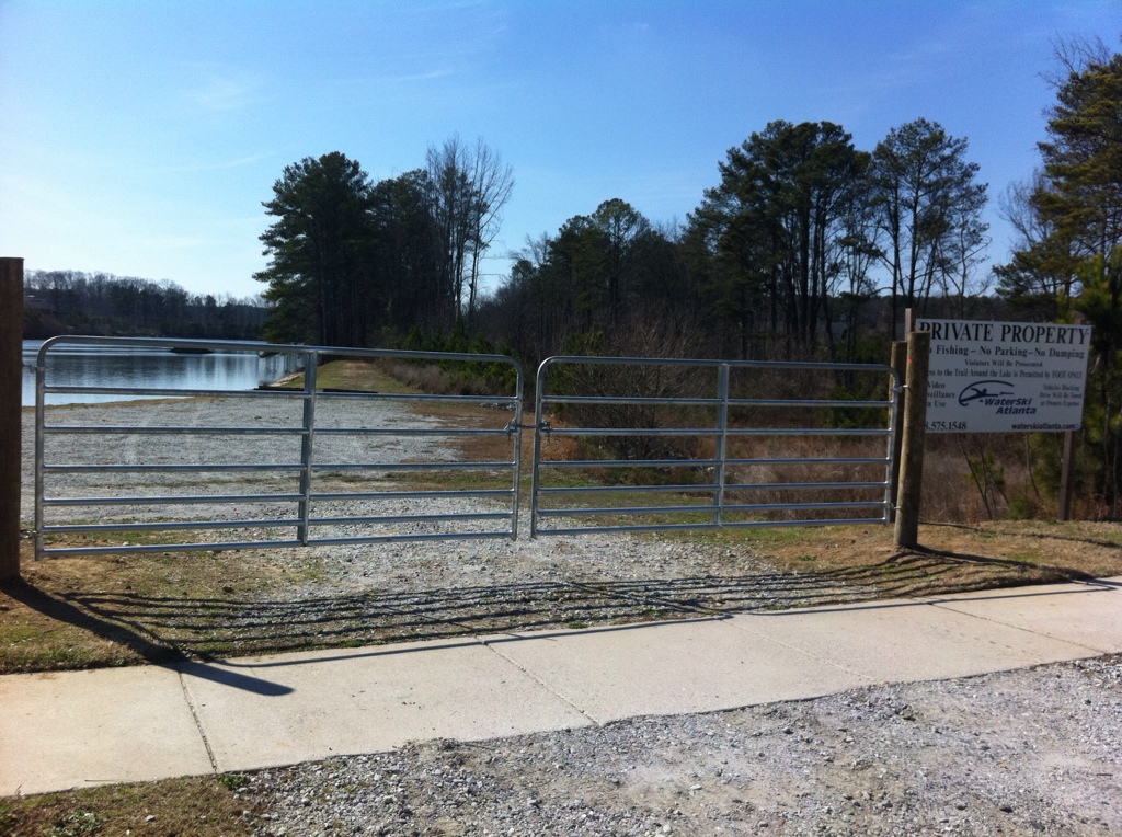

Cut about 8 acres of land with over 10' high brush and small trees. Scraped a 12 acre pond shoreline after lowering the water a few feet, installed a entrance gate with the post hole digger that came with it, and basically just cleaning up my property.
Here is a few shots of the tractor at work...couldn't be happier!!

Your lake is beautiful. :thumbsup: I'm sure that you will enjoy the 1533. ;)

Thanks Brian. It was dammed up in the '50's and is spring fed. It gets a lot of runoff now from the surrounding commercial properties, which includes trash, but it's my little slice of heaven close to the city.
Thanks for you're advice earlier too. Trail work will start soon....as soon as I have the funds for the materials.
