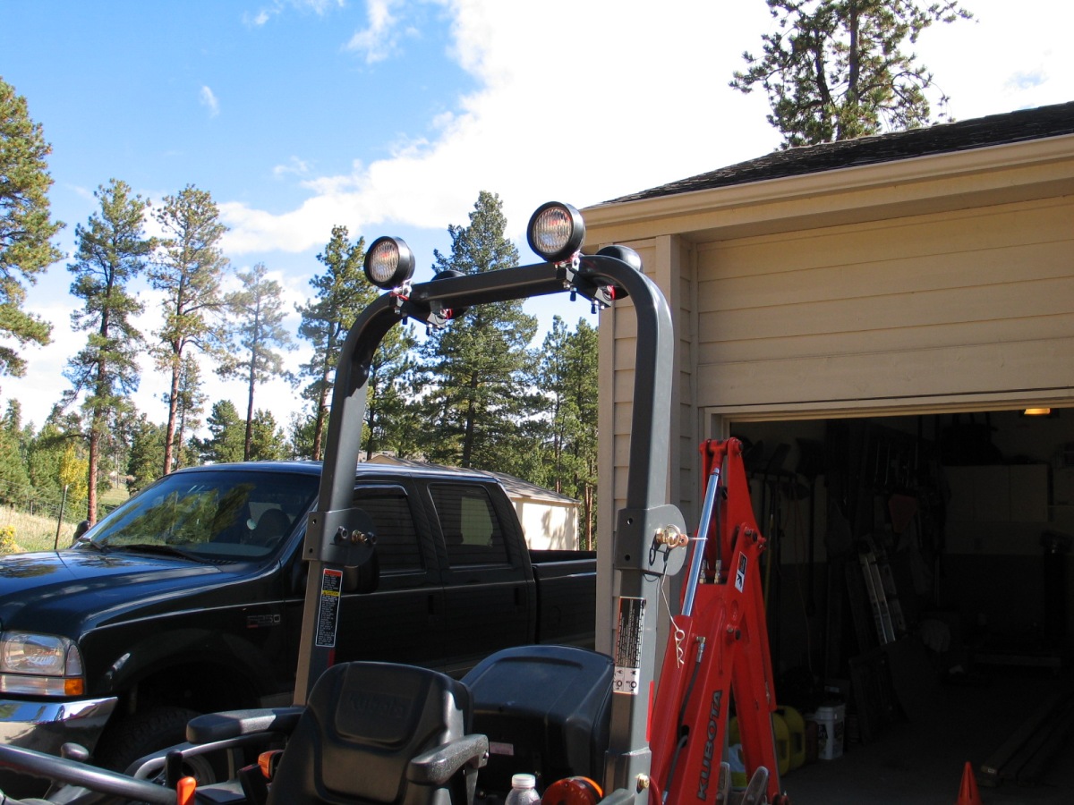

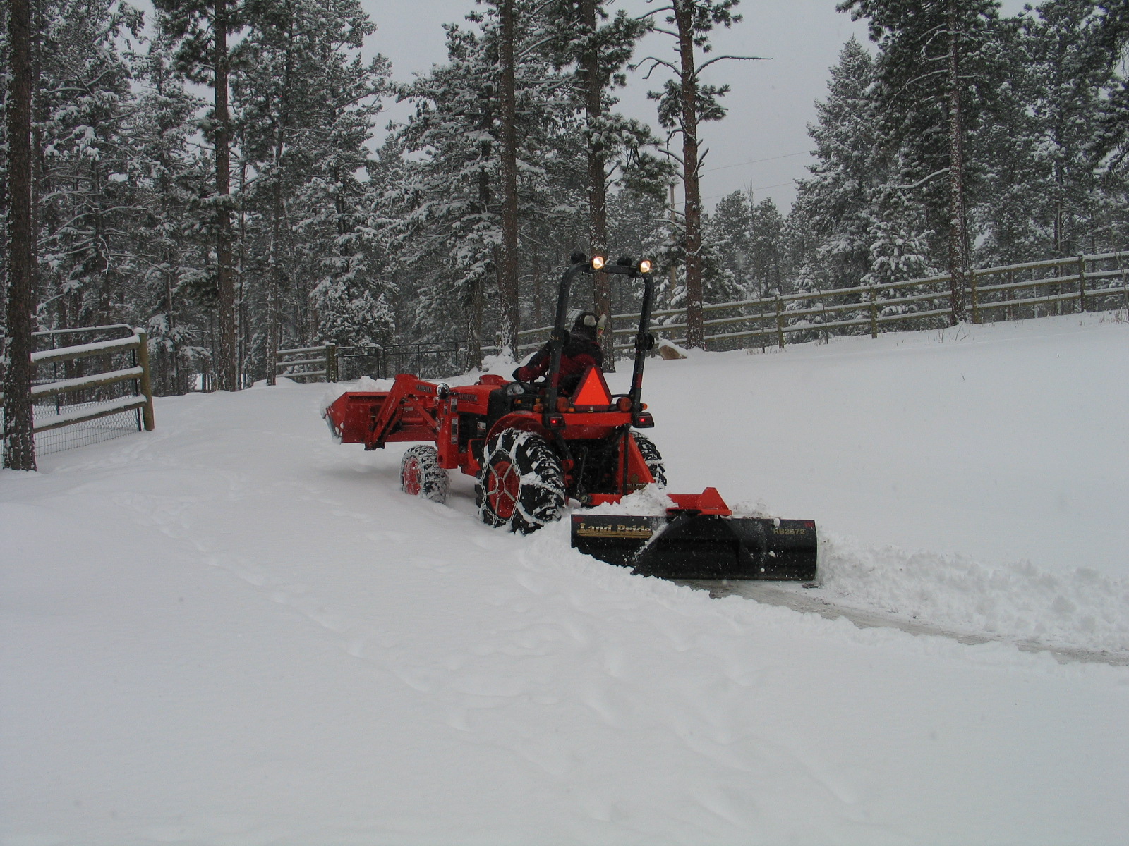

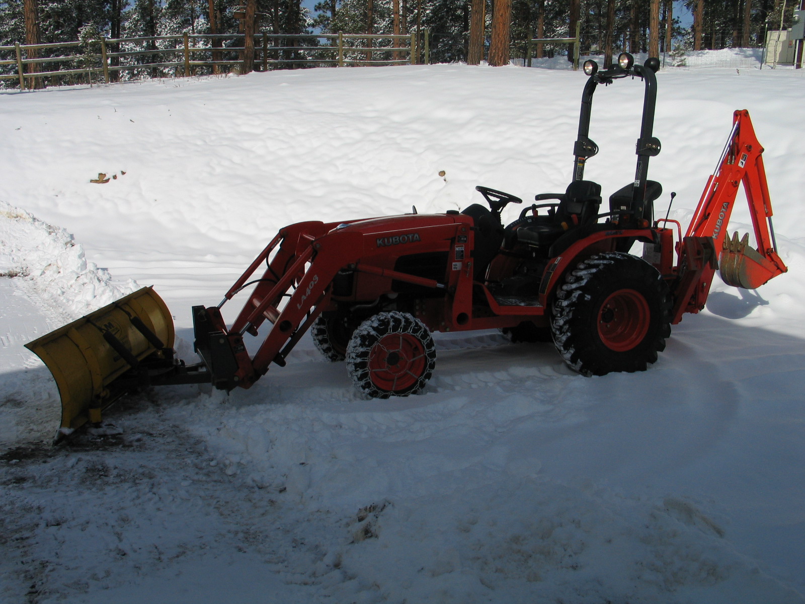

Here are my front & rear ROPS lights. I put them on mostly for snow plowing in the dark (they throw some serious light), but they also work great for lighting up the bottom of the hole when doing backhoe work, especially when the bright sun is lighting up the surrounding ground above the hole.
They're just the cheapo 55w halogen sealed units from Harbor Freight, but you can get to the bulbs to change them. The black portion is rubber that the unit and lens snaps into. Even if you need to swap out a whole new unit, they're cheap enough and regularly go on sale.
Sorry, not sure what you have for a power source, but the standard on the B3030 is a 'dynamo', so I had the dealer install the optional more powerful alternator. I think you could probably just get away with moving the one light you already have up higher and adding another with the current generator. However the one light might do the trick for backhoe work.
