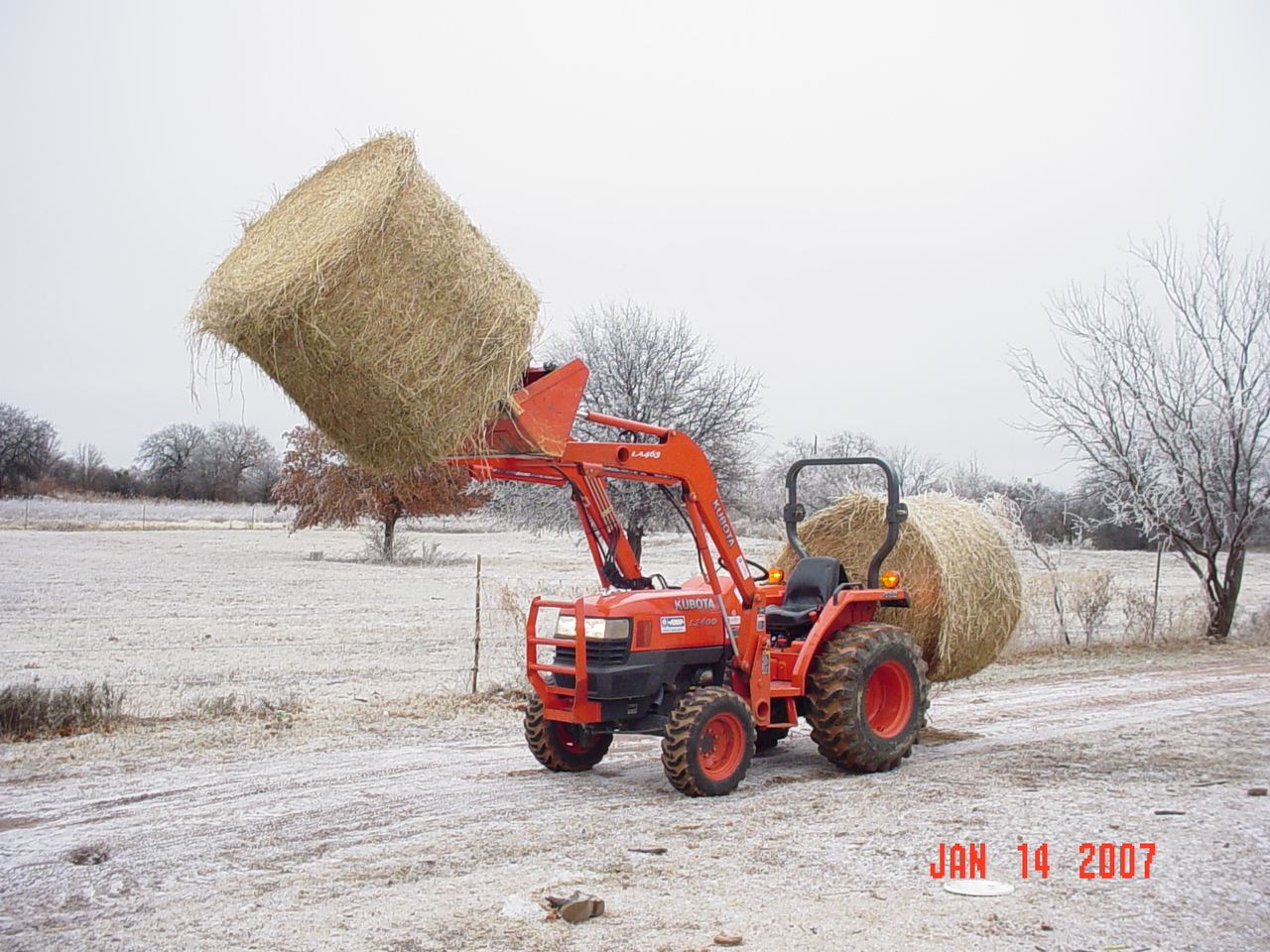

I think you have figured out what the deal is but I still have to post this picture just because "people" said that "that little thing cant do it"

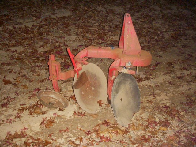

Thanks for the pics. Now for another question related to the first. How much does this plow weigh approx? The reason I ask is that I had to pick it up with the forks this morning and I could not lift it over 4ft high and that was going about 1 inch per minute at about 2500 rpms. It would curl easily but upward motion barely would do it.
