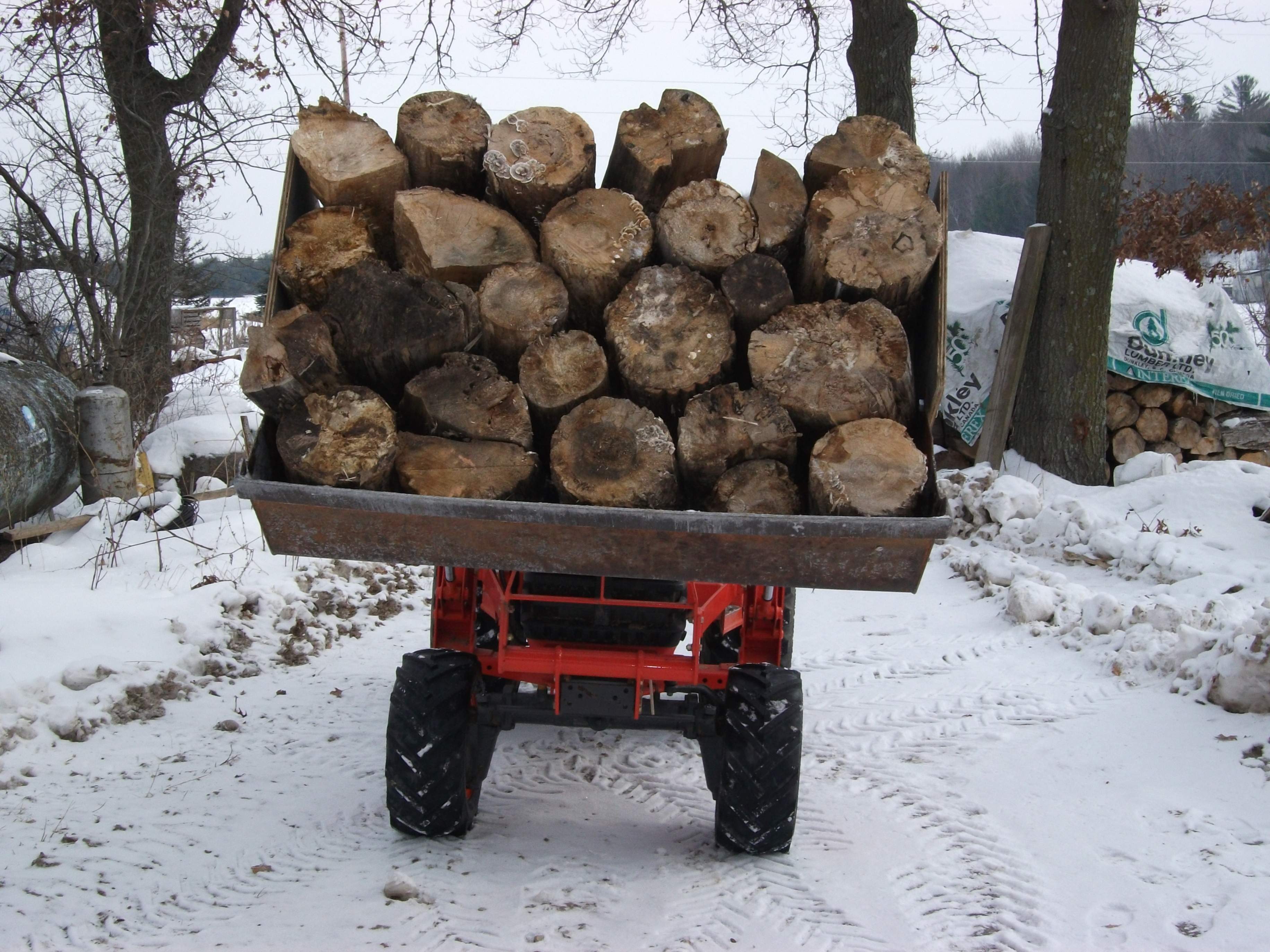

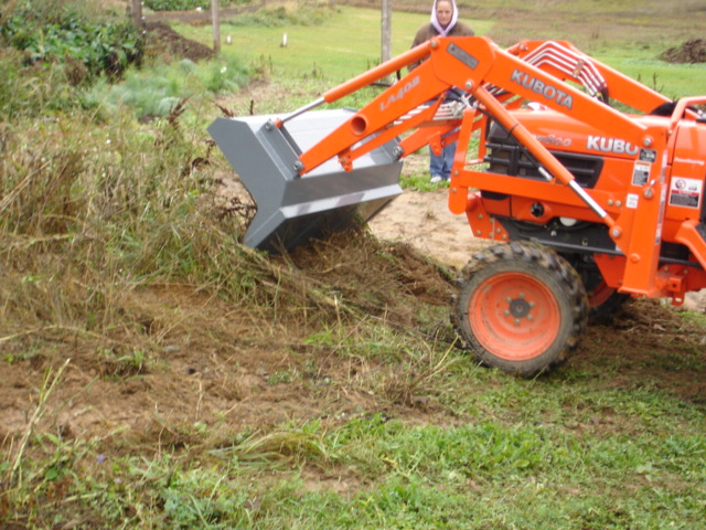

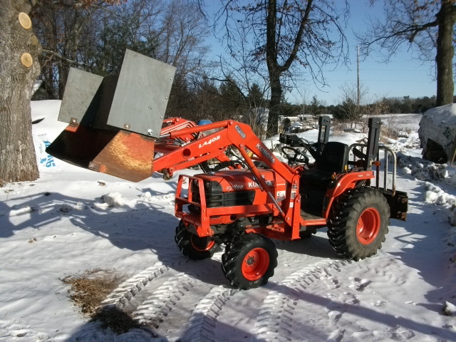

I personally prefer a smaller bucket except for in the winter. A smaller bucket allows easier digging. A wider bucket restricts your visibility. Seldom have I seen anyone get a full bucket in one pass unless they are digging in a loose sandpile or equivalent. If all you are going to do is load loose material, by all means get the biggest bucket you can. Thinking outside the box, a loader can be used in many ways as many here can attest to. When I got my B7800 w/LA402 loader I opted for the 54" bucket. It will probably seldom be used and sold with the tractor when that time comes. I got a mangled up 5' bucket also to alter with a few specific uses in mind. But I prefer to keep my 4' Loader Buddy on for the majority of the time as it allows a more surgical approach to what ever material I am encountering. I garden, work in the woods, and use my tractors often in my everyday work-life. For me I would rather have a "swiss army knife" on my loader instead of changing attachments for every chore.
