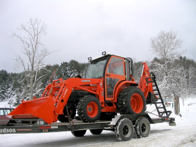

Hi...
As requested... here's a link to some pictures of my new Kubota L3130
There's 1 picture in the Attachment of this post too...
I spent time marking things on the tractor with white & yellow paint pens to make 'em easier to find...
...things like engine oil & hydraulic oil drainplugs... dipsticks... fluid fill points... 3-point-hitch parts... etc...
Anyone else do this ? /forums/images/graemlins/confused.gif
Also closed up un-needed openings into the cab with weatherstripping tape to make it a little more airtight for the heater....
The Curtis cab roof has about 8-10 bolts that penetrate it... There's plastic washers under the rounded bolt heads to supposedly prevent water from entering...
As an extra precaution... I used bottle caps... sprayed oil on 'em to prevent silicone caulk from sticking... filled 'em with clear silicone caulk... then placed the filled caps over the bolt heads to seal all around 'em... hopefully the caps will come of off the silicone and leave nice silicone seals...
Next... I'm gonna add to 2 LED side marker lights to the lower front sides of the tractor... wired into the brake light wire so they are on when the lights are turned on...
Hope I get a chance to wax the tractor soon... already washed it after the sandy/salty road trip home from the dealer's...
Only missing part is the rear window wiper... should show up soon...
...oh... maybe I'll add a radio at some point... but don't wanna drown out the sweet diesel sound !
Dave...

Nothing better for the soul and the mind then a new toy! looking good Dave!

That is a nice looking machine. Now go move snow!

Wow Dave
That is an impressive setup. I have a trailer similar to yours except with the gooseneck hitch. The other day I went to load up my M9000 for its 50hr service and it wouldn’t fit between the wheel wells. Tomorrow I’m going to look at deck over wheels gooseneck trailer. Hopefully the owner and I can come to an agreement. It looks like your tractor is also a snug fit. At least it will work I had to use the neighbors trailer.
Thanks for the pictures.

Trailer/tractor... yep... snug fit between the fenders... about 6" extra on each side...
A nice feature on this trailer... the 6' ladder ramps are kinda heavy... the manufacturer put a large coil spring on 'em to make 'em EZ to lower/lift...
Good luck with your trailer search...

Great looking rig! A lot of people would think I'm nuts, but, as an expatriate from the North, all that snow has me kind of jealous. Enjoy your new 3130! How do you like the Curtis cab?
