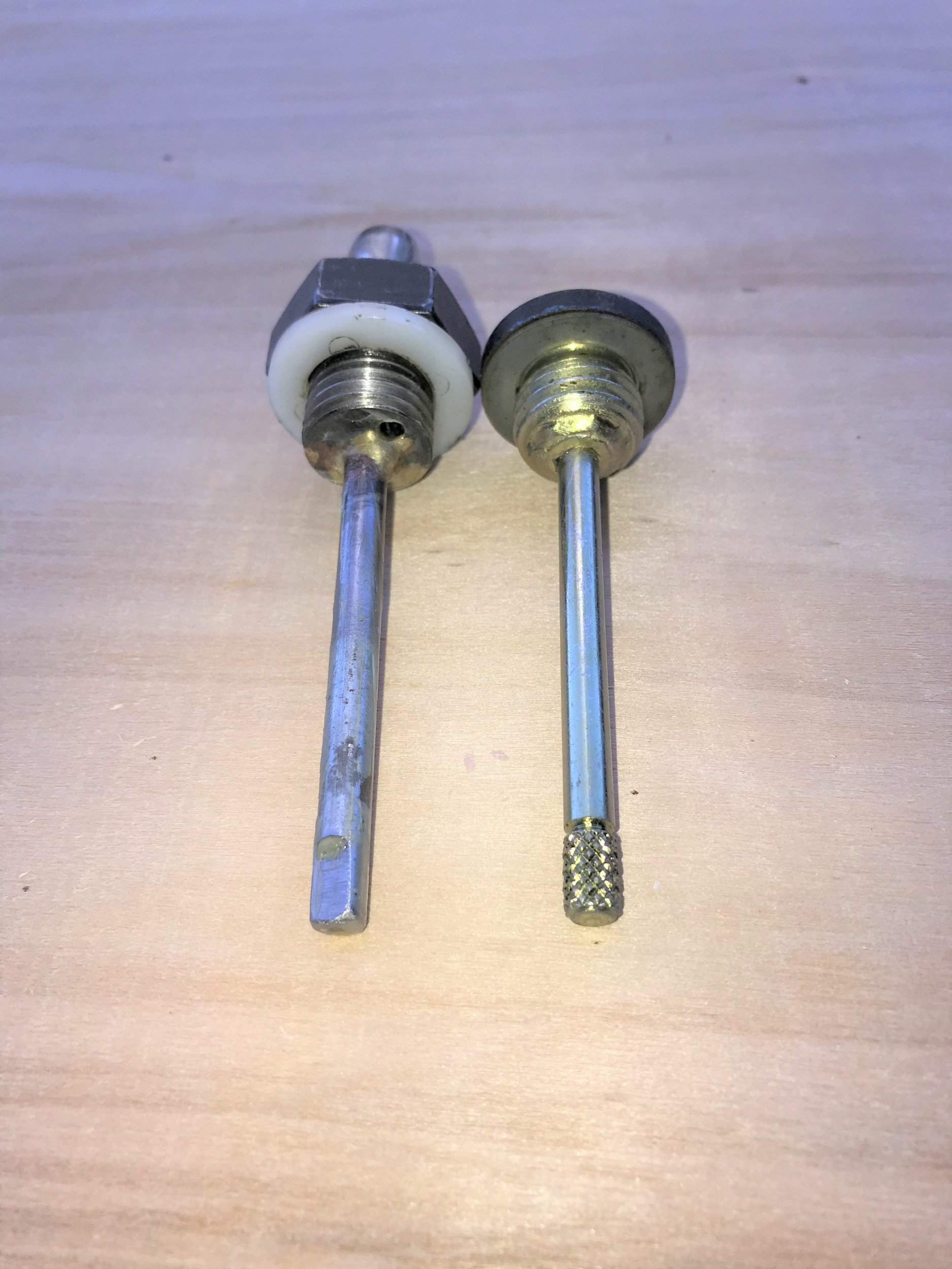

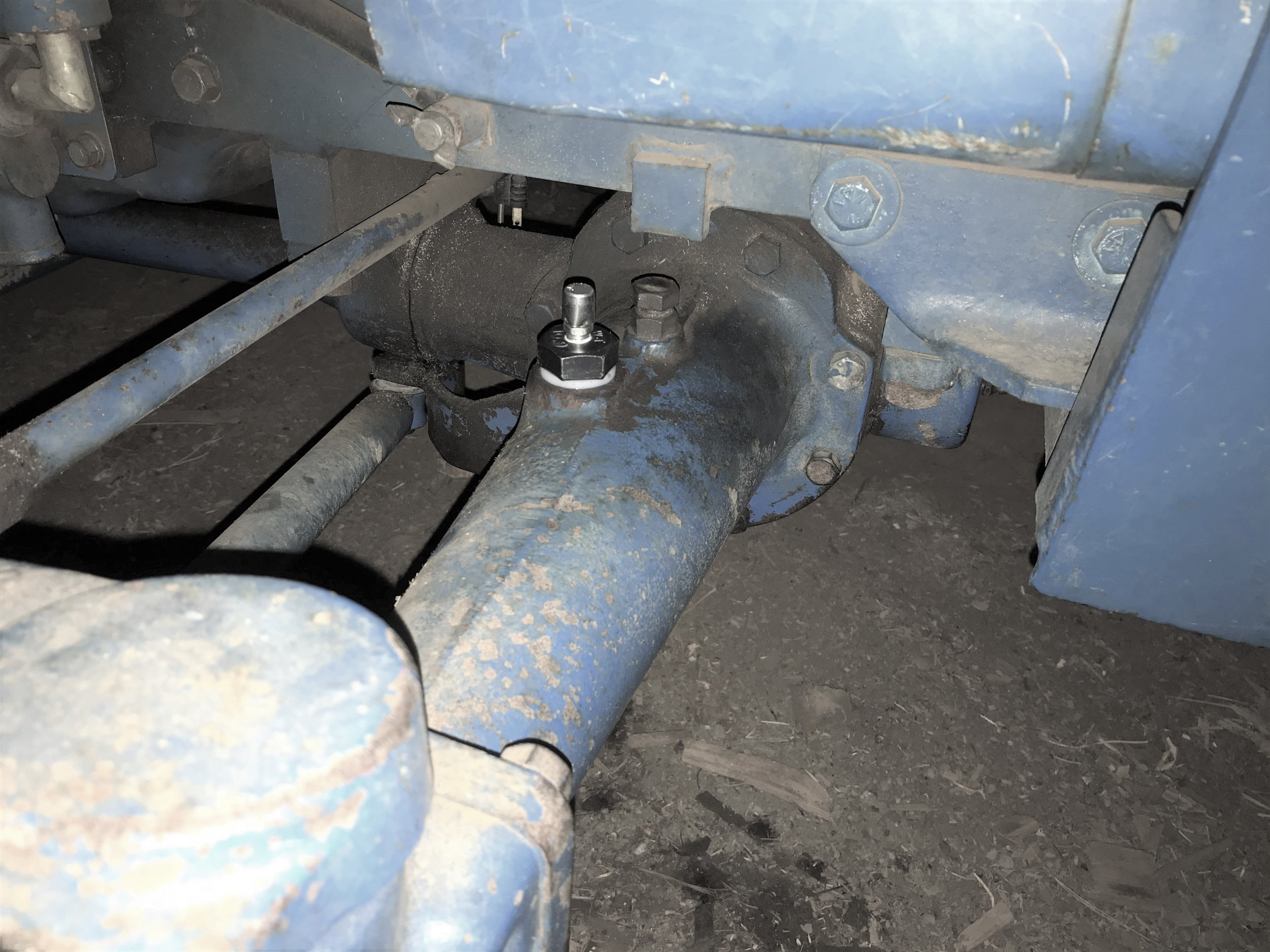

Please see a post I wrote last summer about my Ford 1310 regarding vented axle VS. no vent.
Ford 1310 Front Axle - Type of Oil
Below is a photo of a new vented dipstick I made last summer.
The vent is a John Deere item JD5801 which is a "one way vent" or a pressure relief valve.
I have also switched the front axle from 134 oil to 80W-90 gear oil, but have not yet replaced the seal that was leaking earlier since there are no leaks now!
Here is the new dipstick side by side with the original:
PS. The photo is deceiving, they are actually the exact same length when inserted!
JD 5801
So far so good, but I suspect I will need to replace the seal in question anyway one of these days.
