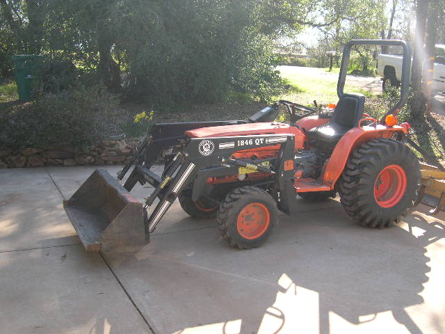

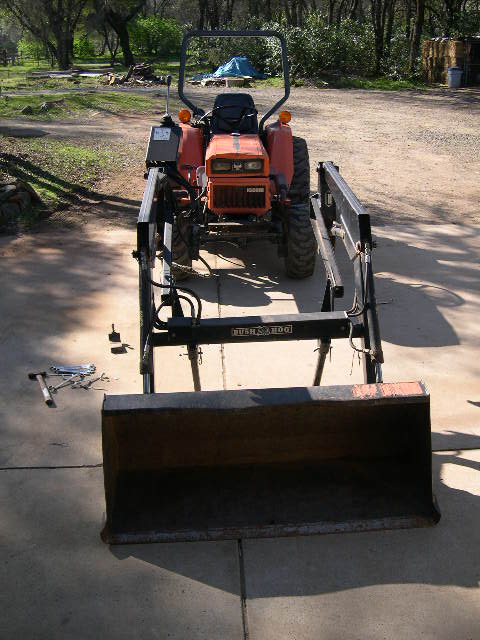

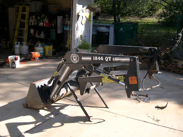

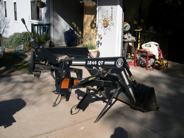

Your tractor was '90-'93. Guessing Kubota does make make a loader specifically for it anymore. When I had my B8200('86), and was looking for a loader in '2000, the local Kubota dealer said there was no longer a loader for it. They could however, use the loader from another "B" series, but would have to cut/weld/drill the loader mount and make it work. 12 years ago, that was $3200, for a smaller loader than your tractor would use.
I went with a Bushhog loader, which a local independent shop carried. Bushhog had correct mounting hardware that fit my tractor. I used that loader for 10 years; it worked great. Again though, 10 years ago that was $3100 installed...

My old Bushhog did require a wrench to remove two nuts. I only took a few minutes. These pictures are the old Kubota with loader on, and off. All the extra wrenches in the picture were from other maintenance I was doing... The new owner, has not removed the loader in the 2.5 years he has had it; just never had the need.
