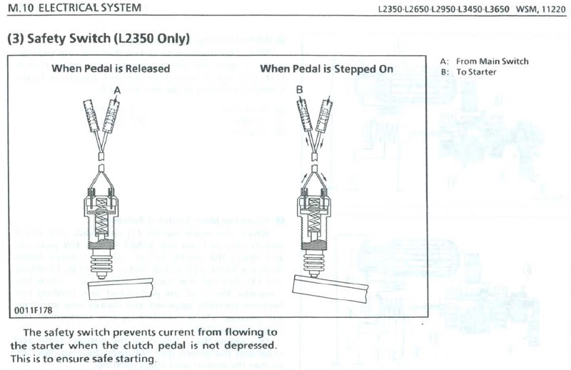

   / Kubota L2350 will not turn over #3
My L2250 won't turn over unless the clutch is fully depressed.
   / Kubota L2350 will not turn over #4
Make sure the safety switch under the seat is not the issue. Once mine failed to turn over and simply raising and lowering the seat was all that was needed.
   / Kubota L2350 will not turn over #5
Your tractor is a very simple one when it comes to safety and starting.
If there is the presence of electrical power, i.e. lights working, then likely it involves this one safety switch.
There is only one safety switch involved, no complicated Operator Presence Controller.
