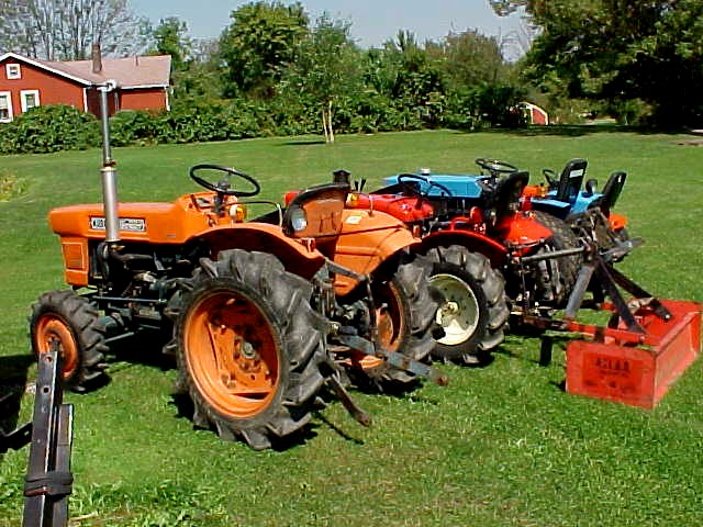

Does it have the "check chains"? I had an L2201DT for a few years. Very tough little tractor. Never had an issue with an implement hitting the tires if the side sway chains were adjusted properly. Rear tires should be adjusted to their widest position also. Do you have a photo of the rear we can see?
The L2201 does not have a built in over run clutch so you should get one if you don't have one already.

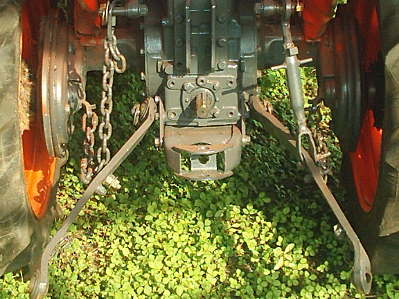

Here is a picture of the back of the tractor.
   / kubota L2201 why bush hog hits tires #4
OK.
Looks like someone changed the "check chains". There should be an adjustable tunbuckle that allows you to shorten the chain , hense, limiting the side to side sway. Look on E-Bay, there are vendors there that sell check chains with the turnbuckle.
Also, you do not have the over-run clutch (PTO). It would be in your best interest to get one, only about $50.

You can also reverse the attaching pins on the mower so the 3 point arms will be farther inboard.
Eugene
   / kubota L2201 why bush hog hits tires #10
With chains to prevent or limit the amount of sway your left chain prevents it swinging too far to the right tire and the right chain into the left tire.
It is obvious someone has changed out some items on the 3pth life arms to chains and probably have them too long. At same time if you use an implement wider than it is set for this will happen. If you have a draw bar for this tractor measure the length (width in use) and them compare it to the mower. If the lift pins on the mower are mounted pointing out so the lift arms swing from the tire to them then you may be able to turn the pins around and help. You do need some side sway but not a lot. kt
