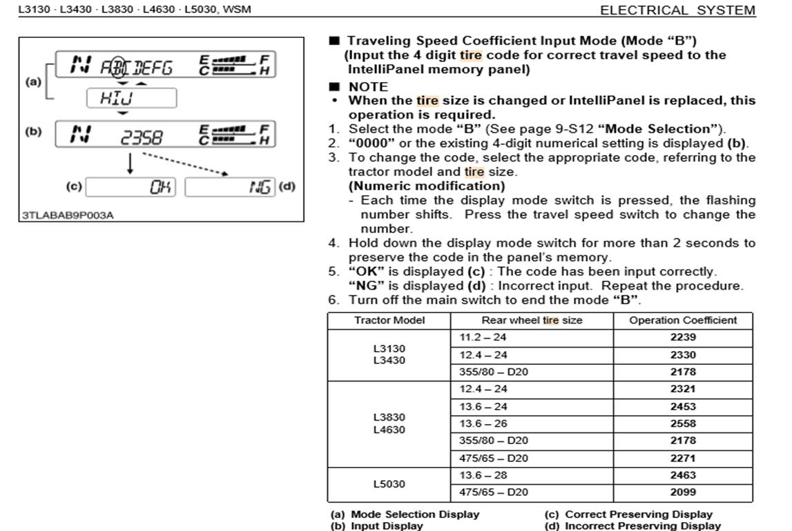

Hey guys does anyone have the information to change the computer to turff tires the dealer gave me the information and I lost it Kubota L4330 hst cab

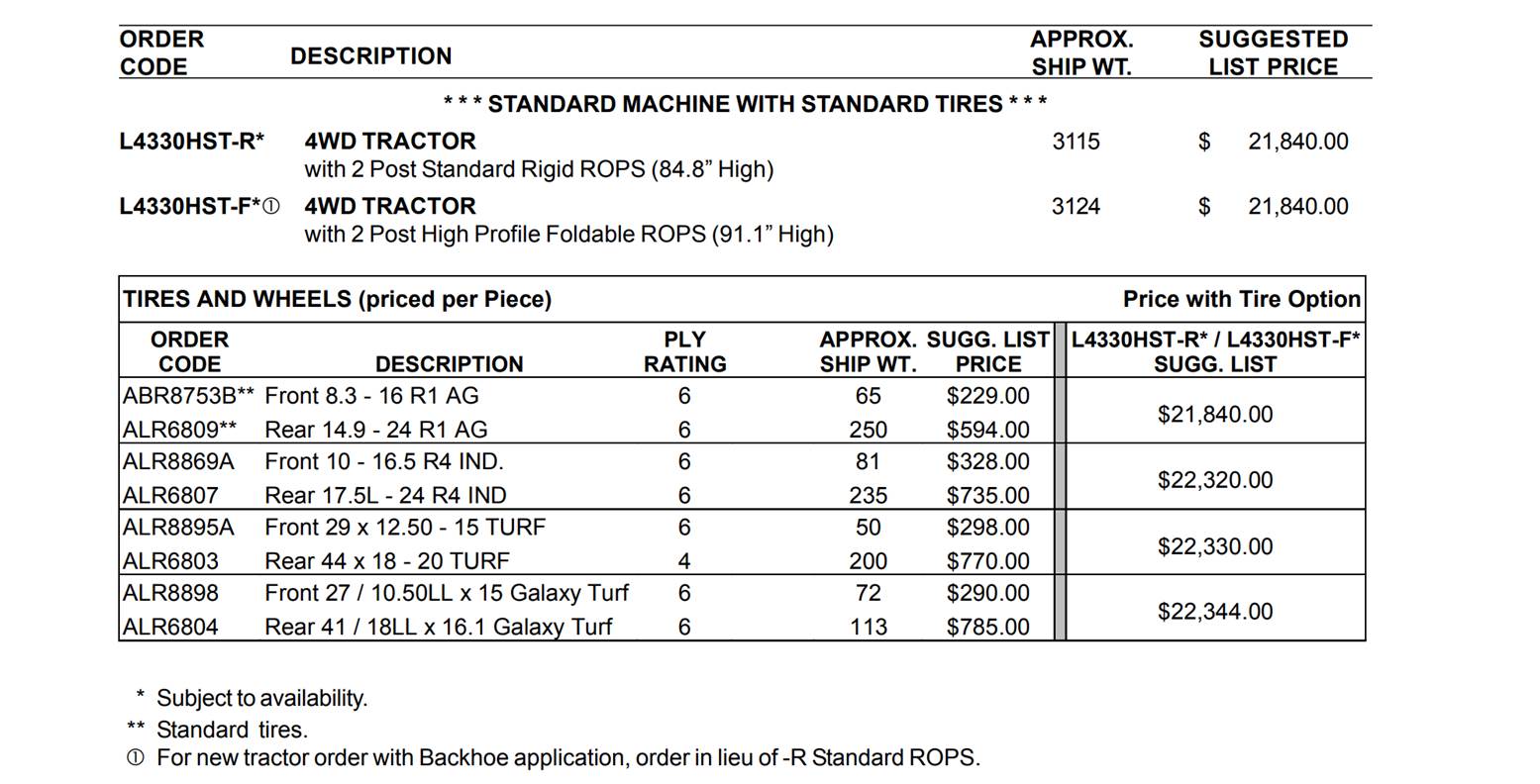

Attached is a copy of the wholegoods listing of the available tire/wheel assemblies for the L4330 dated Feb 2009.
The wholegoods order code is what can be used to check if they are still available. It might be possible for wheels/tires off a newer model to work also, but you and/or your dealer will need to investigate.

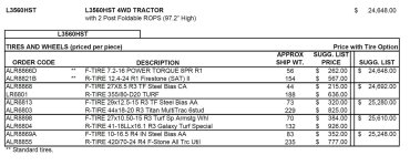

I've also included L3560 tires for reference.
Looks like these charts provide the order code and OP is looking for a computer code. I didn't realize you had to change the computer on a L4330 for turf tires. Please give more details.
   / Kubota L 4330 Need turf tires #24
Ops! My mistake on misreading the post and the need for the computer codes to update the computer so the speedometer reads correctly.
   / Kubota L 4330 Need turf tires #25
I'll try and redeem myself :D
Hopefully this is what they are looking for in Post 21.
   / Kubota L 4330 Need turf tires #26
Thanks Moship. Learned something new.
