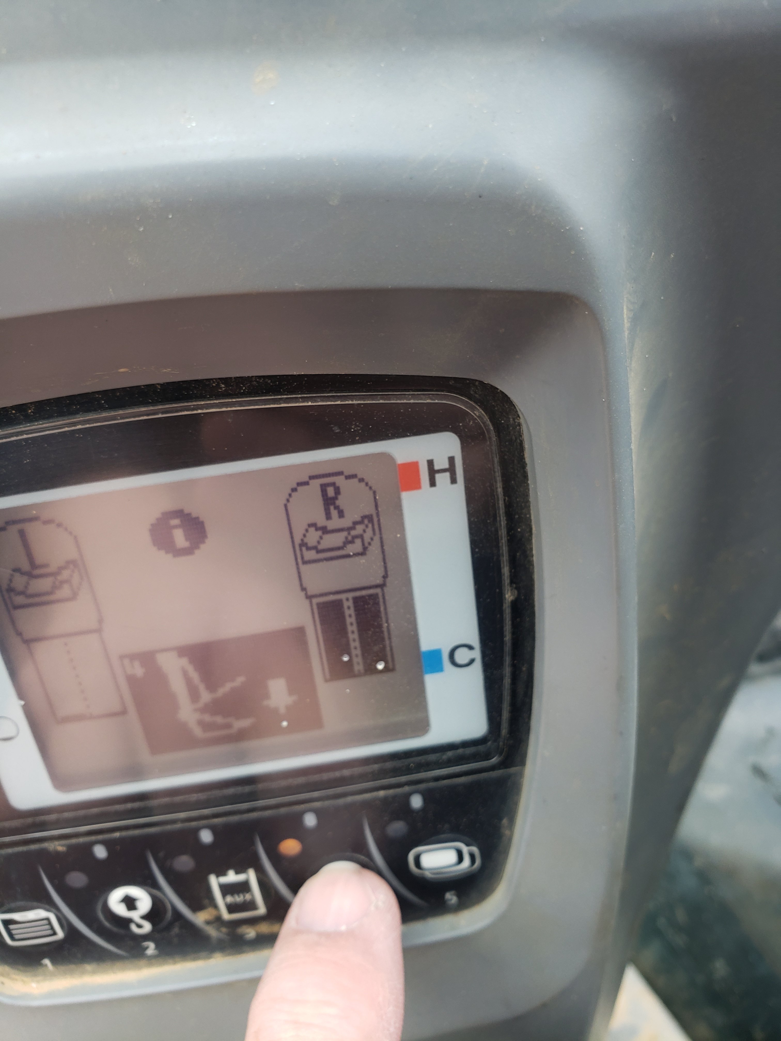

I have this error on the dash screen. Its on the right side, either track or bottom rollers? The tracks are adjusted properly per specs. Heres a pic, nothing in the manual. Does look like a cross section of the track maybe? Help appreciated

No, that is showing, because i have the thumb activated, look to the right of that. Its filled in, compared to the same on the left is not showing anything

Filled in means full flow. Blank is no flow.
That screen is in setting. An error is more like a pop up.
/ Kubota KX057 Error on Readout #5
Like Drstrangelove says, that is the settings screen for your aux hydraulics. The particular page is for the thumb only. Your right aux button is set to full flow in both directions. Your left aux button is set to zero flow in both directions.
