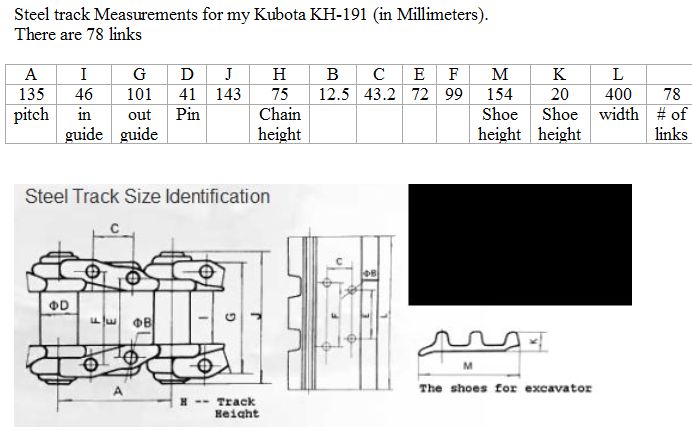

Here are the measurements I took.
Seems Kubota no longer offers the track :(
   / Kubota KH-191 excavator track questions. #10
There should be no change to the rest of the undercarrige at least there is none of the Kobelco-New Holland IHI that we sell also most of the Cat & Komatsu also check with a dealer who handles Value Part undercarriges McClaron also has rubber tracks but have had a large problem with there customer service (It sucks)
