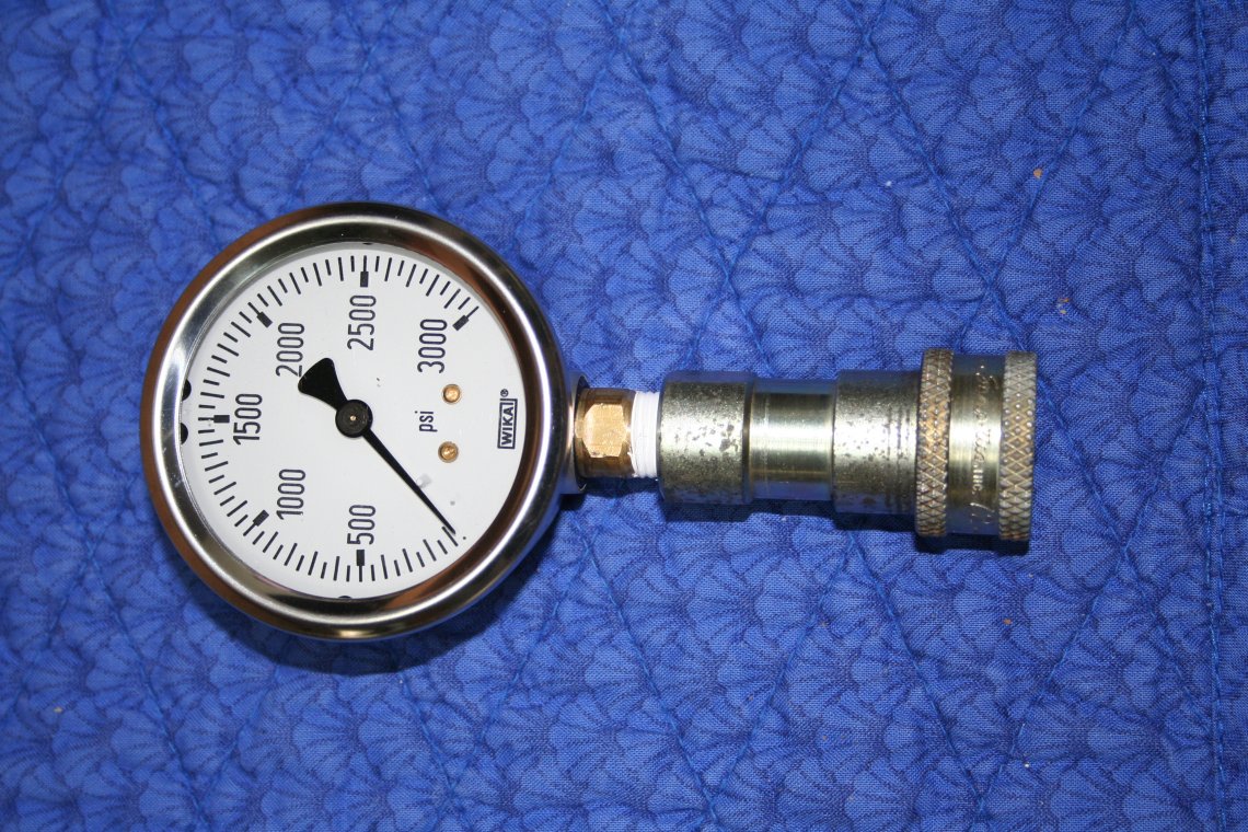

Purchase a 3000 psi hyd gage about $15 and install it in a tee at the IN port to the FEL valve, or make a QD hyd pressure checker, like these.
Do you have the cyl hose connected correctly.
