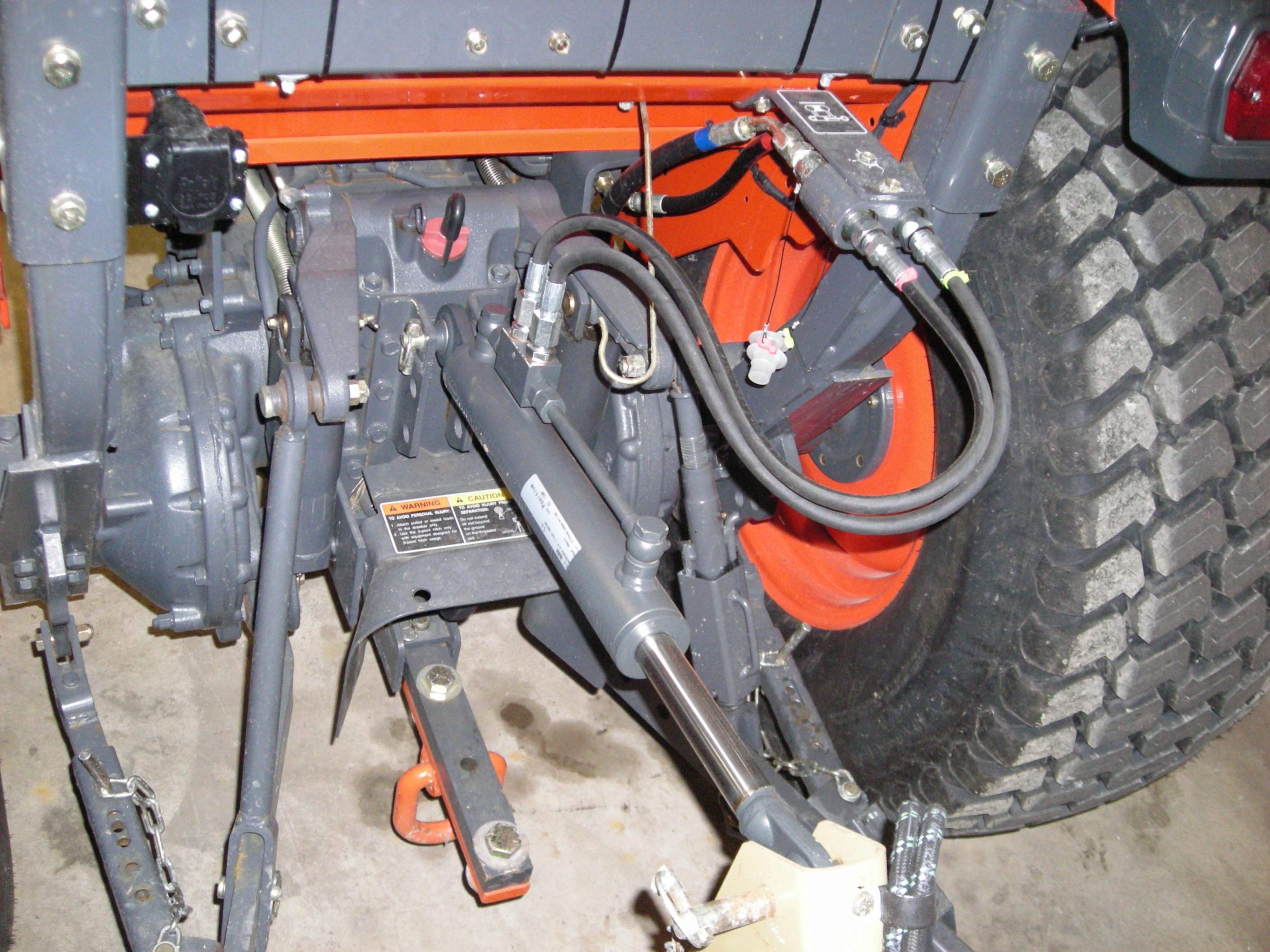

ok-newbie question on rear remotes. In this ETA pic this L3240 has 2 rear remotes- my pic with arrow. I would think that is what these are..Questions are...
1. what are these rermotes used for
2. what rear implements need remotes
3. does a hydraulic top link work off one of these remotes?
4. basically what are they a must have for??

They can be used for snowblower hydraulic chutes, hydraulic top links, hay baling equipment... and the list goes on and on.
/ Kubota Hydraulic rear remotes #3
Actually that is ONE remote, not 2. They come in pairs - One for each side of a double-acting cylinder
/ Kubota Hydraulic rear remotes #4
1 - Any thing you want ; links, implements, ect...
3 - Yes

The remotes in the pic will operate 1 double acting cylinder. Power to extend and power to retract.
You could operate a top link cylinder.
You could operate a side link cylinder.
Hook the hoses to a front grapple.
A chute rotator on a snow blower.
Log splitter? Depends

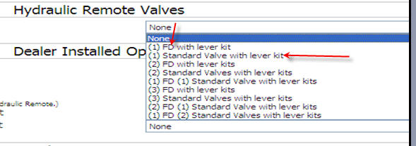

Thanks-I am understanding more and more..Looking at the Kubota site I was wondering what the differences are with the FD with lever and standard with lever kit is??? This is off the Kubota site...

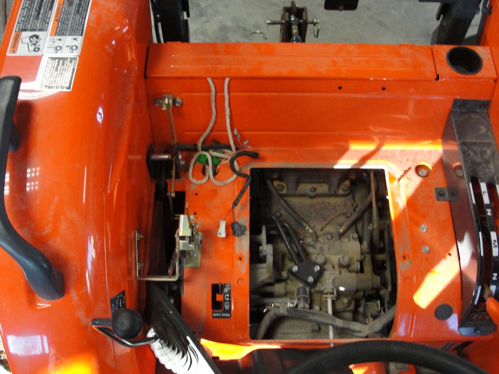

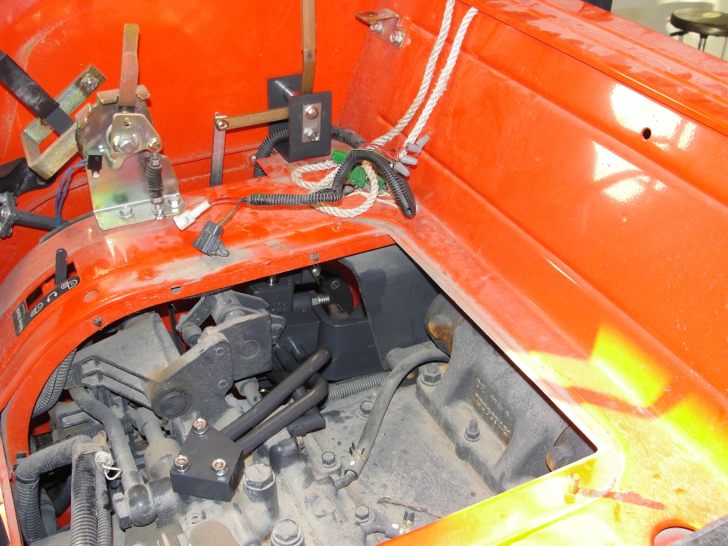

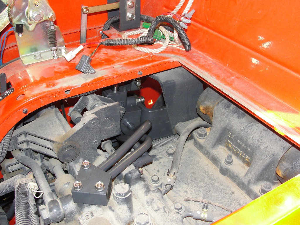

I added a single remote on my Brother's L3240. I've attached a couple pics but don't have one showing the lever with the tractor assembled. The remote lever is just behind your 3pt lift lever. There are slots in the fender assembly to add three remote levers. The hydraulic connectors at the rear of the tractor are stacked together as you add more remotes.
My Brother got his kit from the dealer he bought the tractor from, supposedly at the dealer's cost, $450. It took me about an hour to install. Had to remove the seat platform and take two bolts out of the ROP assembly. Then remove the small plate on top of the hydraulic pump unit and install the kit. Pretty simple.
Kubota is always expensive when adding their factory kits. But to get an "out of the way" setup this is pretty slick. I'm guessing he can probably add an additional remote for $300 since he wouldn't have to buy the hydraulic adapter plate, lever stand and remote connector stand again.
AndyG
The FD (float detent) valve allows you to put a cylinder in free floating mode(pushing all the way forward till it detents and stays), meaning it can extend or retract freely, it also can function as a normal valve. I got 1 float detent valve to use on the top link and it comes in handy when using the box blade or rear blade in float position it allows the blade to float with the ground and not go up and down.

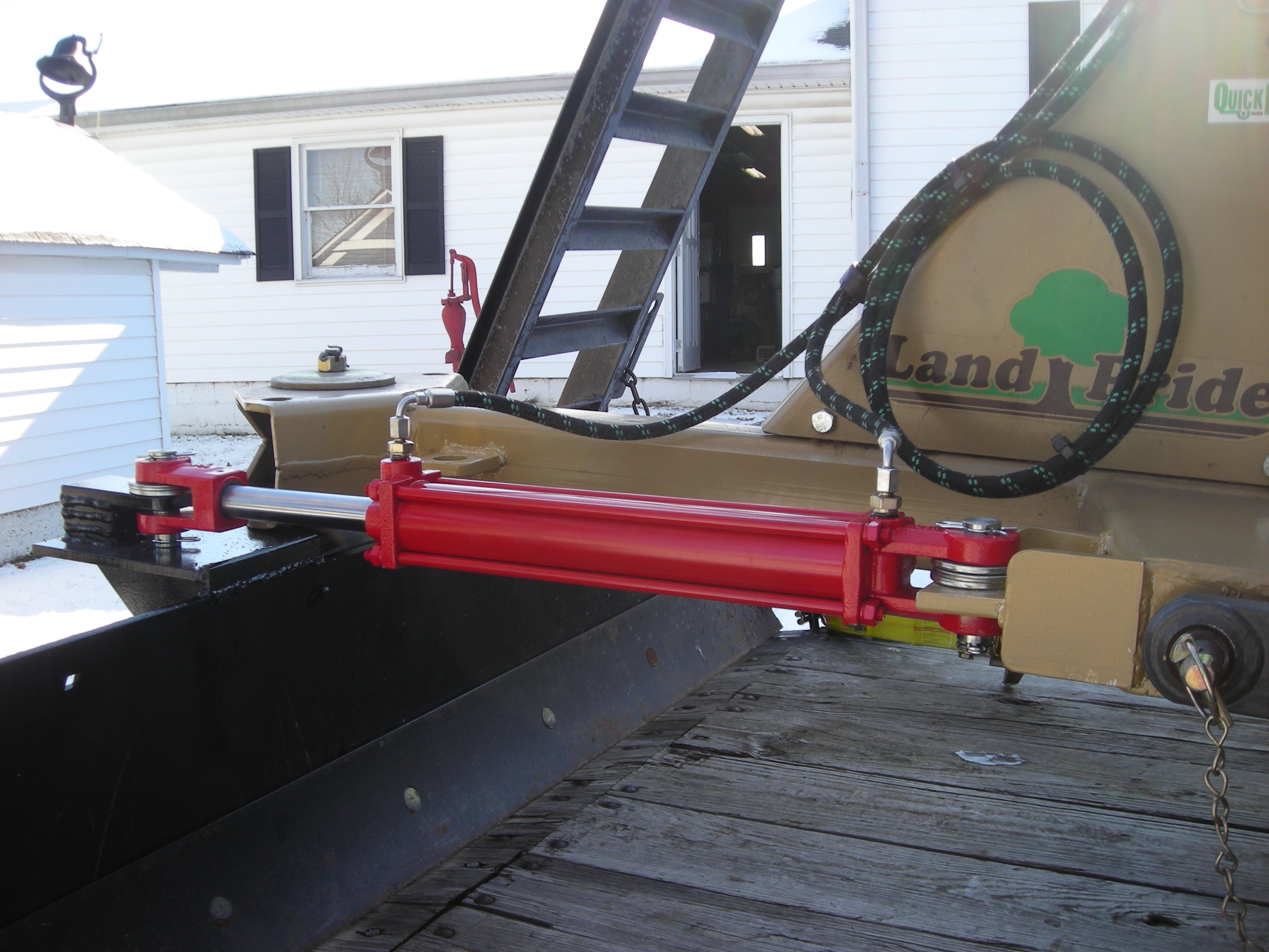

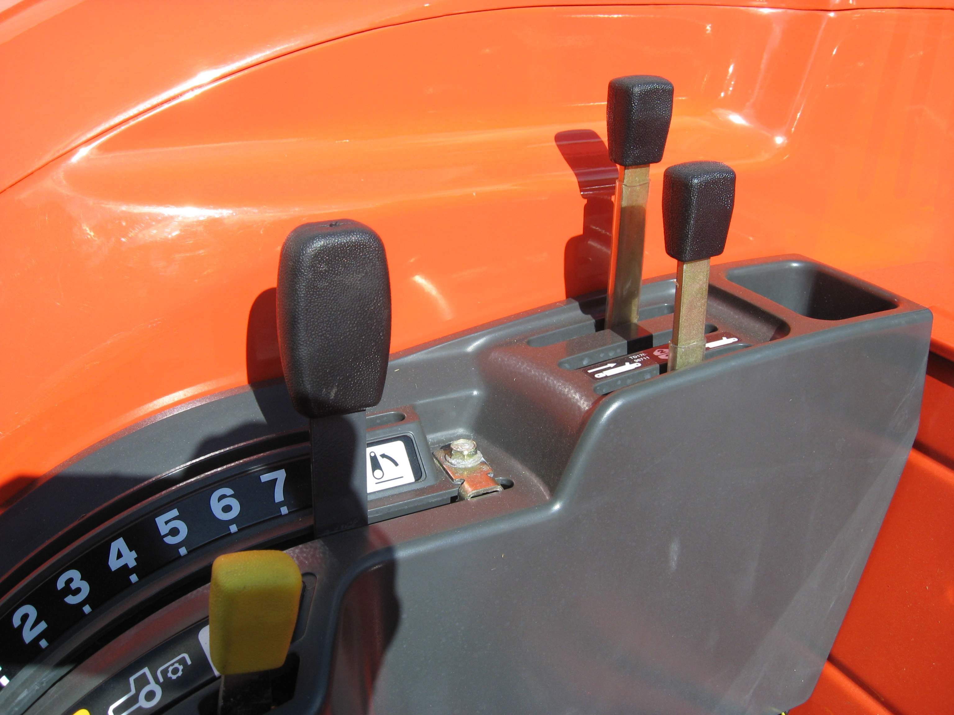

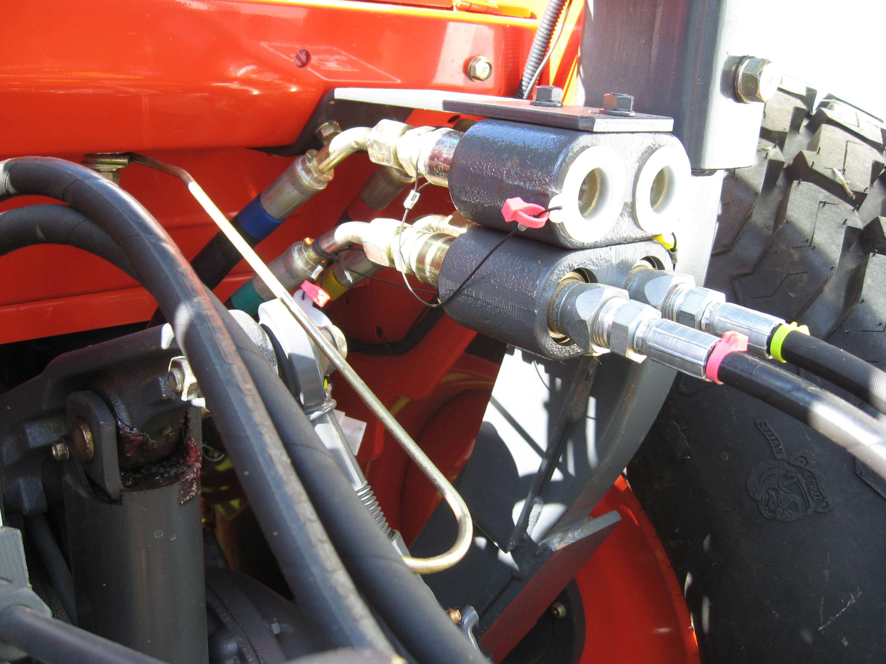

I got my tractor with one remote installed to operate a hydraulic top link. I shortly added a second remote to control the angle on my rear grader blade. Now I would like to get a box blade with hydraulic operated rippers. Philip.

Thanks Spy and Philp.. I see know where the lever goes.. Gee nothing in those slots on tractor:confused: This is NOW making more sense to me... With the standard remote is the top link locked in place and the implement doesnt jump up? The Kubota site says standard and FD which one would you want for the top link?

FD may be "float detent". If so, this is a detented position where the valve will allow fluid to move back and forth without resistance. So, a cyl fed by a valve in this position would be free to move in and out. This can be useful with a toplink, tiltlink, etc. It is possible that your remote valve has this 4th position built in: #1 centered - OFF [all ports blocked], #2 pushed forward - ON ..out port A, back B, #3 pulled back -ON .. out B, back A, #4 fullly forward .. a position where the leverstays until returned .. allowing float.

Both of my remotes are standard, I believe the term is open center. When the valve is in the middle position, the cylinder is in a locked position. In my opinion, this would be best for a top link. Philip.
/ Kubota Hydraulic rear remotes #19
The term is tandem center, a form of closed center valve that routes the pressure supply back to the reservoir when in the centered position while at the same time blocking the work ports to lock a cyl. An open center type would not lock the cyl when centered because it connects all ports together when centered.

I like the float detent valve on the top link it allows me to float the box blade so I get a smoother job and when I am running the rotary cutter I will float it and it allows the mower to follow the contour of the ground and ride up and down wit the tractor. The side link I would use a standard valve. the float detent will do both jobs.
