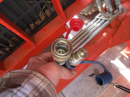

Hello,
I have a new to me L48 that came with a 3rd function valve to operate other attachments. I want to add a grapple and need to know the part number or what to get to connect to the existing couplers (SEE IMAGE).
Question #2...would I be better off changing to a more universal QC and not use Kubota's proprietory connections? IMG_0008web.jpg
/ Kubota Hydraulic Coupler HELP #2
There is probably nothing proprietary about that connector. You should be able to find a part number on it, or take the female end to a hydraulic hose shop and they will match it up to the appropriate male end to use.
/ Kubota Hydraulic Coupler HELP #3
retake the pic w/ a measuring stick across the face so we can be sure if it's 1/2 or 3/4.
/ Kubota Hydraulic Coupler HELP #5
I am 99& sure they are ISO 7241 "B" type, probably 3/8 " but we need measurements to be sure. We have some in stock.

I found markings on the fittings...they are Snap Tite 72XX and the pipe thread is 3/8"
The chart sent by Wild Bill indicates a ISO 7241-1 Series B700 Series Hydraulic which would make kennyd correct in his assumption.
Thanks to all......
