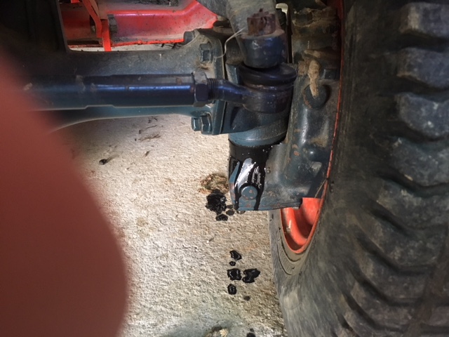

Got a new front end issue, leaking at the bottom where the axle and knuckle meet. Seal, o ring, etc? Hoping someone who has been there before can weigh in. What痴 involved in tearing it down to repair?

Order seals, o rings and get good snap ring pliers.
/ Kubota has a leak #3
G'day easy job to do the seal also check if your diff has a breather fitted some did not and it pressurizes the system and causes a leak in hot weather I havr drilled and fitted the little button breathers to a few
