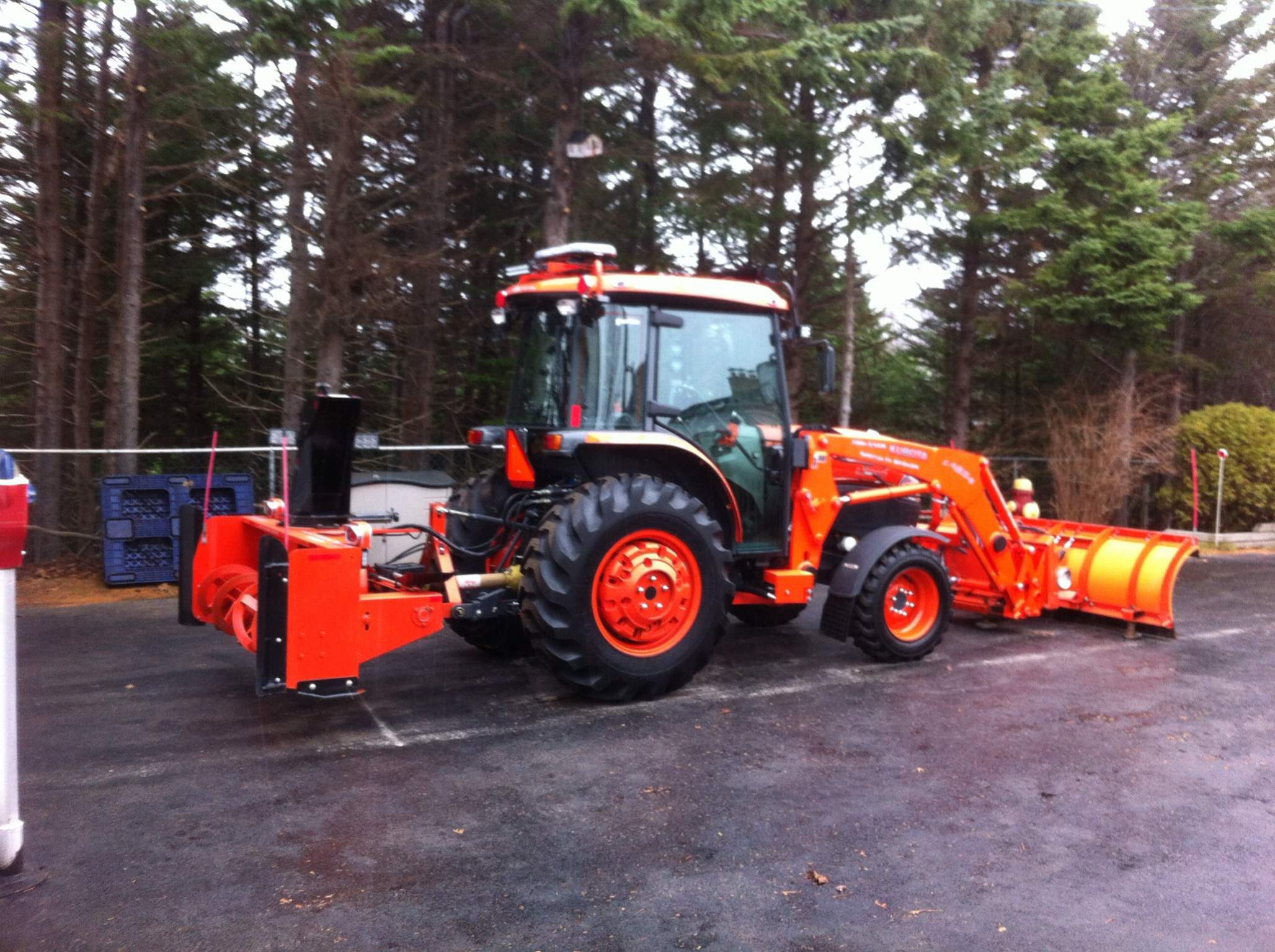

Thats made by 4shorts (Paul) on this forum. Look under Snow Removal forum for more. I more or less copied his design, and several others on here have done similar setups keeping the blade close in. I have a thread on the snow forum on my build.

Yep. That's our tractor. The blade you see on it started its life as a Canadian built Arctic poly blade back in 1994. It was used on my GMC truck for 13 years then I purchased a Kubota GL4240 in 2008 and decided to convert the blade to fit the tractor. My main goal was to keep it close to the FEL which I did and its worked flawlessly since.
In 2011 I bought a GL5740 and the blade is on it now as you can see in the picture you supplied the link to.
I've made this blade fit my every need. It has rear skids and last year I added a front shock to absorb the shock when the blade trips on the trip springs. Yesterday was its first trip out for the season. The tractor has 73 hours on it now. Nice to be in the seat again :)
Here's a link to the original build to give you an idea of how it's done.
http://www.tractorbynet.com/forums/customization/131136-snow-plow-adapted-fel.html
Some updated plow photos in this link:
http://www.tractorbynet.com/forums/snow-removal/256183-arctic-poly-skin.html
Photo taken yesterday just before the snow fell. Taken with iPhone :eek:
If you decide you'd like to add a few mods to your 5740 I've added a list that I've done to ours to give you a few ideas :D
Note: All of these mods that are listed here have threads on this site showing them. If you see anything you like just search for threads started by "4shorts" and you'll find them all.

- Added a shock to the front snow blade to eliminate blade recoil after hitting obstacle.

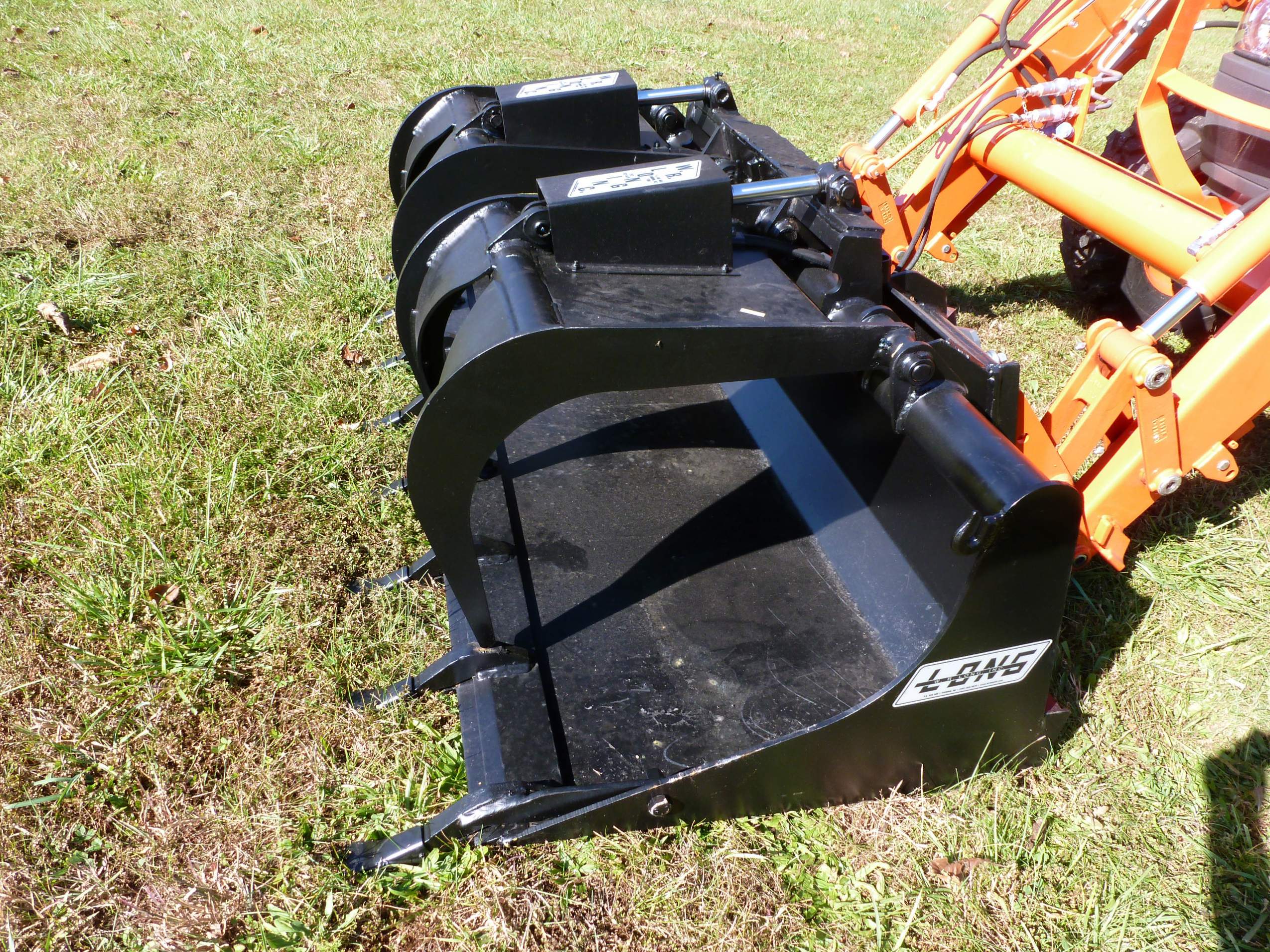

My tooth bar comes off with just two bolts, once I'm done with my wood collecting, which frankly I'll never be, I can try out the bucket by itself, but probably only to clean up after someone else has plowed;
having neither skid plates nor a trip mechanism, I think I could do some damage pretty quickly. And the shape of the bucket seems all wrong for snow.

Thanks Drew. Doing that stack was exhausting work :laughing: Glad I did it though and that coffee mug holder is in the right position plus the mug I'm using is spill proof and keeps the liquid hot for 1.5 -2 hours. Love it ;)
Here are the links to those threads if your interested in doing something like it.
