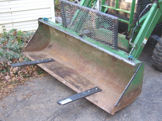

My hooks with a guard to prevent objects coming to sit on my lap. :D
Next year the paint will arrive.:D

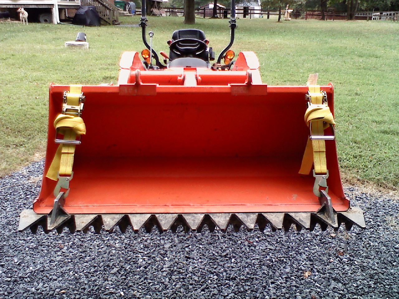

Here are mine, and they work very well:

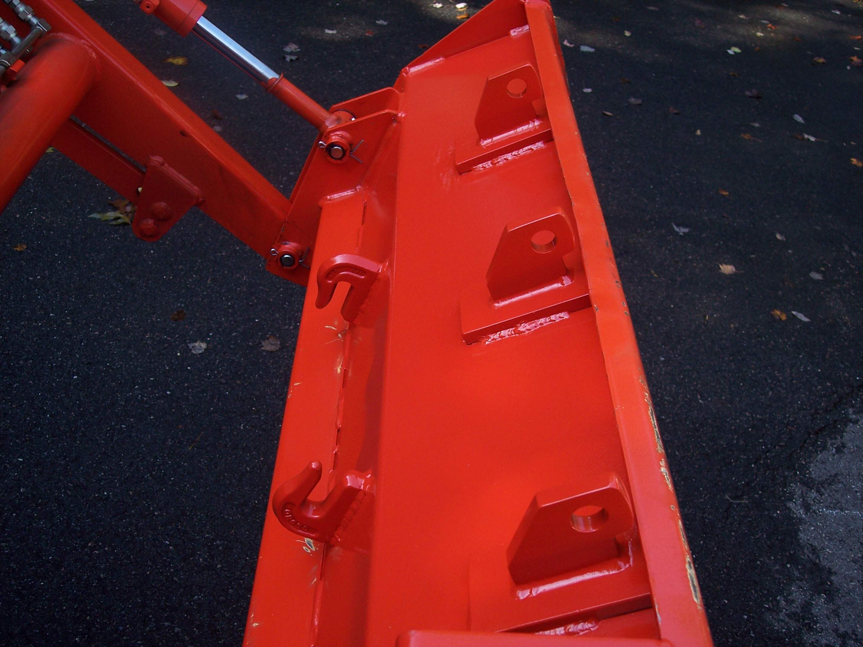

Home made hooks on top of the FEL, store bought 3/8" grab hooks on back.

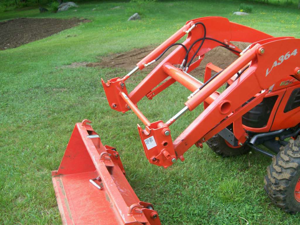

Here are my grab hooks from BXpanded. They can be removed or repositioned in seconds. Not sure if they fit on other models besides the BX models, maybe Harry can chime in if he knows if they will fit on other FEL's.
