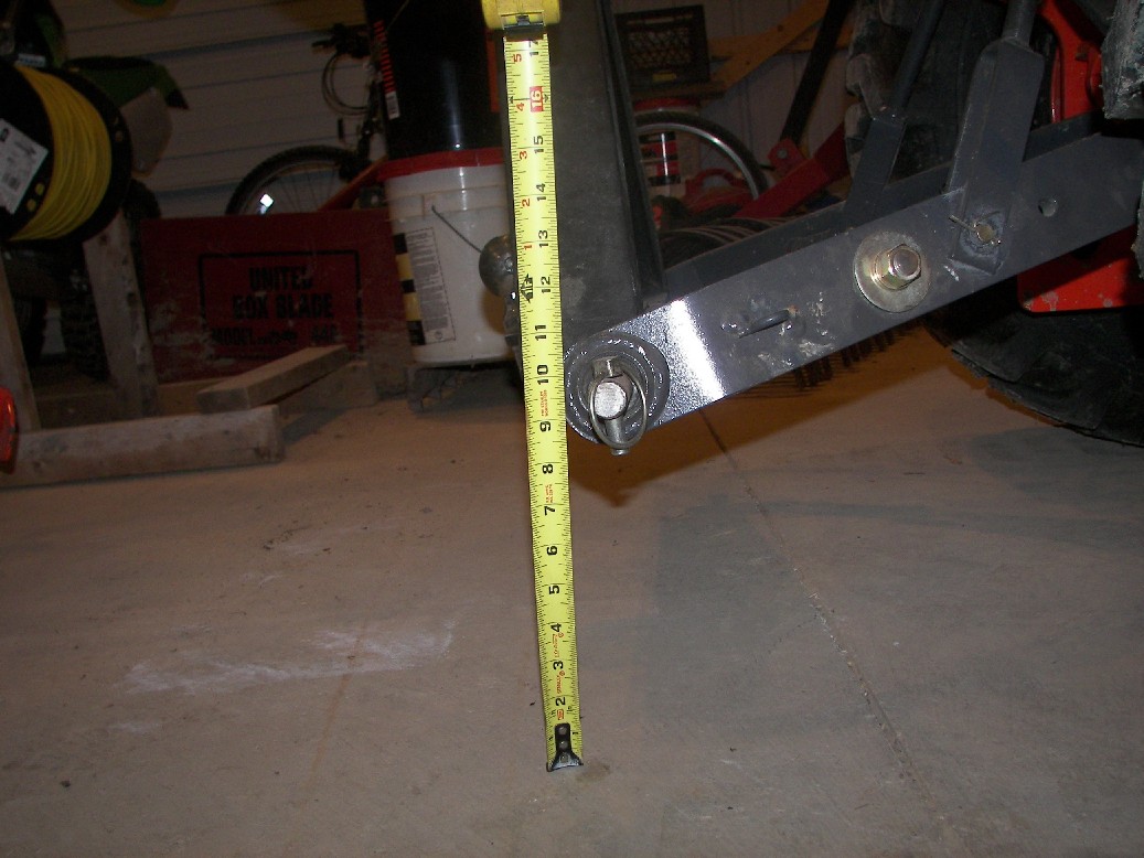

I know this is kind of strange but trying to find out if it is a tractor problem or if I have to chage the brackets that the tph pins mount to. Thanks
   / Kubota/farm King finish mower problem #12
From looking at the pictures, it looks like you could move the connecting links to the other set of holes closer to the tractor (see pic) and I would guess that would lower the arms enough to solve your problem. However, I believe the connecting links are in the standard position, which usually works for most implements. I have used a lot of attachments and never had to move the connecting links on the 3pt arms. Have you checked the stop limit on the lift arm? Has the mower been modified? Was it originally made for a 3pt attachment?

Look at this measurement and see if is the same as other Kubotas. Thanks

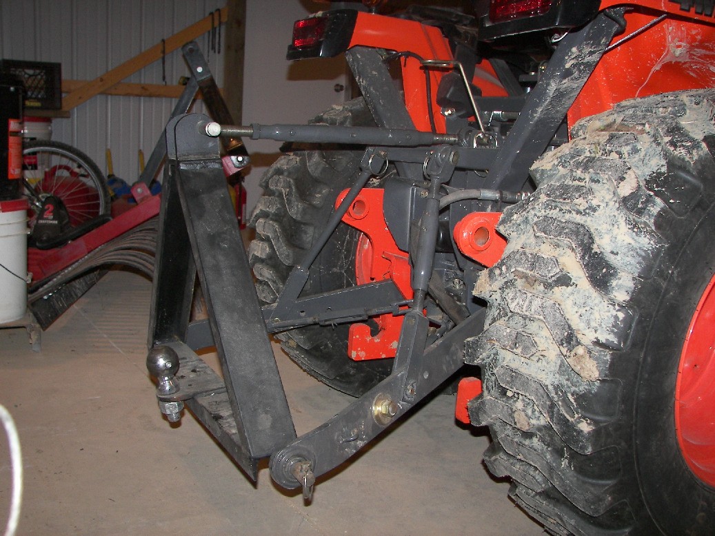

redvetteharley,
Your tractor 3pt looks pretty normal to me. I attached a couple pics of my B2620 for comparison. They look fairly similar to me. The lifting arms come out just about level and look similar to yours. The pics show my 3pt as low as it can physically go (without moving the connecting link to the other holes). This is about as much as I can do for you. I have never used a RFM, so maybe somebody who uses one can help you more.

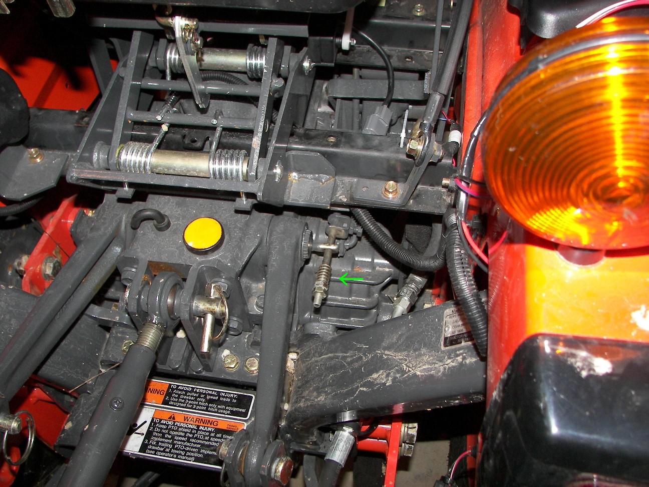

I still say your problem is an adjustment here. Have you tried this?
