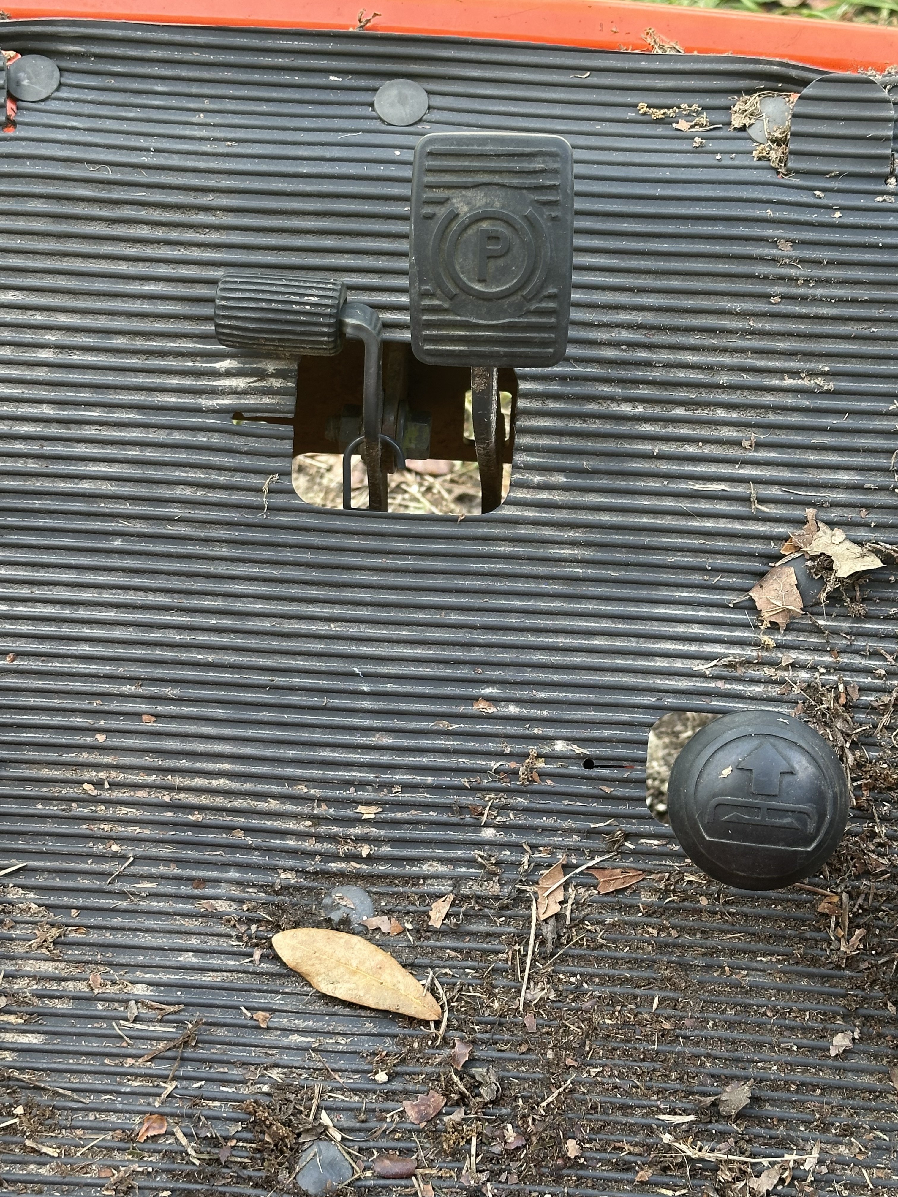

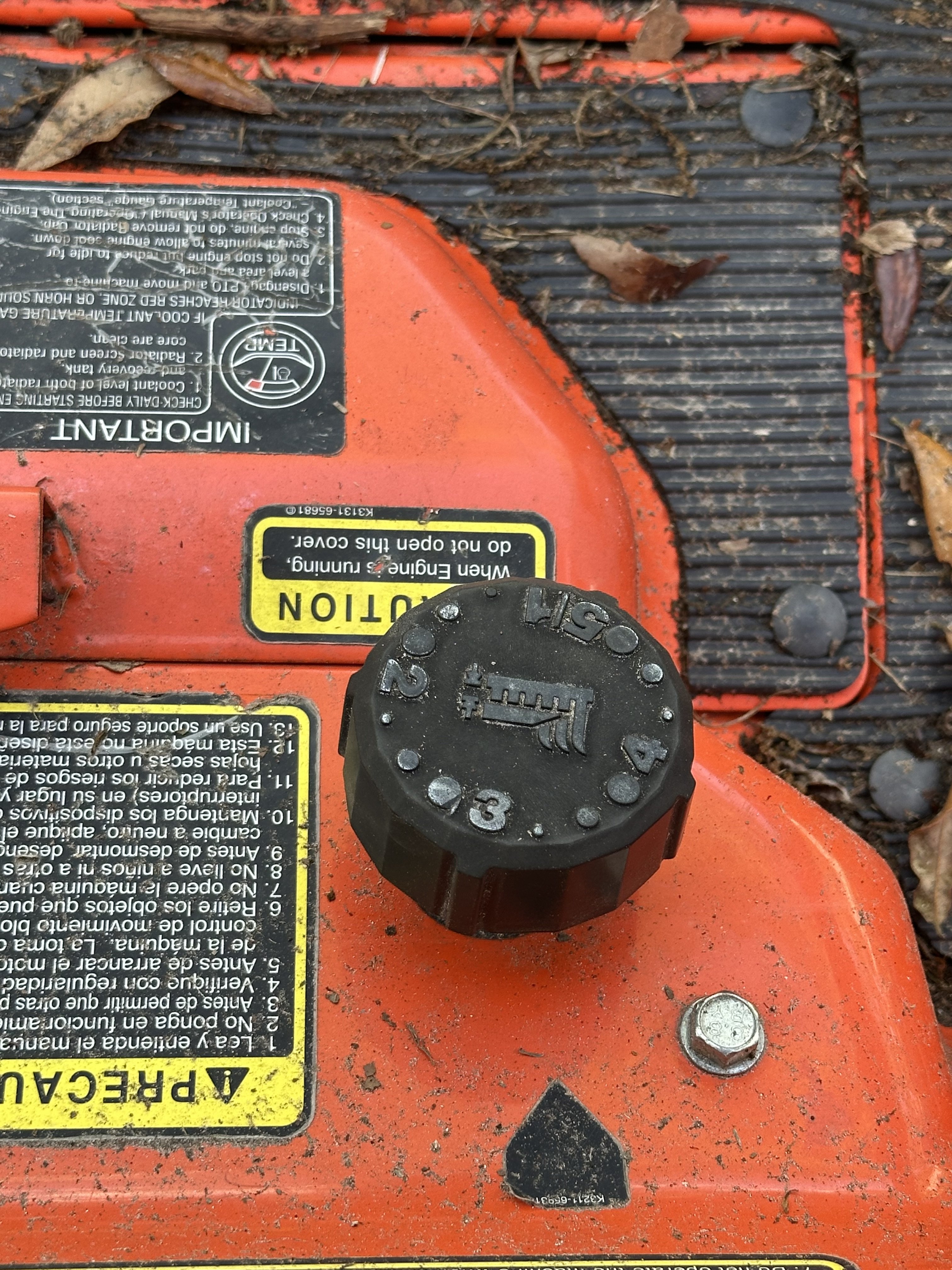

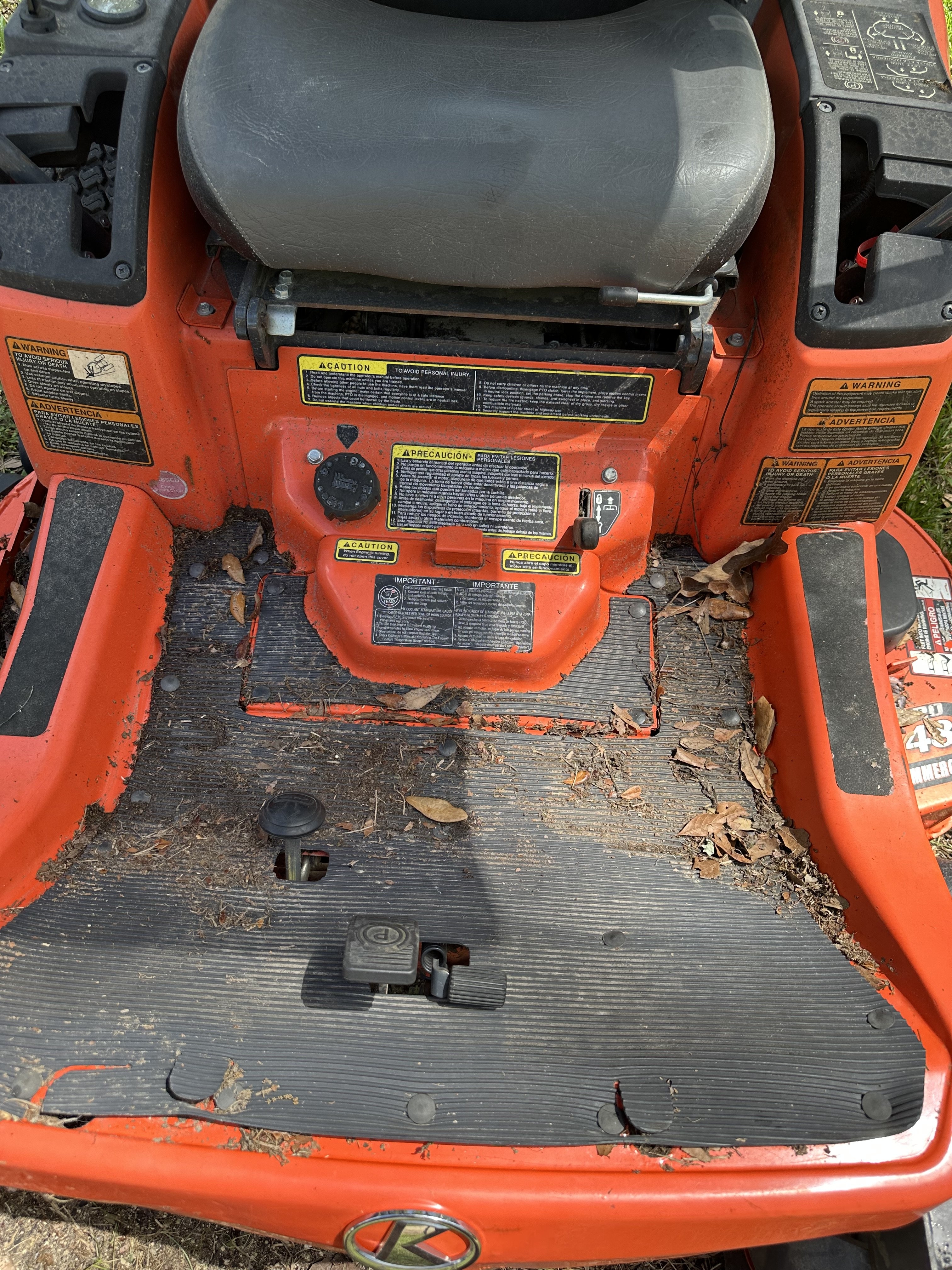

It appears the height adjustment knob must be removed…
I don’t see any pin to pull to remove it.
The other picture shows the brake lockout which I’m guessing has to come off as well.
I’m trying to get floor pan off to access a safety switch that is cranky on the left frame rail. I have the darn switch, just can get to it.
The symptom I’m fixing is this:
Unless I pump the lockout brake many times and get the switch just right it won’t start.
