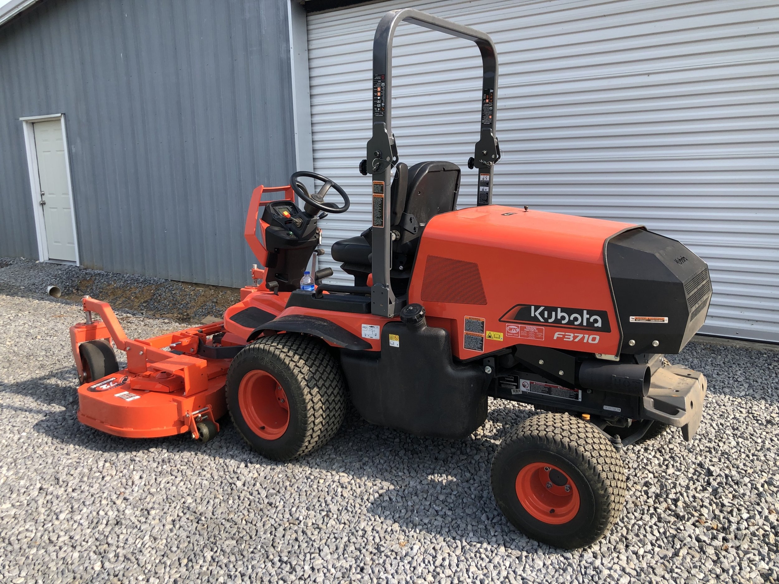

2024 F3710 72 SD deck 9.5hrs
$27,500 Firm in North Georgia if someone is looking.
