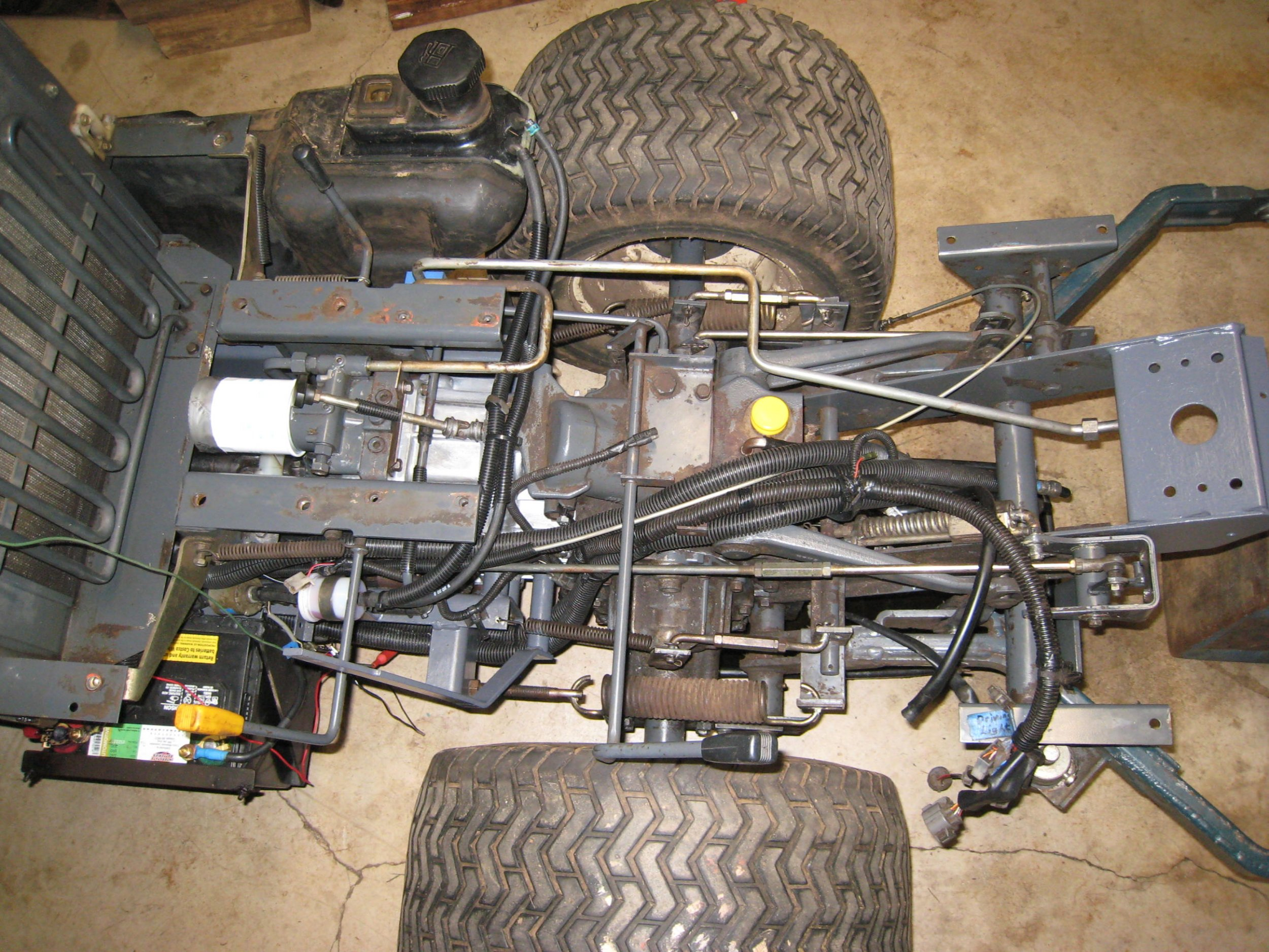

Here is what the F3060 front axle looks like under the fender and I am glad mine does not have all-wheel steering!
Cheers

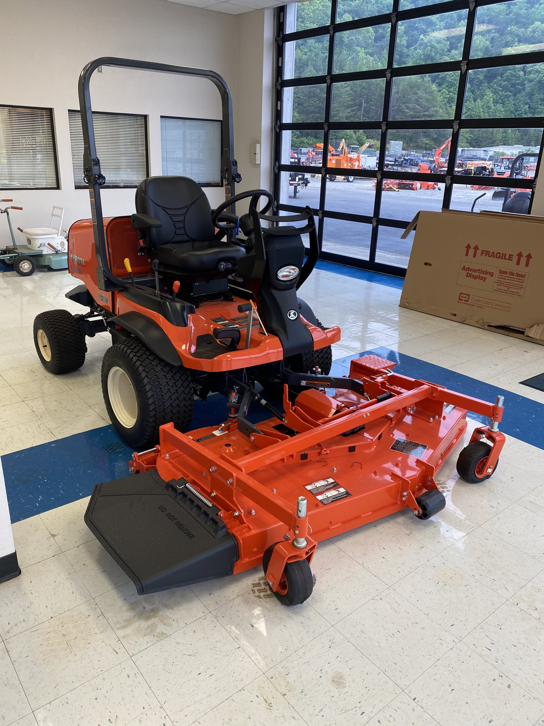

I found a new F3990 72” SD BUT I’m afraid the deck running on the ground would take too much abuse here on my rough farm ground.
the frt deck tires are too small imo
the ZD deck hangs from the frame letting the mower itself take the abuse from rough ground.

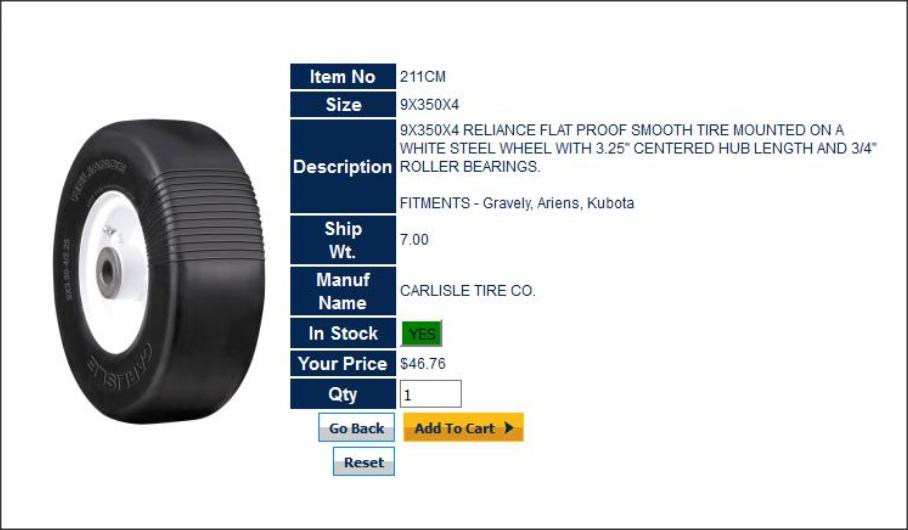

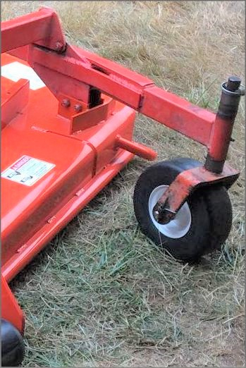

Mine uses these 9 inch outside diameter front gauge wheels & 3/4 inch smooth axle shown below and they are perfectly good for my yard.
At least in a front deck model mowers these are carrying only about half of the deck weight, unlike in Z mowers where they carry lot more than that since that's all they have in the front.
Yes I agree they are often bigger in diameter but I'm not sure how big.
If you are mowing areas with stump holes, maybe a tractor & flail mower would be more suitable for that area (that's what I do)?
