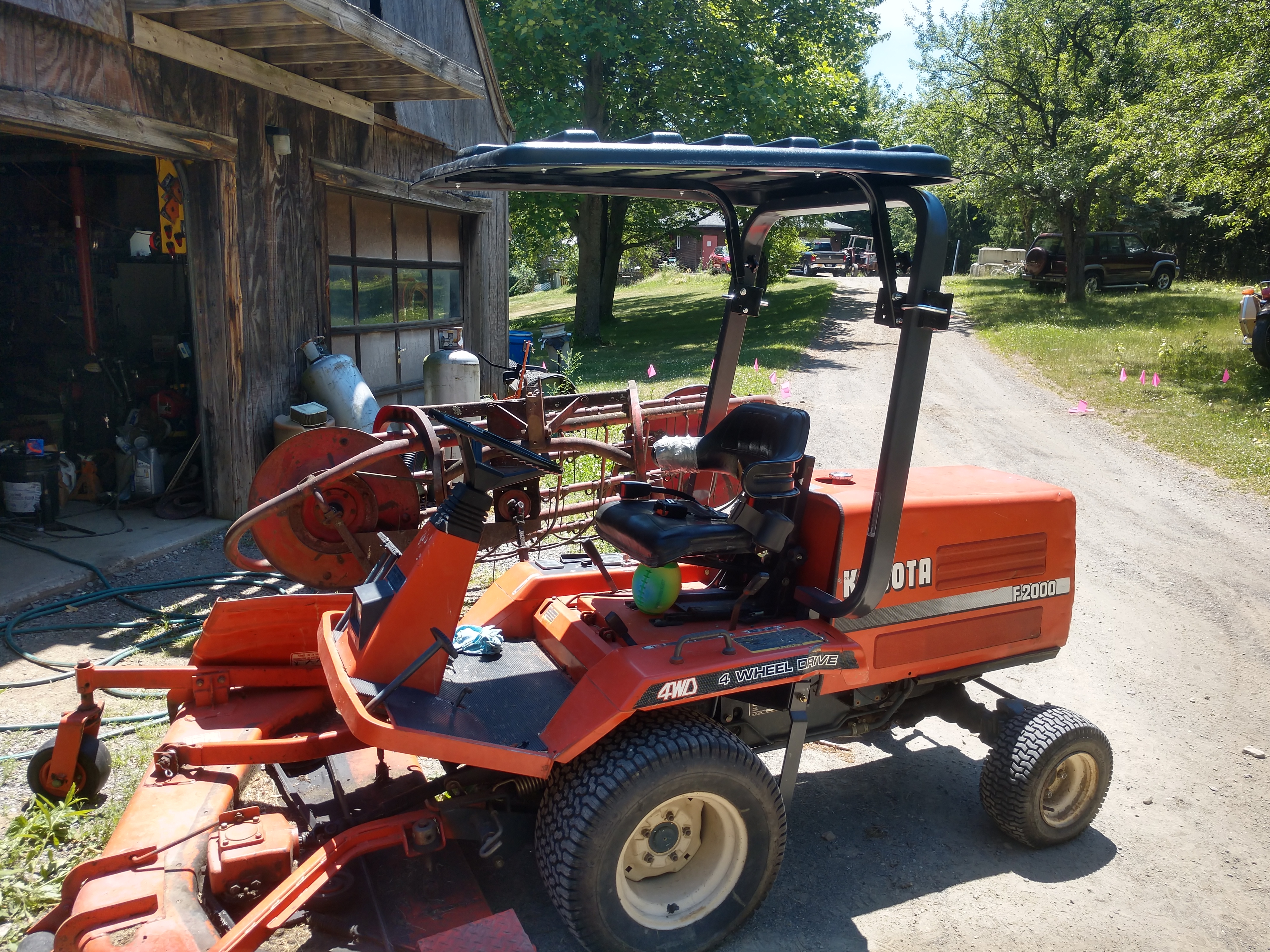

I'm well pleased with my old F2000 that I purchased well used. It still mows well and the 4wd will walk it up most slopes and also mow sideways on them.
The steepest that I mow is about 26-28 degrees, mine only has a grab handle on one side I keep thinking about adding one to the other side,
for now I just lean over and grab under the fender. rhinohide canopyleft side .jpg

Any trouble in tall or thick grass ?
Not tippy sideways on steep slope?
   / Kubota F series #299
I have a 72"side discharge deck, in tall or heavy grass it will leave a windrow at times,
Mine I can't find the gator mulching blades so it does leave a visible residue at times.
The mower seems to be more comfortable on slopes then I am,
I added the rops when I bought it as it seemed to have no issue traversing side slopes that I have a bit of a pucker factor with.
I tend to run in 2wd when side hilling as I would expect the uphill tire to warn me a bit by spinning..
I mow at a low speed quite often as I am on rough ground with rocks and lots of tree roots that are half out of the ground.

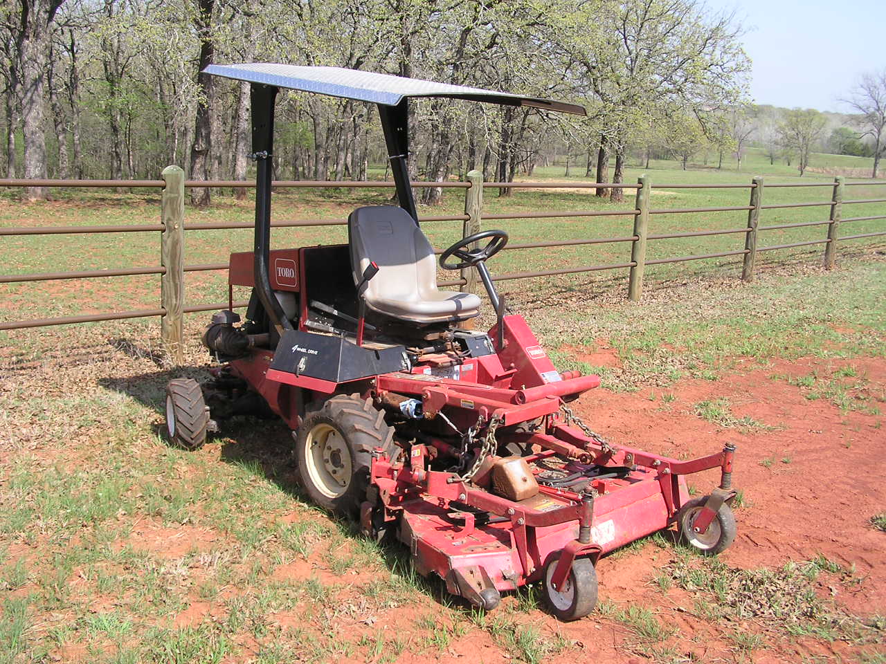

There are several front deck mower brands, and I recommend four wheel drive.
Mine is a Toro 328D with a tractor canopy that I added 5 years ago:
