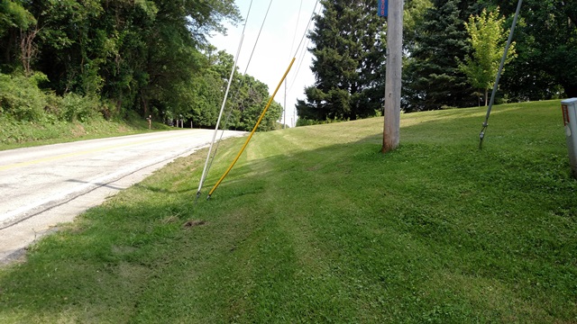

Mowing around the house is pretty easy. Out front there is a decent little hill that runs alongside the road, which I mow along with my Grasshopper (with Chevron tires). She crab walks but she gets it done. If I think it's the slightest bit wet, I don't mow it since I'm right alongside the road. Here is a picture: 1.jpg
Right now I do not mow that section up and down, as when they put drainage along the road and my lawn, there is an asphalt "lip" which the deck would hit. (The ZD326 I demo'ed went up and down just fine, especially with the hydraulic lift deck). Not sure how I would mow this with the F? Since the F deck doesn't rise, I would think I'd have to mow alongside the road? But then I have issues with the electric pole and guide wires. (I mow between these now as my Grasshopper doesn't have a ROPS). I'd have to stop. Turn 90 degrees and head uphill? Might be an issue.

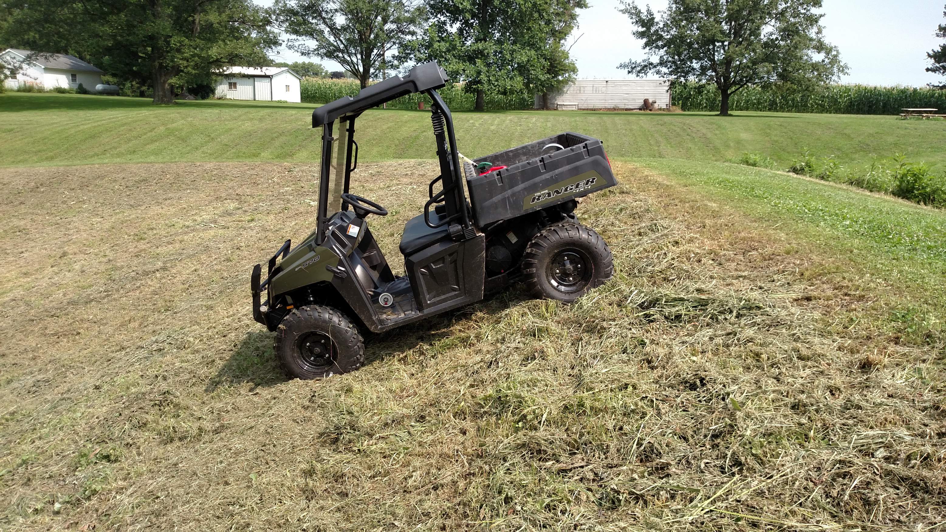

I took a few pictures with my Polaris Ranger and put an angle meter on the floor boards, I figured this should get it fairly close.

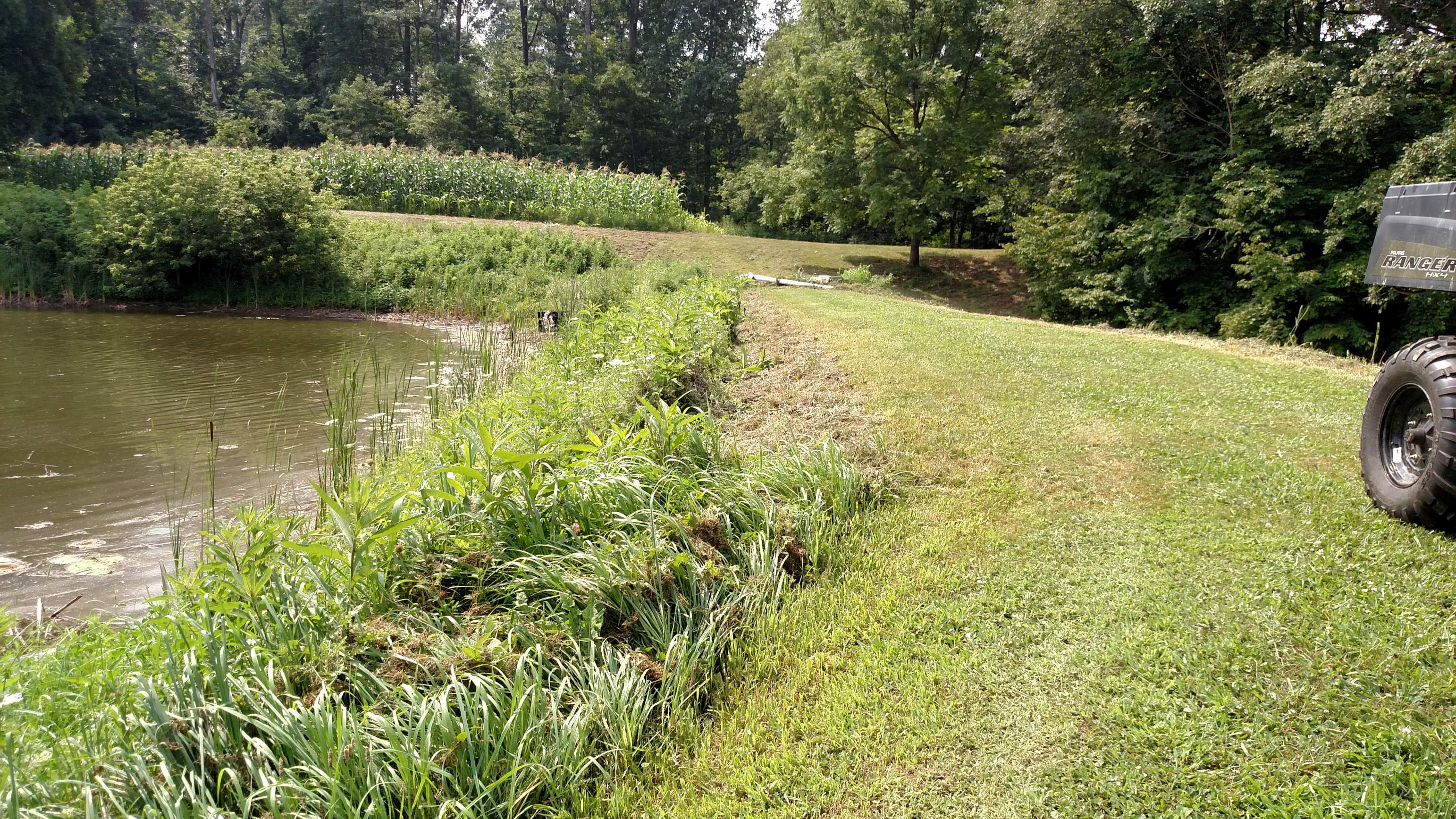

This is the "easy" bank.
I either back the Kubota with the mower to the water, or very carefully do it with the Grasshopper. Just in a few spots since I'm not real comfortable at the moment doing either. I have sandy soil, so I don't want to go a sliding.
This bank shot read 18 degrees.

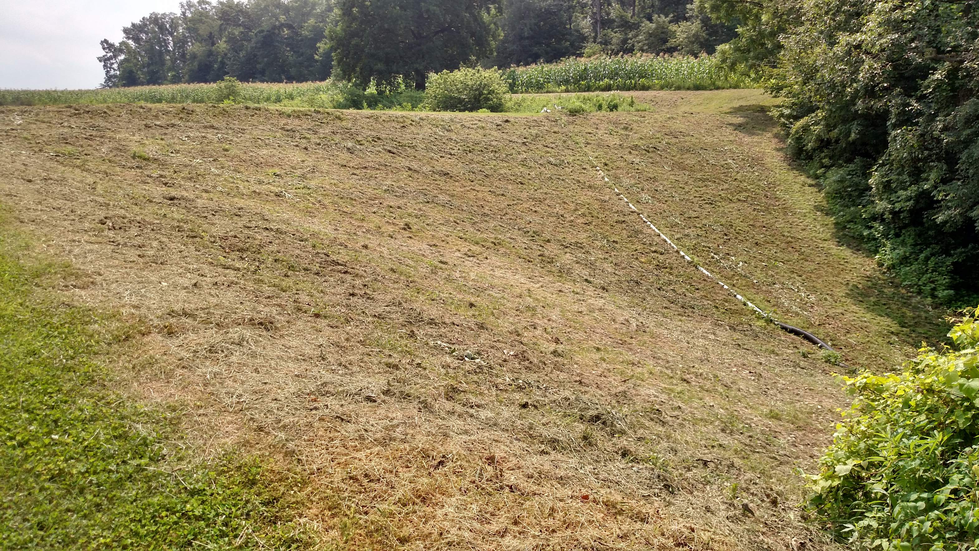

Now the fun part. Here are a few shots of the dam:3.jpg4.jpg5.jpg
The steepest point of the dam measures at 25 degrees. The bottom of the dam there isn稚 much of a level surface and it drops off into a small stream. I was able to mow this with the B3200, however if the dirt was damp, she would spin because I think she was trying to pull the Woods mower and didn稚 add weight to the rear tires. We mowed this up and down. We found it easier to mow down hill and then drive back up and around, then back down again. This is where I think the Turf Tires might not be good enough on the F Series.
I do not think I can mow this side to side since this is more 澱owl shaped and that would mean at certain spots, the mower could have the wheels on different angles as it travels across the curved section. I think this could big a slide point.
